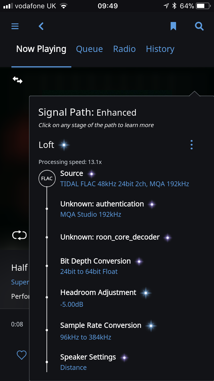

Seem to be having a couple of issues though.
The signal path for an MQA track is incomplete and is showing ‘unknown’ for both authentication and decoder.
My core a QNAP TVs-471
This behaviour is the same in 2 zones.
One a chord 2qute directly connected to the core via USB and the second an Ethernet connected sotm sms200 into kef LS50 wireless by usb.

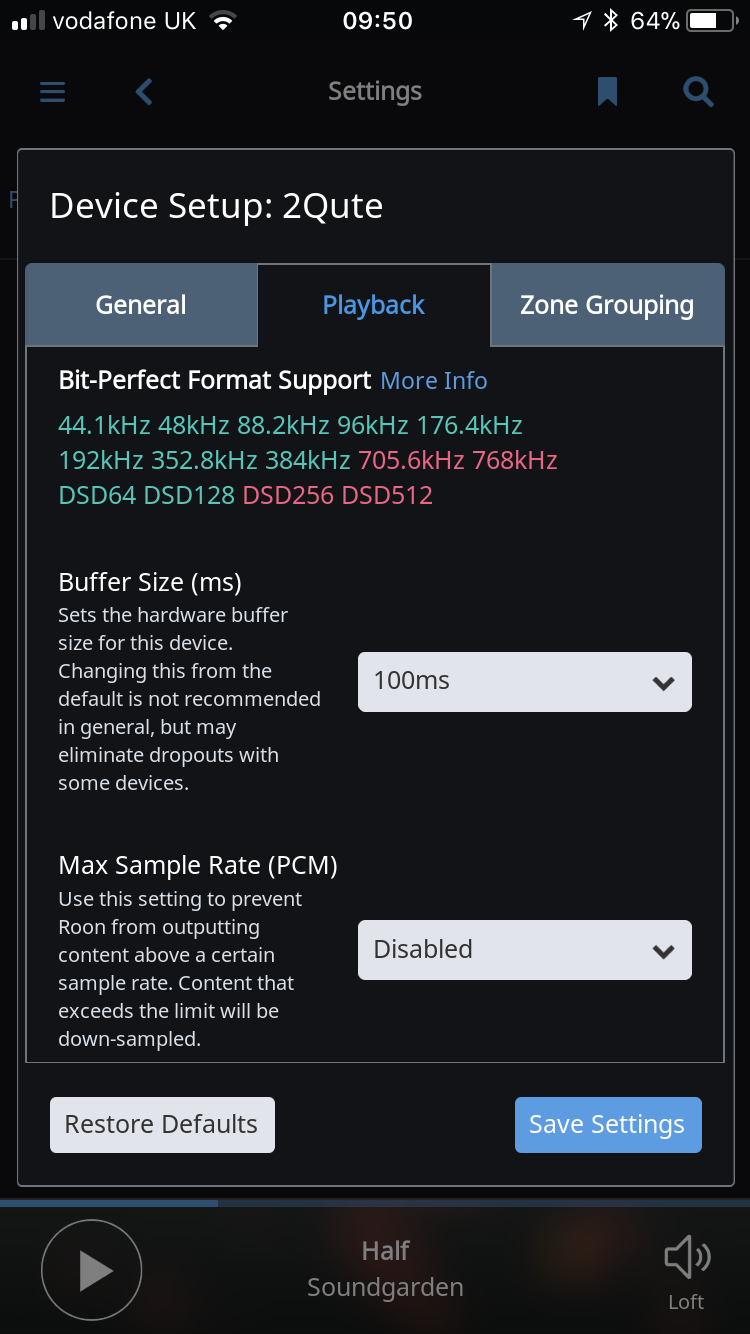

In addition I am not see the advanced options in the device setup screen to view the various new parameters around MQA.
Am using an iPad to view as it’s a headless core obviously.
Am I getting the Roon MQA decode and these are just minor visual details going awry?
Struggling to see why I’m not getting all other options others are highlighting within the device setup screen.
Thanks let me know if you require anything further

Hi Scott,
Upgrade your phone app to 1.5.
Thanks Andy absolutely right I missed the obvious for the setup screen. I’ll await Apple approval for 1.5
I assume that will not address the signal path/ recognition issue for MQA.

Hi @Scott_Fletcher — Thanks for the report! Your feedback is appreciated.
It appears that you may need to update your iPad remote device to version 1.5. With this update, I believe you should see the observed behavior of seeing “Unknown” go away.
-Dylan
Thanks Dylan I was expecting a more complicated cause of the signal path issue …1.5 was not available earlier for the IOS device but is now in place and both issues gone.

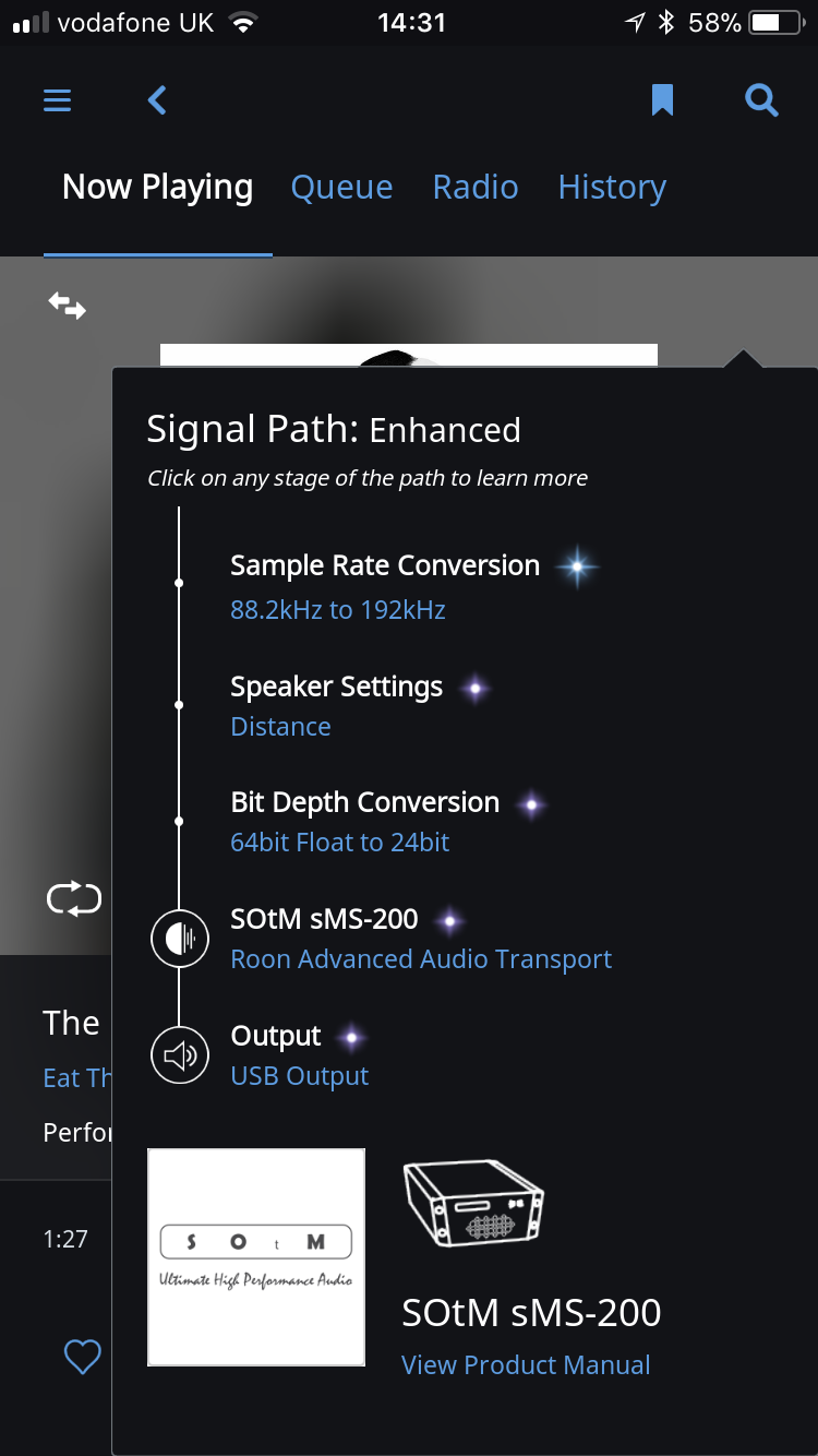

Quick observation.
Signal path used to show the LEF LS50 wireless sitting behind the sotm sms-200. Now it does not. Not an experience altering issue but thought I would mention.
