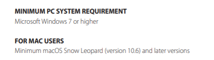

I took a look at the D3045’s manual, and I notice that Windows and macOS are mentioned, but I don’t see anything about Linux support:
This device might not be fully compatible with Linux, which is why you’d have that problem with a Pi and not Windows. I’d reach out to NAD and ask if they can clarify whether or not Linux is fully supported and if this should work.
