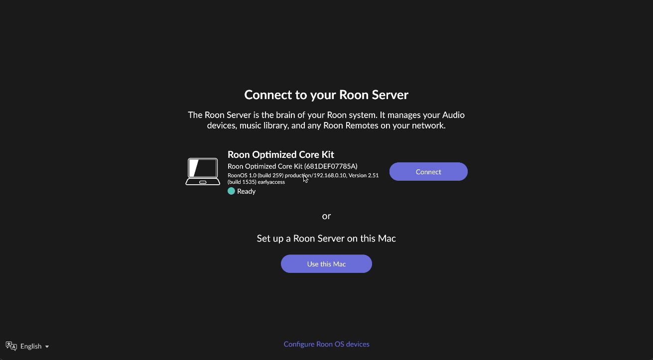

Thanks. I assume I need to contact Roon somehow about transferring my lifetime subscription to the new Nucleus and I just move my SSD from the old box to the new box (assuming the SSD is functioning properly, of course).
No need to contact Roon for the license. You just install the Nucleus One and when you access the first time from Roon Remote, you will see both cores available to login to. Just select the Nucleus One and login with your Roon credentials.
Also if you happen to have a Mac computer, you can also use it as the core to get you up and running while waiting for the Nucleus One
Thanks. No Mac computer, just PC’s and iPads.
No, this isn’t necessary, and if you use the Restore a backup link when first connecting to the One, you won’t need to login to restore your settings.
