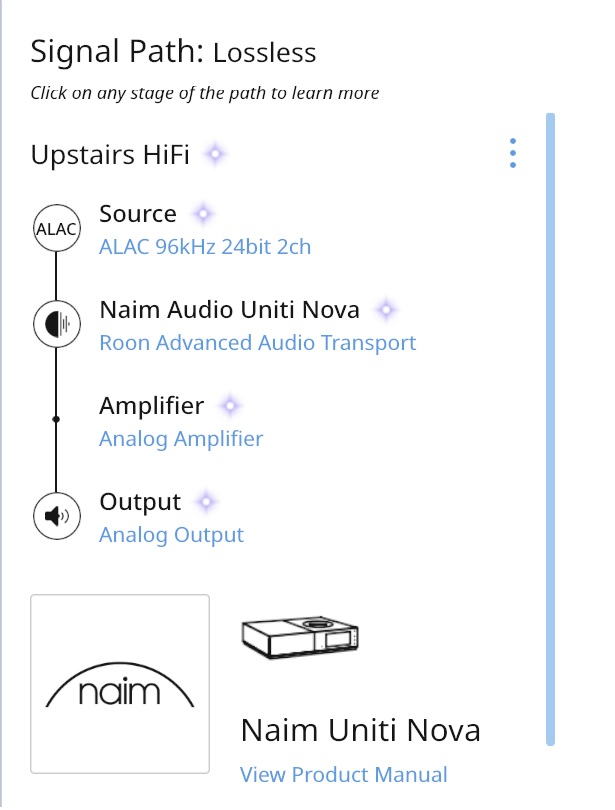

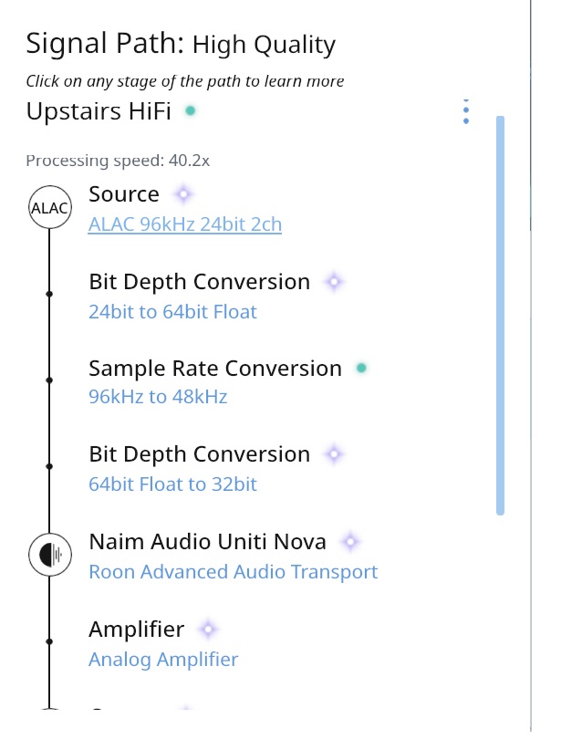

What does the Signal Path look like when you attempt to play the ALACs? Could you capture a screenshot before the stream ends and post it here?
Hi, thanks for reply
When I play this file ( and other 24/96 ALAC ) on other zones ( google speakers ) it automatically downsamples and plays ok
When I set the the max sample rate for the Nova in Roon to 48kHz it also plays ok ( attached success.jpg )
When I set max sample rate for Nova in Roon to 384kHz ( so no forced downsampling ) it fails ( attached failed.jpg )

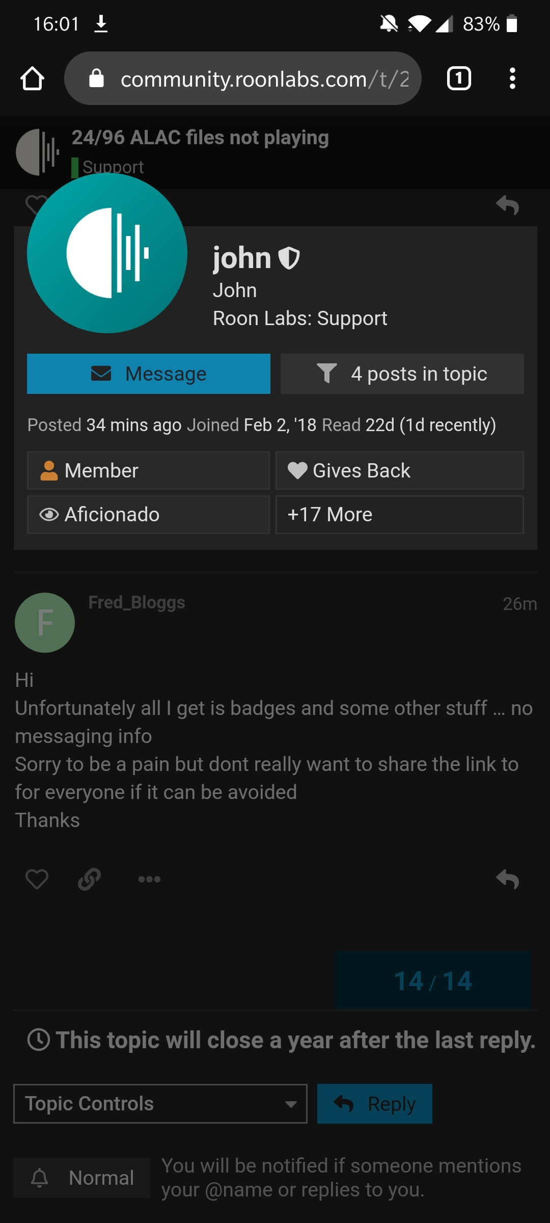

Hi
Unfortunately all I get is badges and some other stuff … no messaging info
Sorry to be a pain but dont really want to share the link to for everyone if it can be avoided
Thanks
It looks like below. The blue message button.
Hi ged
Thanks for your help
Bizarrely I had been doing that and no message option
Just tried it again …and there it was :open_mouth:
Cheers
