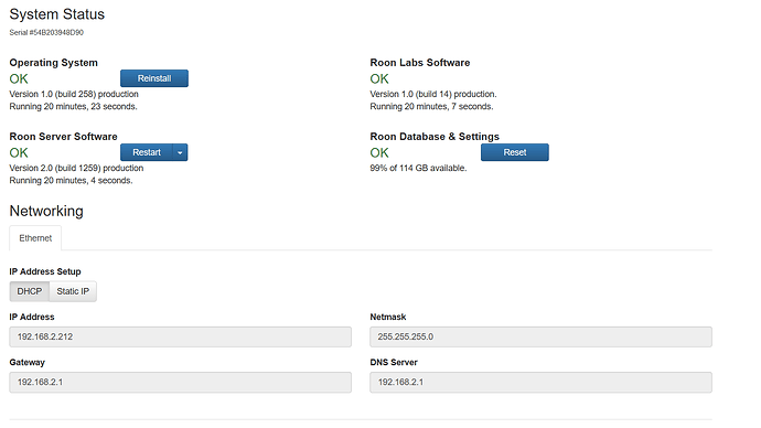

There seems to be no rhyme or reason but after toggling the ā€˜Operating System- Reinstall’, ā€˜Roon Server Software- Restart’ , ā€˜Roon Database & Setting- Reset’ and the Power-Reboot’ multiple time, I ā€˜find’ the storage again.

Yes- I removed the originally installed HDD and replaced it with the WD SDD which was then formatted using Roon’s Interface. I have even reformatted the SSD on two occasions (and transferred the music back onto the drive), hoping this would solve the problem.
