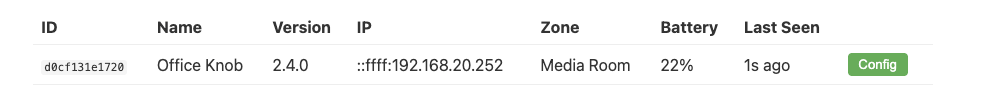

The issue is that the “Battery” indicator on the bridge UI shows 100% whenever the device is charging. So here’s the same knob plugged in and not plugged in.

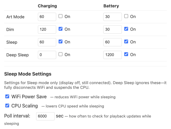

The next thing is a question and/or a bug report. Here’s a picture of my current settings. I’m not sure these are being respected correctly.
My understanding is that “Art Mode” is the state in which text and controls disappear from the UI. My interpretation of the settings UI is that with my current settings, my knob should never enter Art Mode. But it does. It does so in both charging and battery modes. Or maybe what I’m seeing is that “Dim” is also “Art Mode” so that when it goes into the dim state, the text and controls also disappear.
Either way, I’m not sure that’s working correctly, and it also may be that the timers are always respecting the charging times even if the device is on battery. I’m just not sure. Trying to figure it out. Have you been able to test and confirm that all of this actually does work exactly as intended?
I think the UX on this is terrible, I acknowledge. It’s not clear what happens when. I get confused by it during normal use.
As for testing, I can only see logs when charging (I haven’t figured out serial port sans charging). There, I’ve cranked down the times and seen expected times for the charging mode options.
You are correct, I haven’t implemented a Dim mode that isn’t art mode. Again, super confusing config settings.

It’s not terrible. I’m just trying to understand it.
I get it now and (with limited testing) I believe it is respecting the settings for transitions when on battery.
I’m wondering a bit about the “Sleep Mode” settings of “WiFi Power Save” and “CPU Scaling”. I’m curious how much impact WiFi Power Save has on battery life and whether it’s an option to run in that mode all the time. I’m also wondering about CPU scaling and whether that’s generally applicable, too.

If it takes me time to understand I consider it terrible. :wink:
If you’re up to it, would love your take on how to communicate what the settings do better so I can update the bridge.

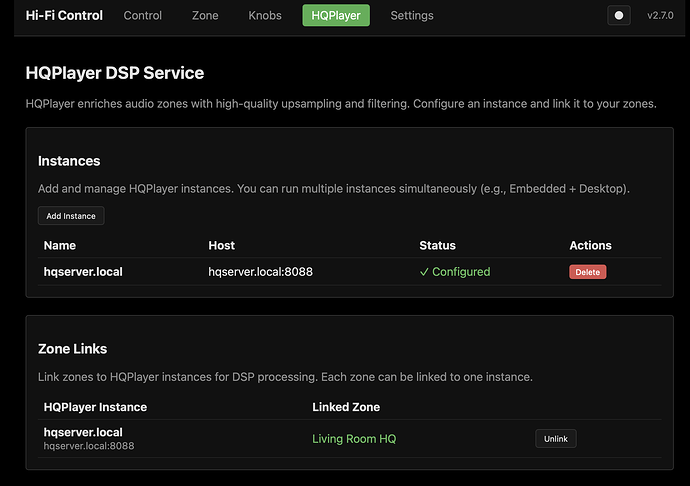

Hi, still not showing up on my system.
Do you have the web UI credentials set up? I may have a bug that when they’re not set I am not sending the right data. Thanks for checking!
You are referring to HQP Web access I assume? I think I am using my own user on the server, not the default hqplayer/password account.(can’t remember why to be honest).
I’ll try disabling username/password to see if I can reproduce the issue locally.
Just refreshed and I see them now. Not sure why it took so long.
