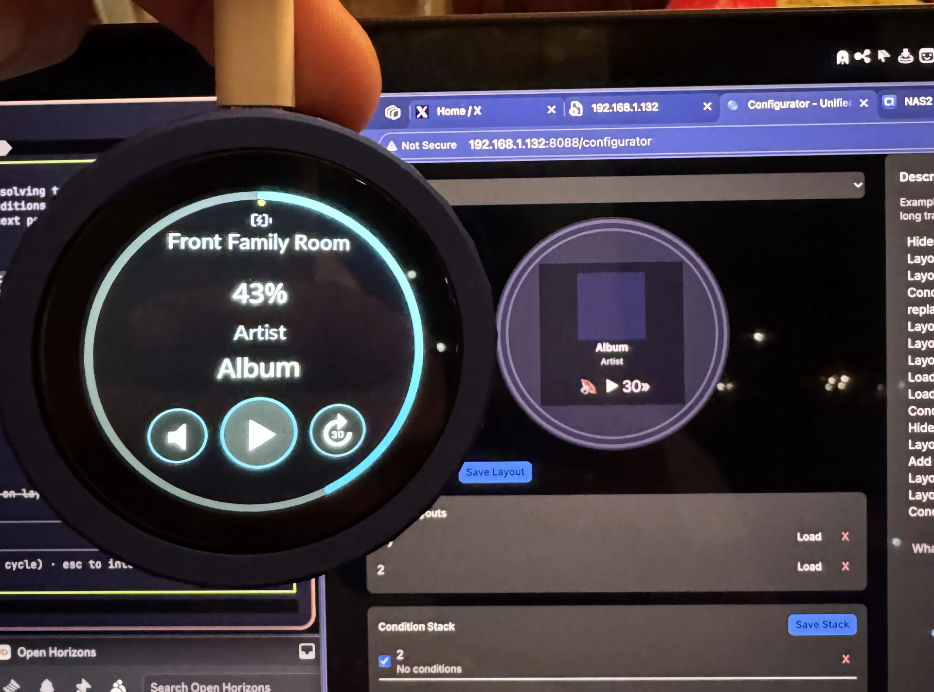

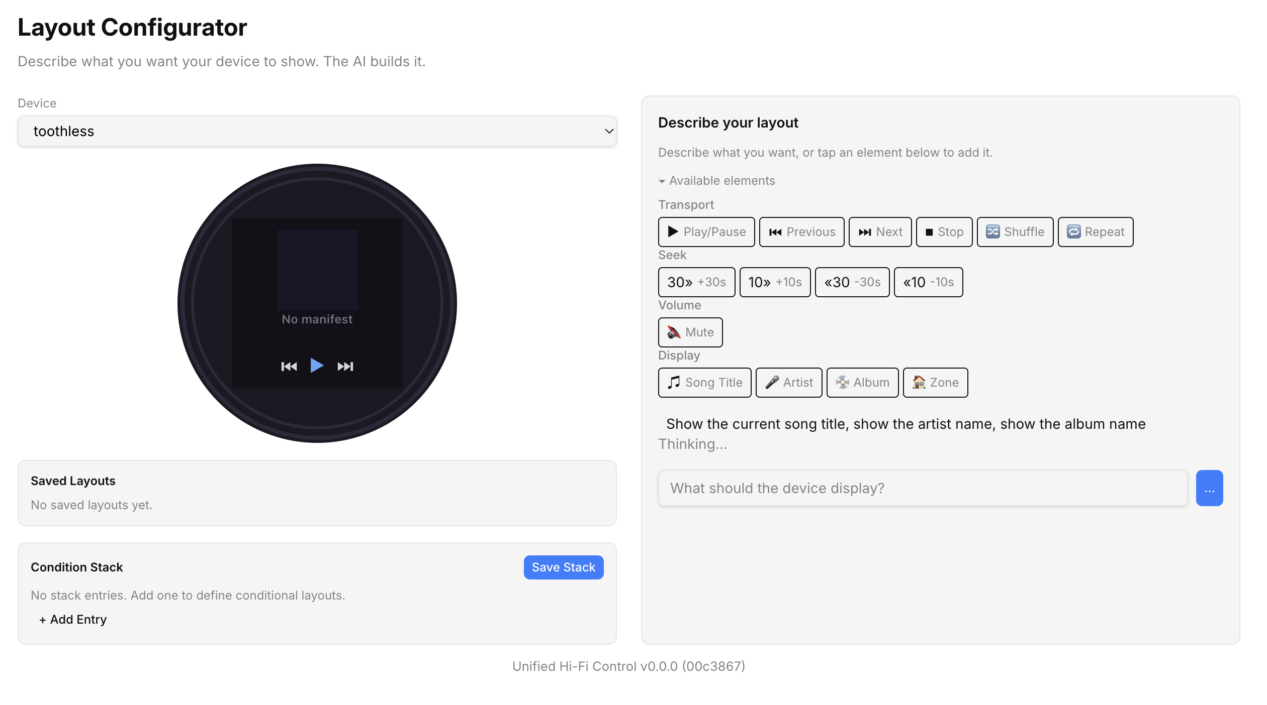

On a different note, I have the experimental firmware, fully configurable, at runtime like so. Some dev screenshots:
The idea is that for different zones/artists/(other rules here) you use a chat interface to build the interface you want, and the knob transforms automatically to match the rules you’ve put in place. And yes, the vol indicator and rings (width, presence, colors) are all configurable too. :wink:
No ETA, am exploring usability paths for this radically different interface paradigm. Anyone interested in Alpha testing?
