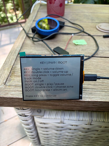

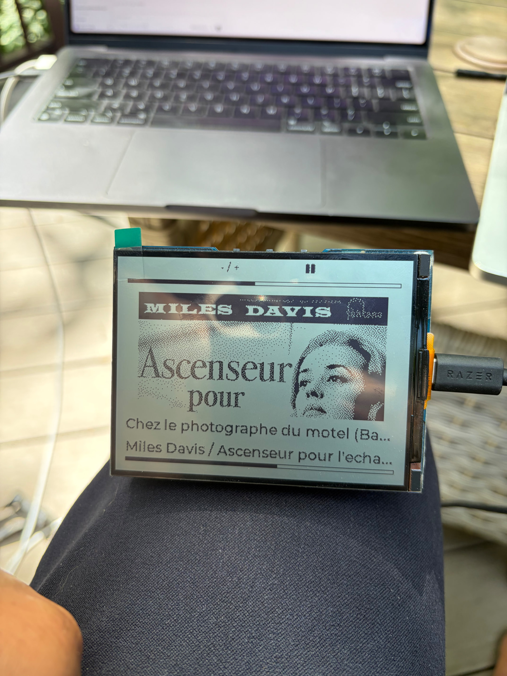

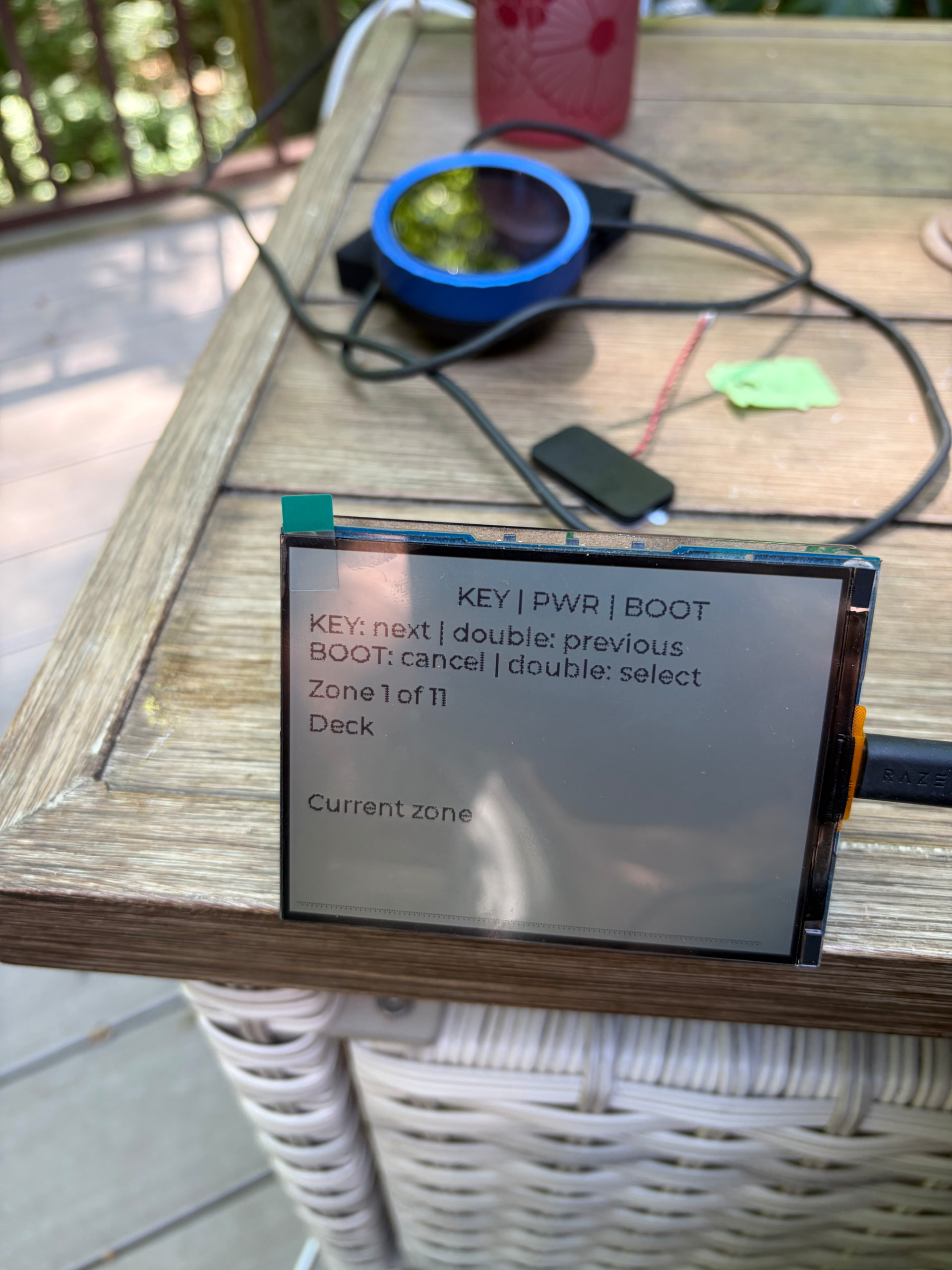

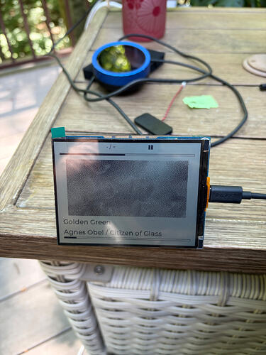

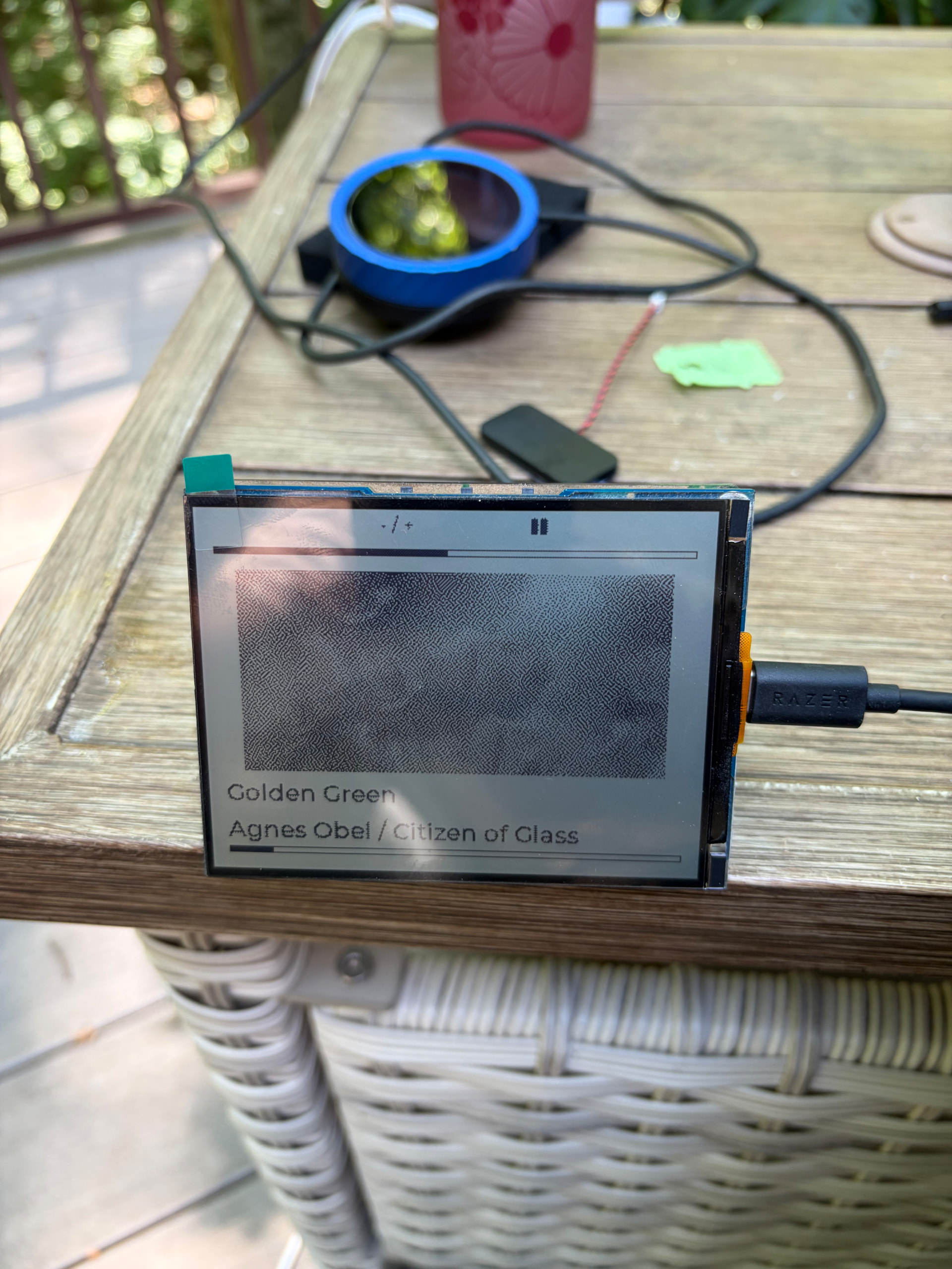

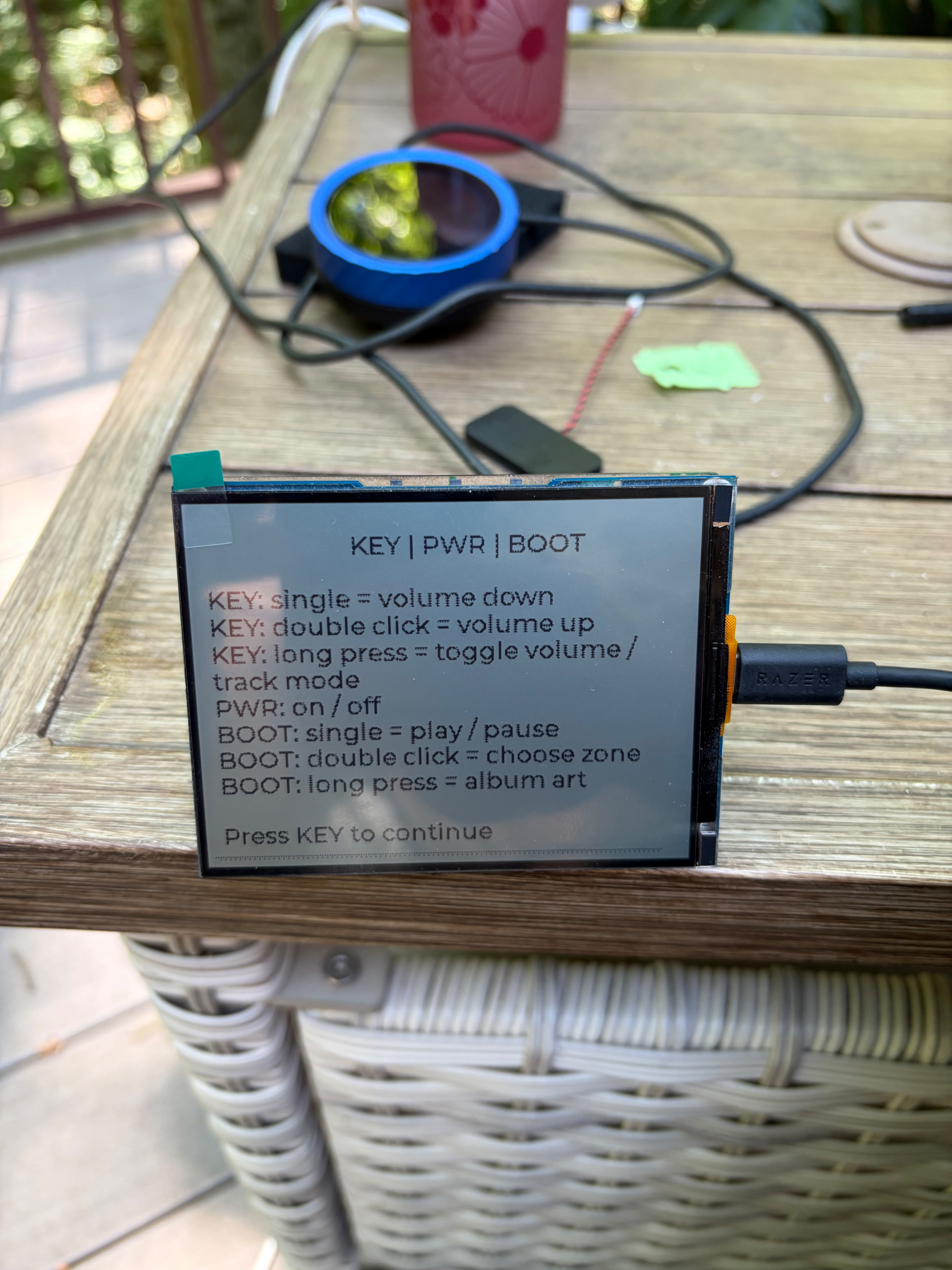

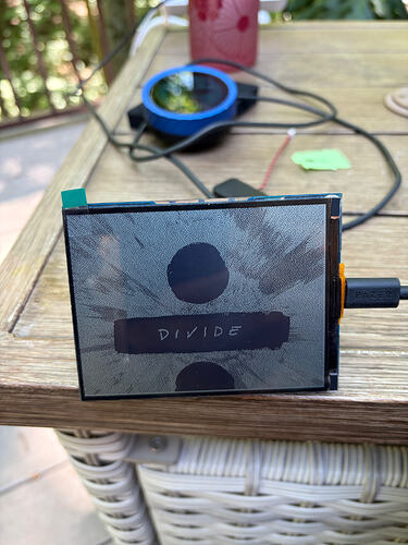

The RLCD controller is coming along nicely. While the photo reflects in person it’s very clear. There are three buttons and BT media remote pairs well. Would love a tester if this is interesting to any of you.
Looks good where is screen purchased from.please ?
Here is a link for that RLCD with ESP32-S3.

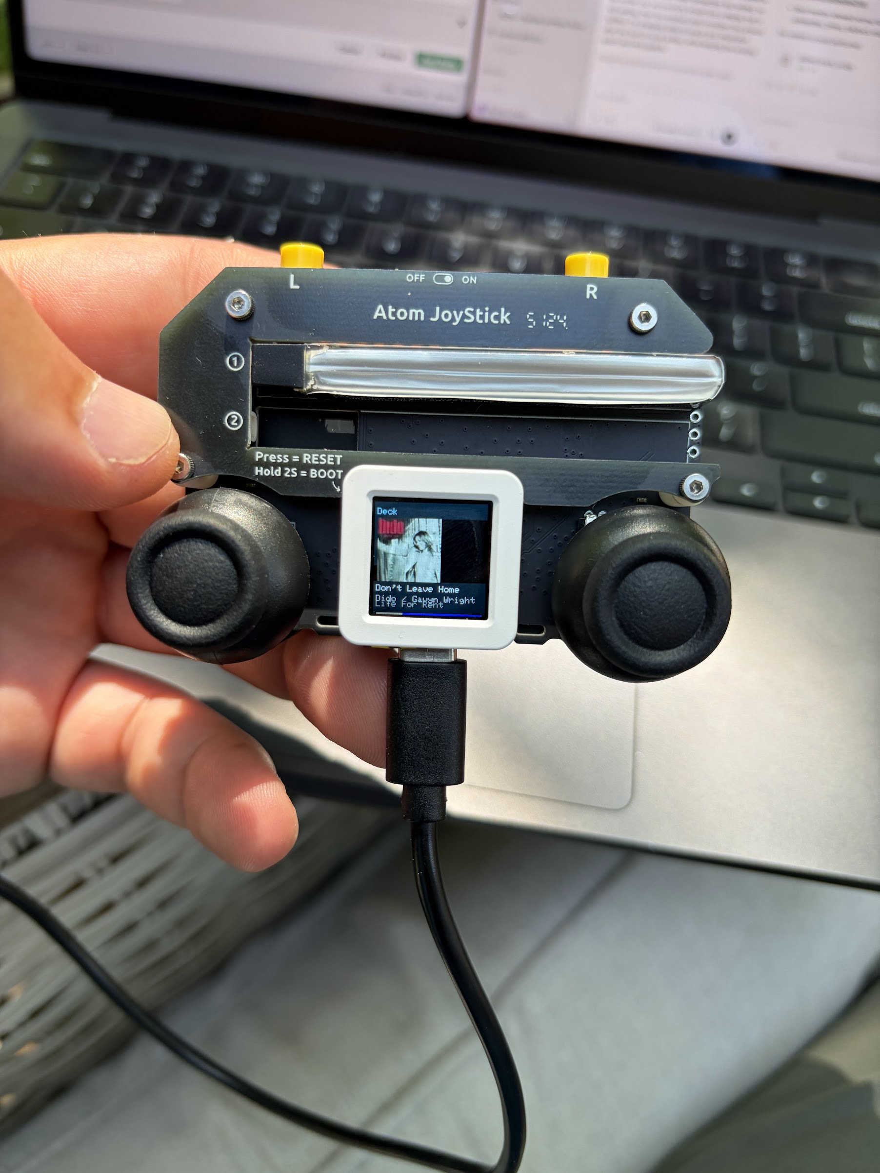

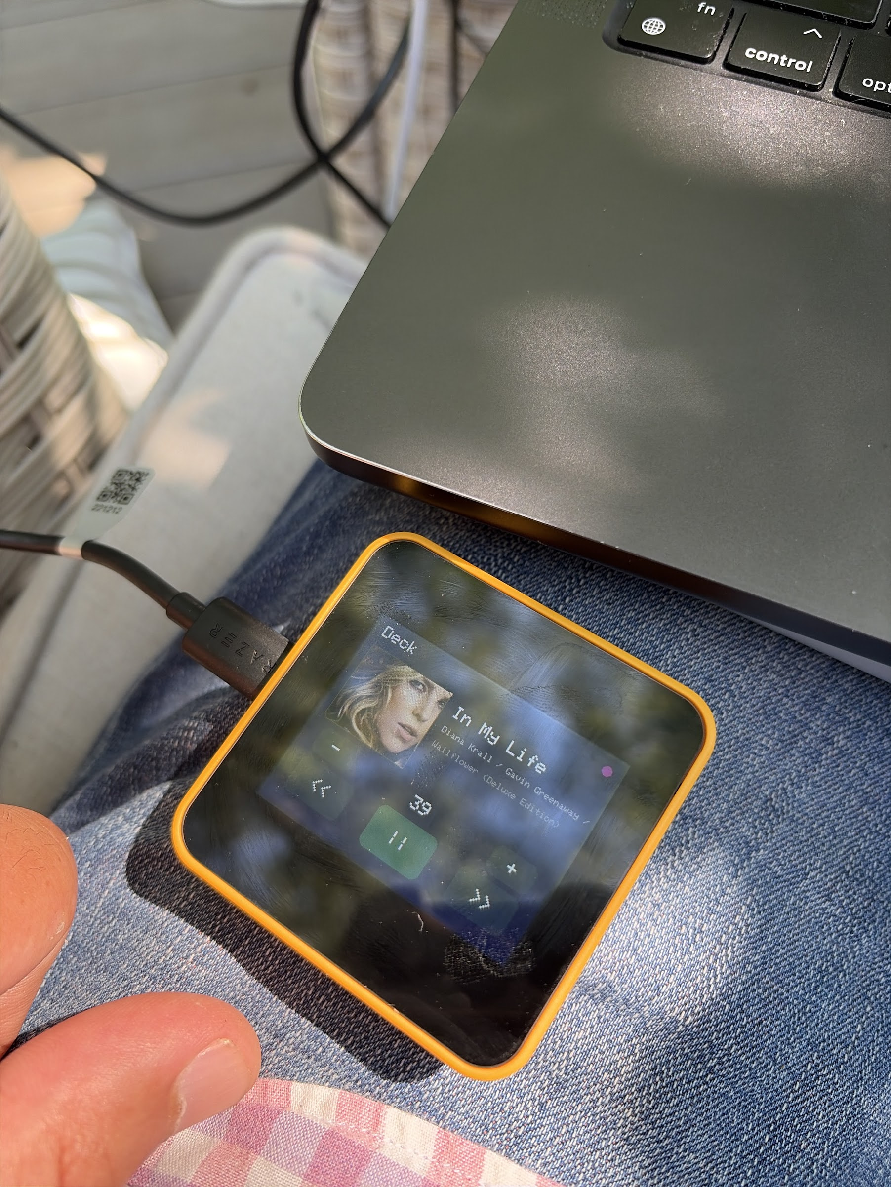

​If anyone is interested in different form factors for control, I have firmware ports for the M5Stack Tough (outdoor rated) and the M5 Atom Joystick (programmable dual joystick remote controller).
My favorite is probably the Joystick one: build in battery (that white strip), multiple controls, dedicated on/off switch.

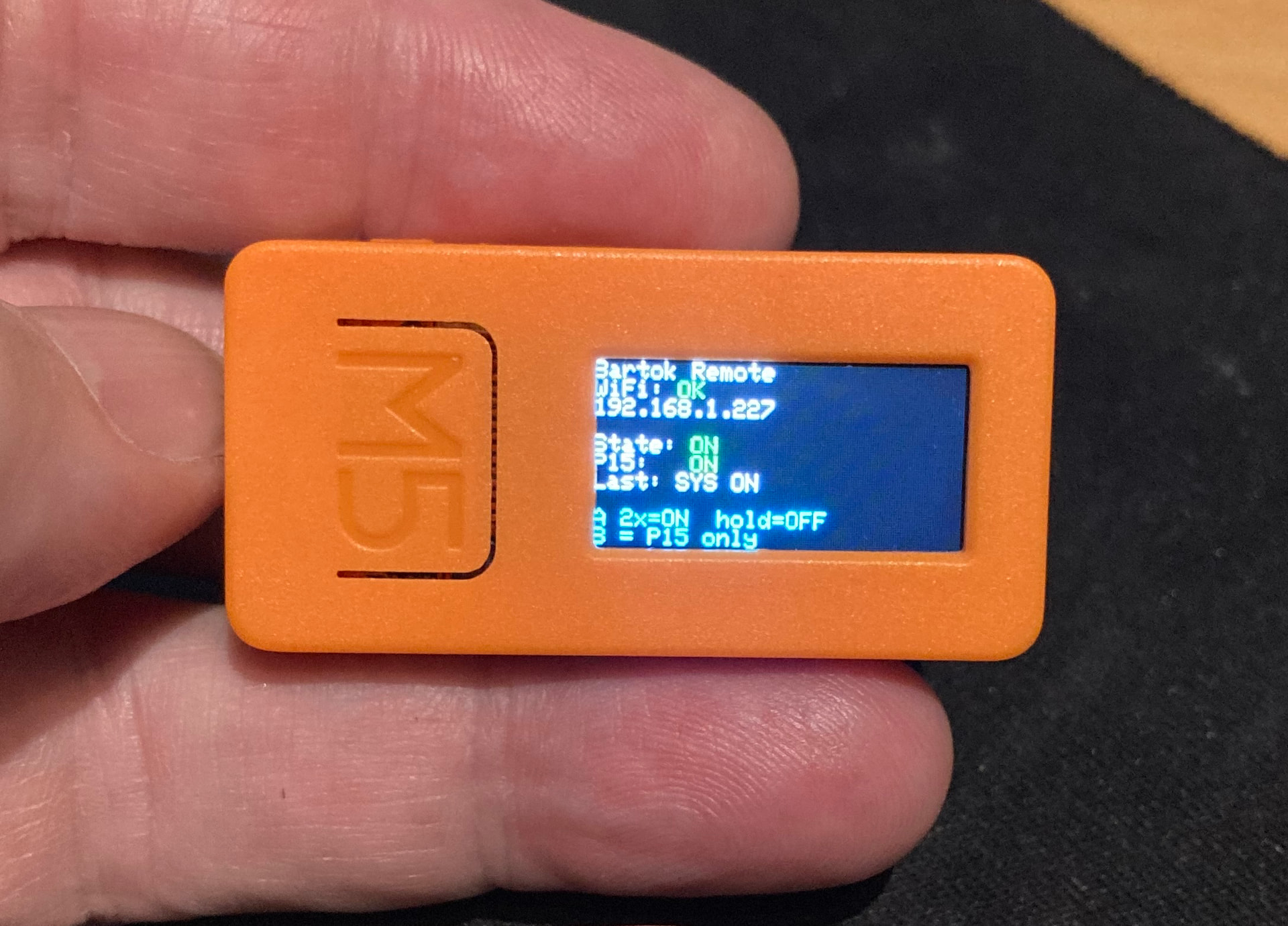

Very cool! I made a little ON/OFF remote with a M5Stick. It turns on the P15 PowerPlant first, checks for confirmation then turns on the Bartok. Long click reverses the process to Off.
