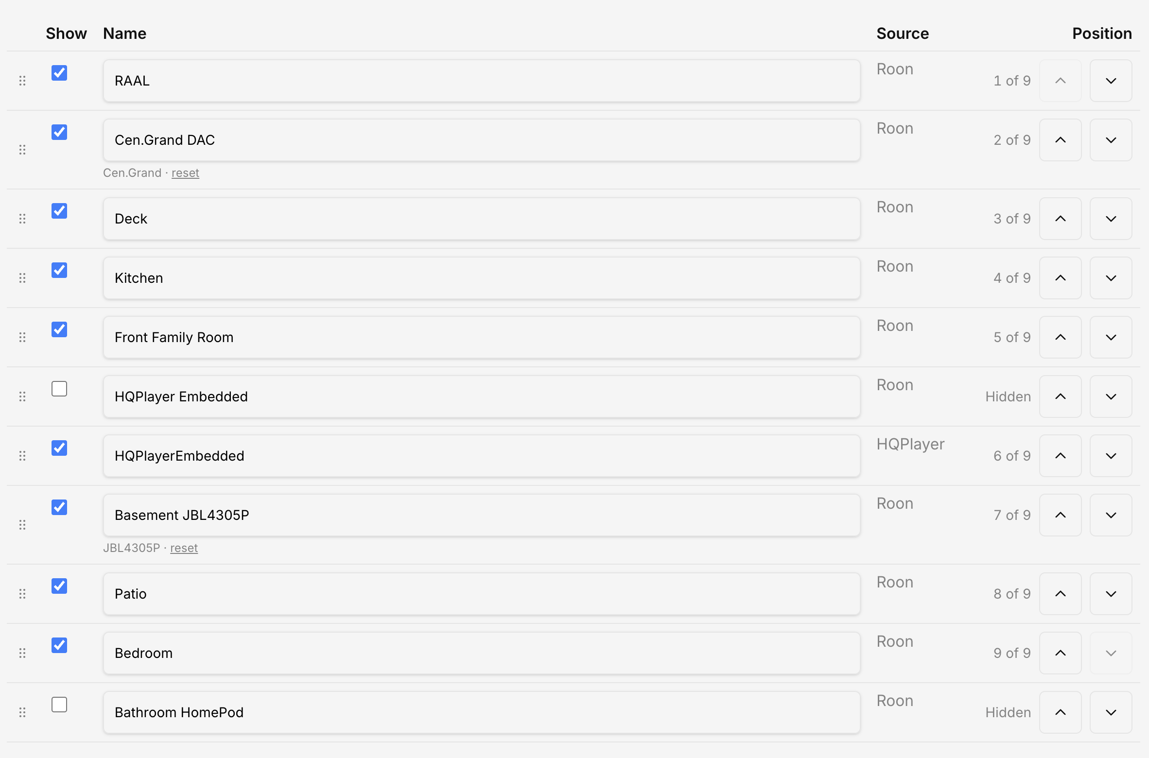

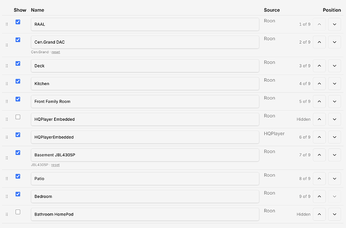

Thank you for this very promising tool. I installed the Unified Hifi Control in a Docker container just to test the roon connetion. It is working so far. However, I think it should respect private zones and exclude them from the zones list. Or, at least, it should be configurable somehow.
Ah, great point, I don’t use those so totally slipped my radar. Will look into making that the default.
Sounds like you’re using Unified Hifi Control but not the ESP32 Knob? What’s the use case (am just curious!)
Thanks for having a look into it.
My use case is testing before bying
Don’t see anything from Roon that specifies if a zone is private or not. Gonna look into Zone hiding on the UHC side so it works for all adapters anyway.
