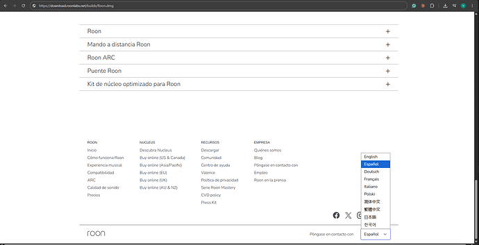

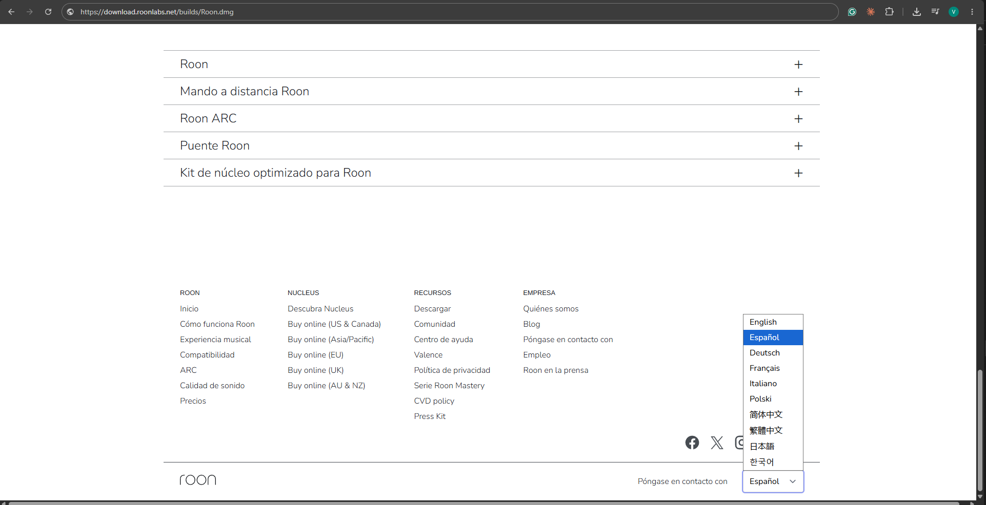

Would you kindly clarify the language setting on the Download Roon - Mac, Windows, iOS & Android Apps | Free Download ?
Thank you for confirmation it works

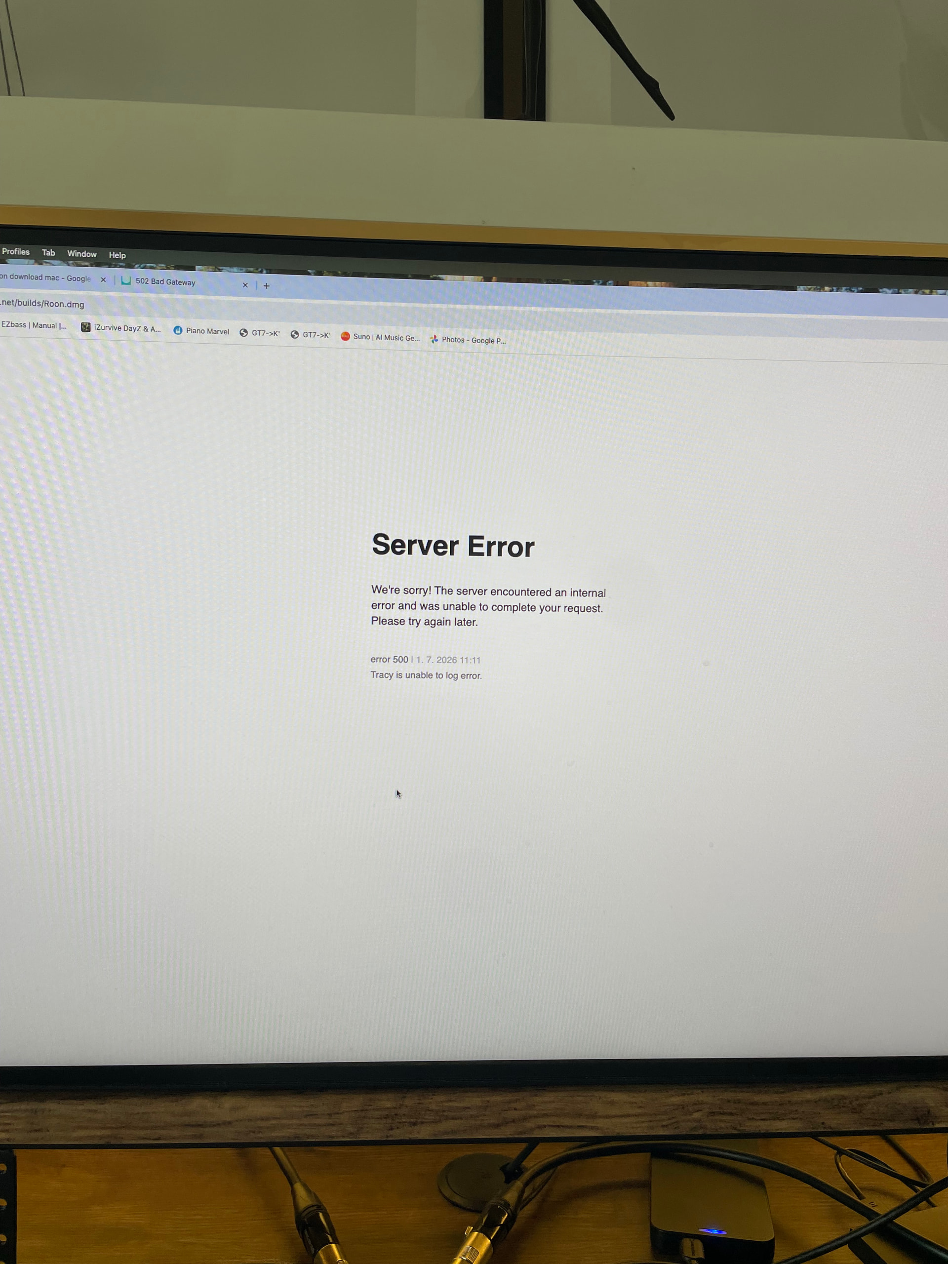

The error message I see happens when I click the link on the Roon website marked ‘install Roon for Mac’. That returns the gateway error. I am at this point logged in to my account.
I hope this information is helpful.
The language on the free trial page is English.
I have have investigated further.
The main Roon website works normally. The problem only occurs when I attempt to download the installer.
When I click the download link I receive SSL certificate warnings followed by HTTP 502 Bad Gateway or HTTP 500 Internal Server Error messages.
