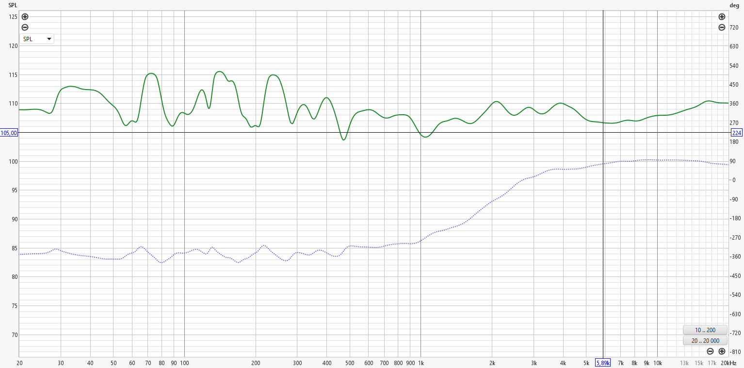

And it seems to working, for example this is the convolution file for left speaker that I currently use. As you can see, there are big and dramatic filters at lower frequency, but as you go towards higher frequencies the corrections becomes more shallow and less steep (lower Q). This is correction strength 5.

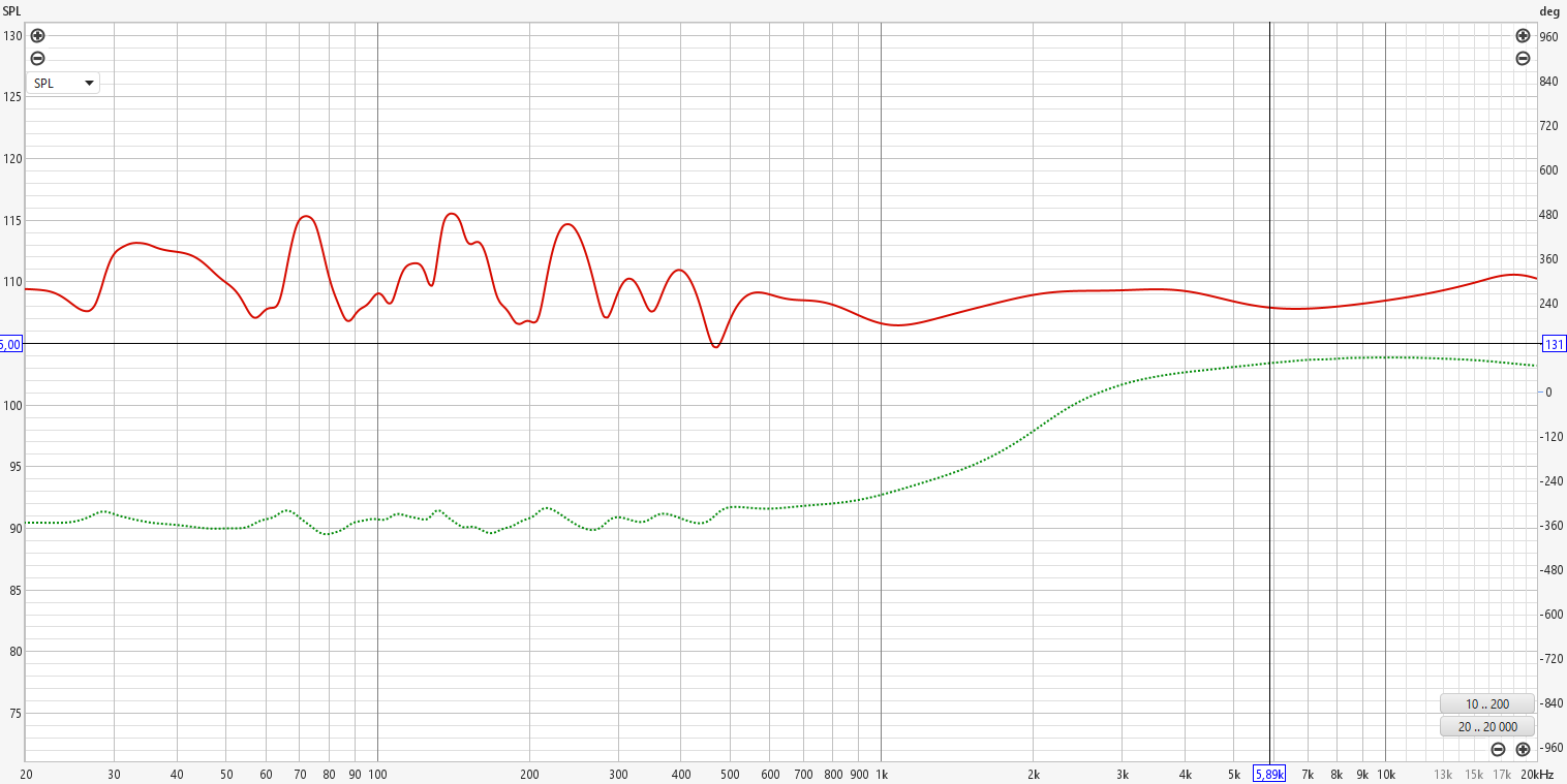

Here is the same correction but with correction strength 10, now it corrects more aggressively in higher frequency (which might be good or bad, test and decide for yourself and let the ears decide):
As you can see I used mixed phase in FF, which means FF also corrects for speaker crossover changes (my speakers have crossover at 1.9 khz).

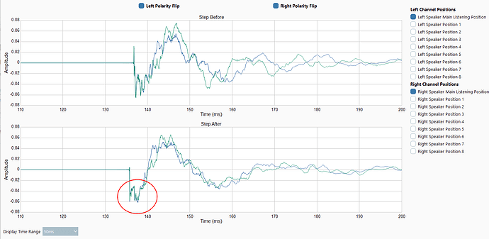

My step response is shown below, and it looks good except the first ms (red circle). Anyone know the reason for this? Acoustic treatment (I have lots)? Crappy speakers? Interpreting step responses is currently above my paygrade :slight_smile:
I seem to get that no matter the correction level I use, also tried with/without mixed phase and with/without fine time alignment.
Don’t think it matter, but I use toslink from computer for sweep measurements (every type of enhancement turned off).
Or could it be because I use a NOS DAC (Holo Audio Spring 3 KTE)? I up sample to DSD256 in HQPlayer, but that’s not done when measuring over toslink.

No experience with ff, but …
Why do you flip absolute phase?
Looks like tweeter and mid(bass) are originally connected with opposite polarities, as is usually the case with textbook second order passive crossover networks to achieve proper amplitude summation.
The correction inverts the tweeter phase to match the mid(bass) but what remains is a discontinuity in the handover between tweeter and mid(bass) as can be seen by the droop, which should actually show in the amplitude response around the crossover region as well - care to show a measurement of the corrected response?
Unlikely anything to do with room treatments or DAC architecture.
More likely induced by physical speaker and passive network design, as well as desktop setup.

I just flip the absolute phase to get them to match with uncorrected one. It could be the problem you describe. However, I will test next week to try and get a measurement with up sampling in the mix. Btw, calling out to @jussi_laako which filter would be best to use for measuring purposes? I imagine a very neutral and plain short filter (not that I think it makes a big difference). Or should one measure with the filter used normally?

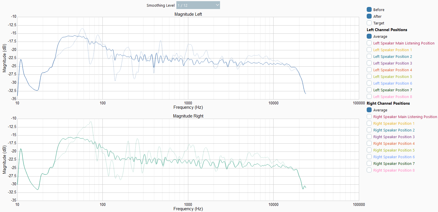

Here are the amplitudes, faint lines are before correction. Its not a pretty sight, but I have a quite horrible little 3x3m room. Phat base traps means I don’t have any null nodes though so I can correct everything (FF makes sure of this as well).
As you can see, the NOS DAC makes the response drop before 20khz.
