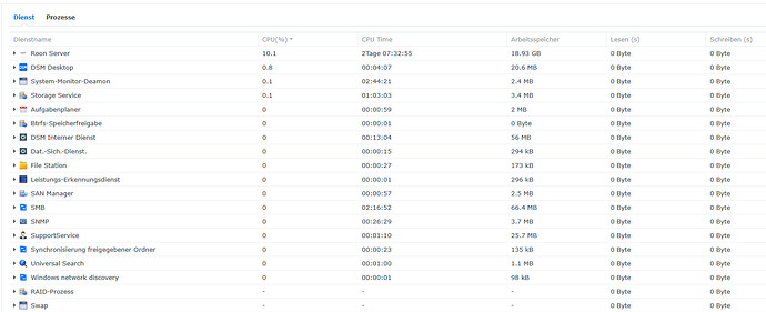

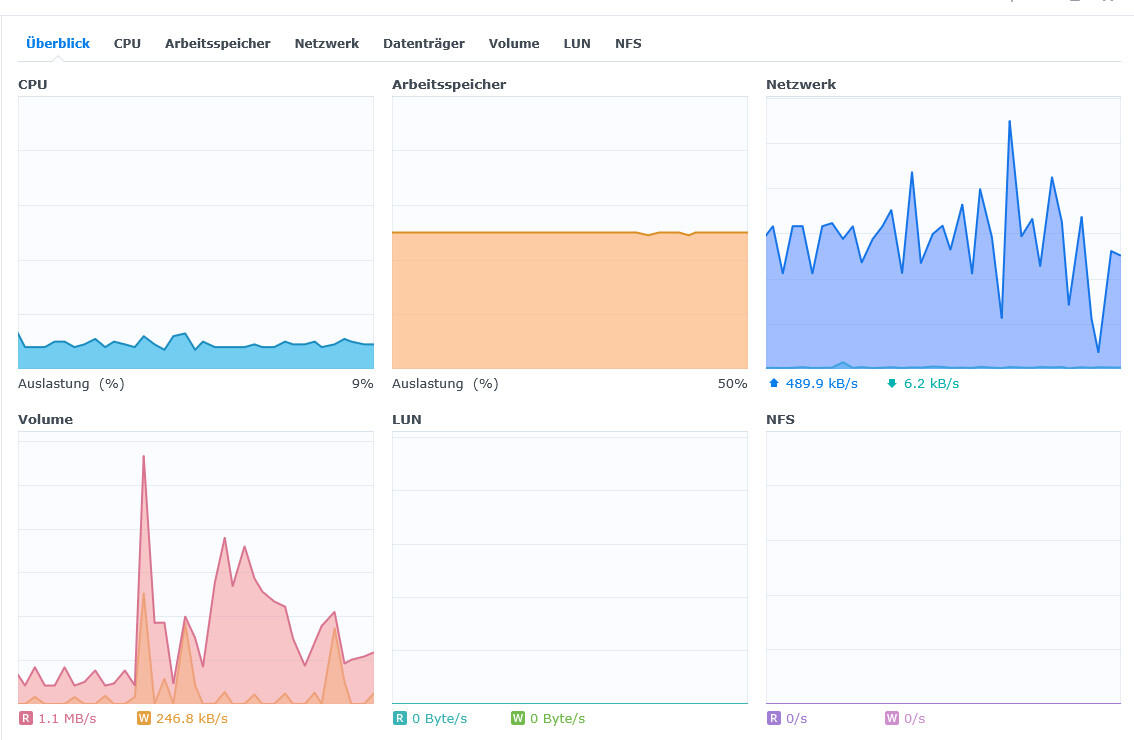

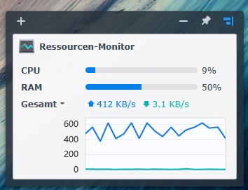

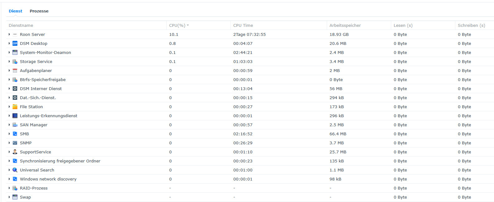

I’m wondering about the meaning of this (used ram)
after installing roon on the synology without using it

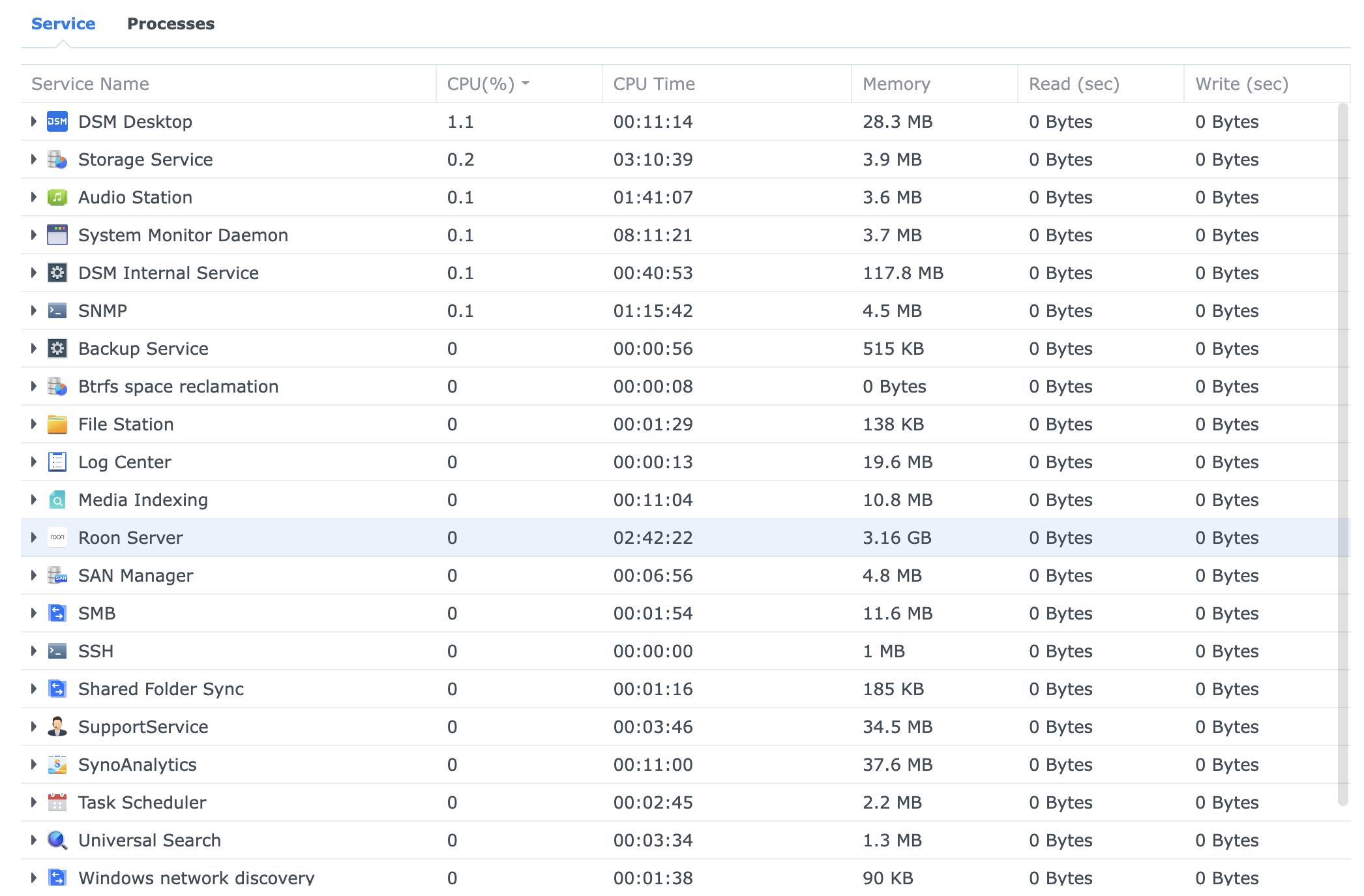

How much RAM do you have installed?
If you go to “Task Manager” on the left side meny, how much RAM is Roon using?

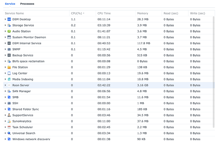

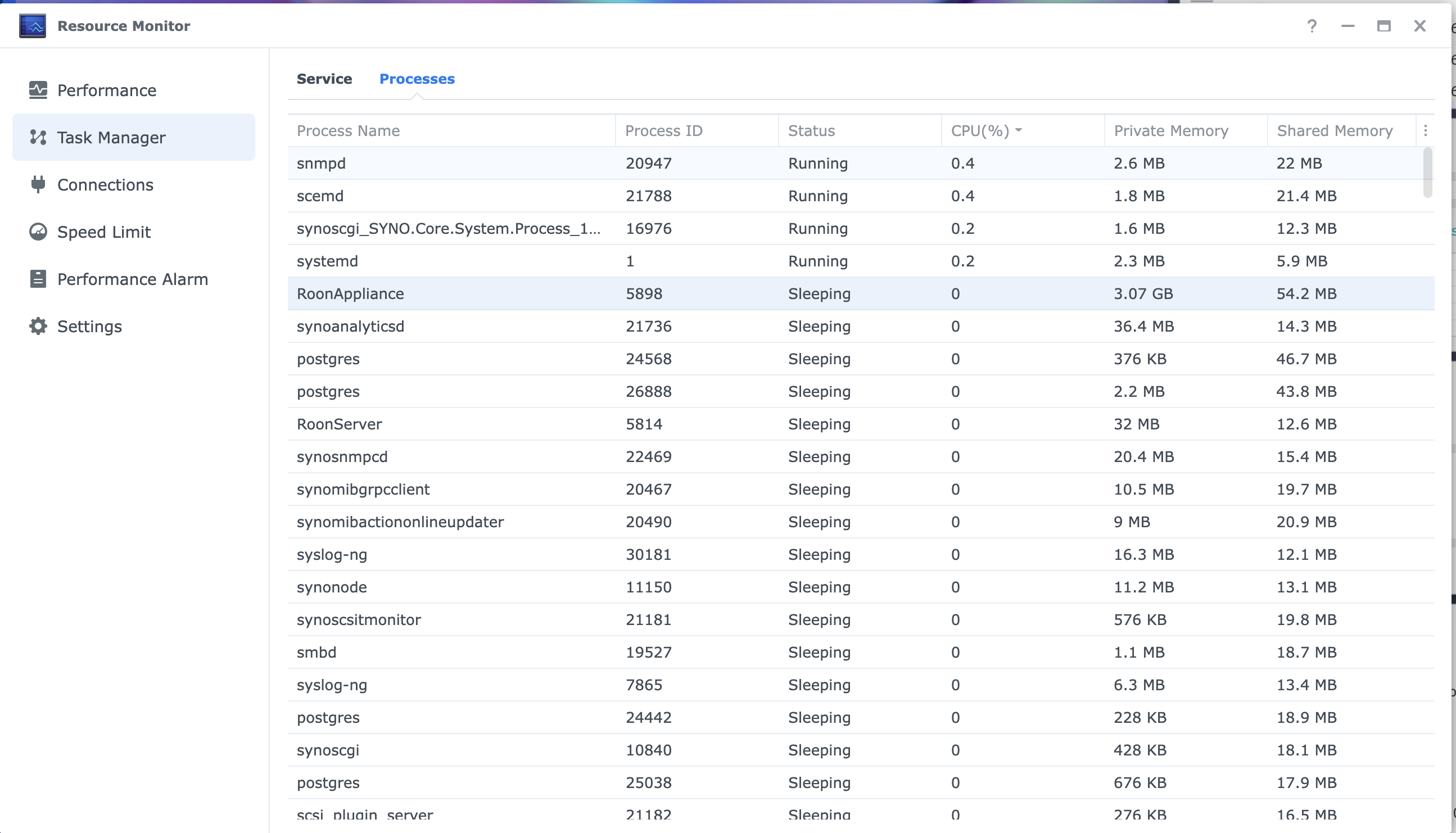

This is mine with 16 GB of RAM:

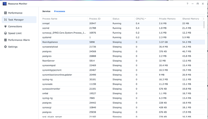

What does the Task Manager say?

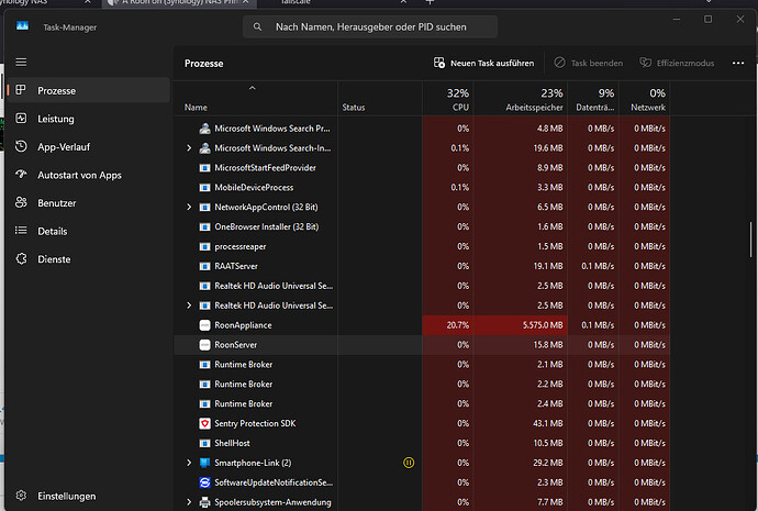

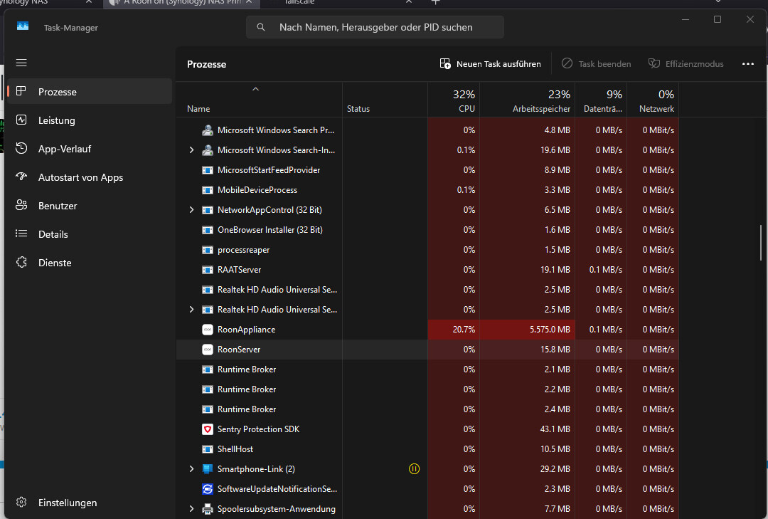

there are 40GB RAM on my DS1522+
but am I right, this is RAM of my PC, not of the Synology?!
Right - that is RAM on your PC. Your Synology has this view as well - just select “Task Manager” from the left hand navigation…sorry I cropped it from my original screenshot:

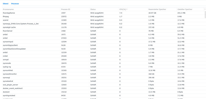

Wow. Are you using the Roon on NAS package from Christopher Rieke?

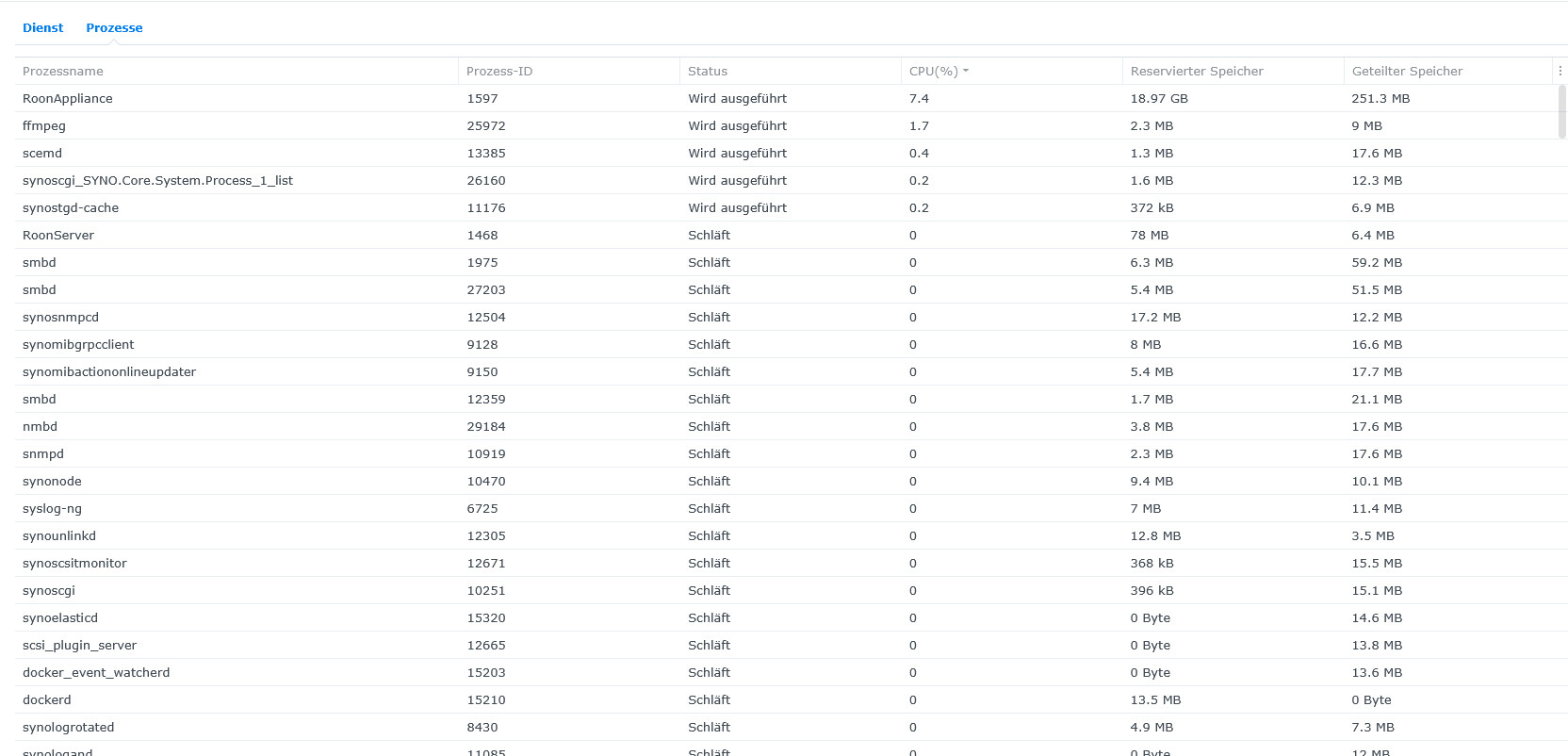

Also, what happens when you click on the “Prozesse” tab?
How large is your collection?
1 yes
2.
3. >1.000.000
I just wanted to try out whether it makes sense to use the NAS as a server. I actually have a separate ROCK, but trying things out is the best way to learn…
Then I would say that you are doing OK with that RAM usage. Roon is designed to use up the RAM you make available to it for its in-RAM database. So long as you can use Roon smoothly to enjoy your music, there is nothing to worry about. Pröst!
