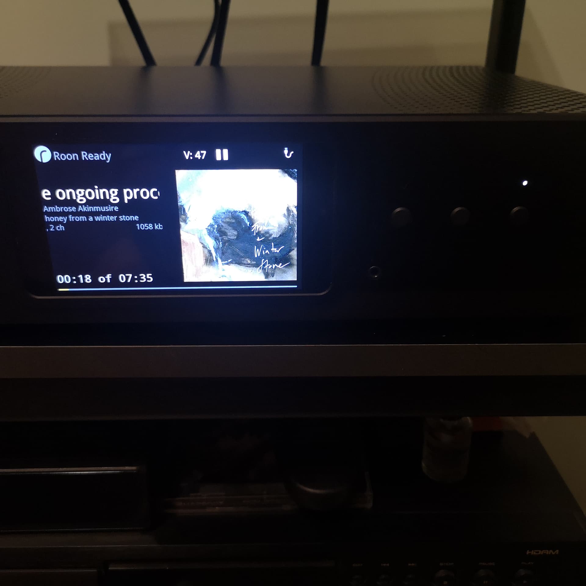

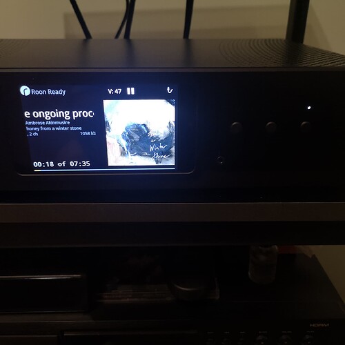

Good evening, I am an owner of the Streamer ST300 Signature. After updating Atoll to the new firmware 2.5.2, I noticed that the streamer behaves abnormally, especially when using Roon + Qobuz (latest Roon build on a Windows 10 ). Often the screen does not show cover art or disc informations. Also, when I press the off button, the streamer stays on for a long time, about a minute, before turning off. Everything works with Atoll native app.....Is it an incompatibility problem? Is there any possible solution?

i am trying now…just pressed the streamer off button, nut nothing happens…

I confirm that using the native ATOLL app, there is no delay. As suggested, I tried restarting the rooter and changing ethernet cable, Roon continues to experience the delay, which on some occasions does not even allow Atoll to show the songs metadata (cover art, artist name, etc…) on its display.
