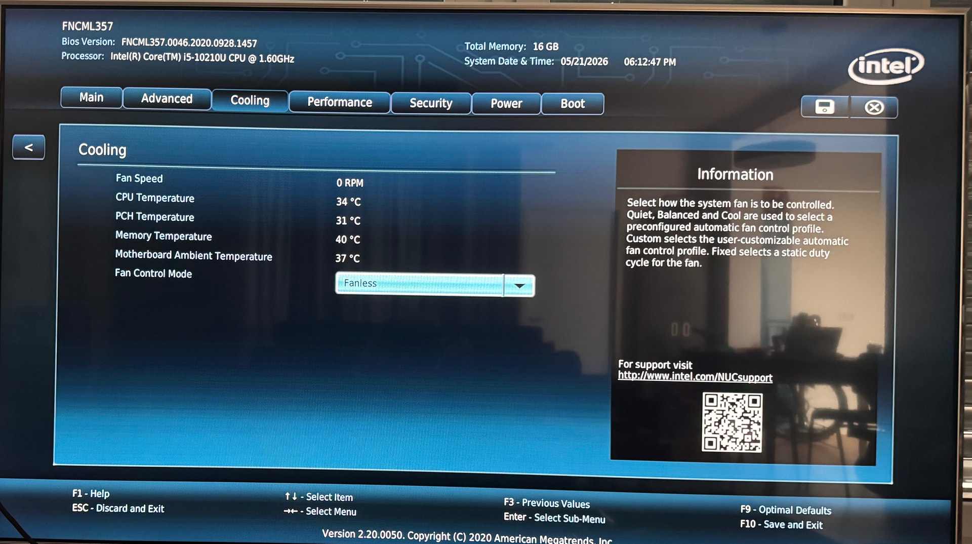

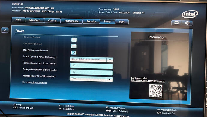

  2. The KB guidance for the critical BIOS config settings for the NUC is appreciated and helpful. In addition, I think it would be helpful to add a recommendation to make a photograph of every BIOS config page before updating the BIOS, in particular if using a fanless device. I understand that Roon Labs can’t be responsible for specific machines’ necessary BIOS settings, but I think it’s worth pointing out that they exist and should (or must, in case of fanless machines) be retained. (The same hint should be in the ROCK installation instructions as well. In case you will provide UEFI instructions for OS 3.0 for older Nucleus, there should of course be complete step-by-step instructions for that).
    • On the Cooling page, the BIOS has a setting for fan behavior including a “fanless” option, which one surely wants to configure the same:
    • On the Power page, there are settings for Package Power Limit and Time, which control how long Turboboost is used. On my Cirrus7 fanless device, these were set lower by the manufacturer (as depicted) than the BIOS default:
    • One might have other settings that one wants to keep and it’s easy to forget.

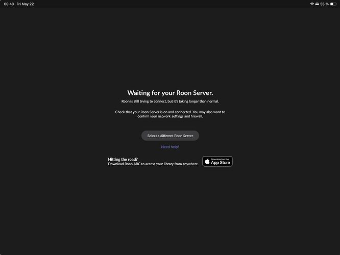

Somewhat related, the process of switching to a new server in the remote is still a bit scary to the uninitiated and could use some love:
On the first launch of a remote after the server migration, it can’t find the new server. Perhaps that’s unavoidable, but maybe it could discover all servers on the network right there? If it’s unavoidable, the small-print explanation could have some reassuring language in addition to „check that your Roon server is on“, like „this is expected if you made changes to your server“:

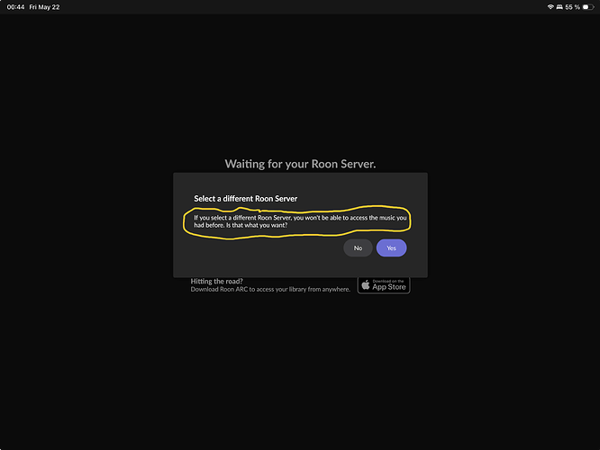

Then when you make the switch, there’s still the „you won’t be able to access the music you had before. Is this what you want?“. In my forum experience, this is often read as somewhat menacing and is what freaks people out the most. It needs a „just click yes, it’s fine“ reassurance post much too often:
Perhaps it could clarify:
  • Some language that reassures that this is normal and expected because you can’t access music on a server as long as you’re not connected to it.
  • If you are switching between more than one existing server, you can always switch back to the other one.
  • If you migrated to a new server, you are just going to tell Roon to actually connect to the new one.
