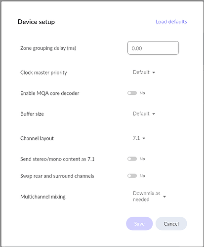

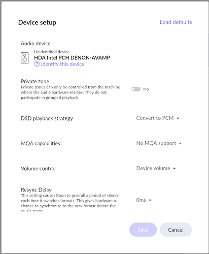

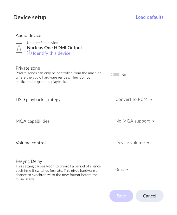

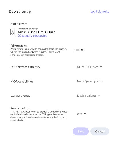

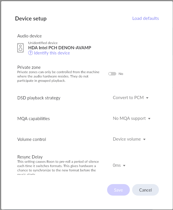

Open up the Roon Device Setup screen on the relevant port; for example:

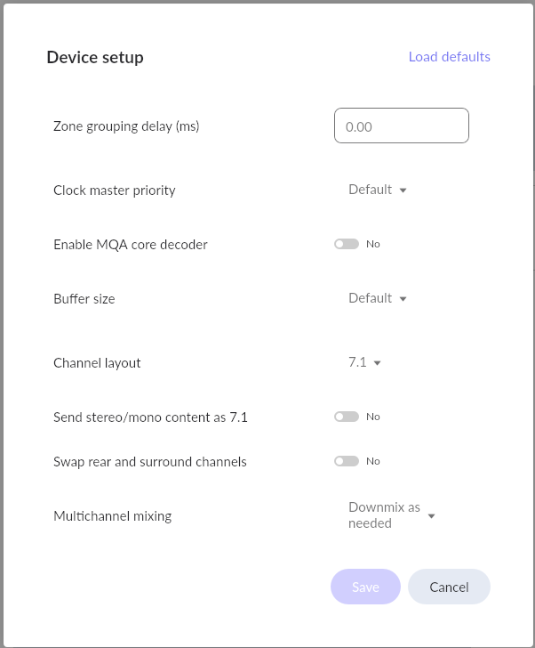

In the Roon Device Setup screen, you want to scroll down and open the Advanced Settings section (note: no scrollbars are shown, but it is a scrollable window). Then scroll down further to show the Channel layout setting and set this for multichannel working. For my Denon AVR this is 7.1:

@Geoff_Coupe for context, we have been through this in another thread, but as far as I can tell @Gary_Cardinale‘s Settings > Audio doesn’t show any HDMI device, so he can’t enable it:
I found another old thread that looked similar and support had this other user delete a cache folder on the Nucleus (or something similar), but I didn’t want to mess with this and so I suggested that @Gary_Cardinale opens a Support case, which is now this one.
OK, thanks for this - indeed no HDMI outputs are showing for the Nucleus One of @Gary_Cardinale, so lets wait for @support to pick this up after their weekend break…

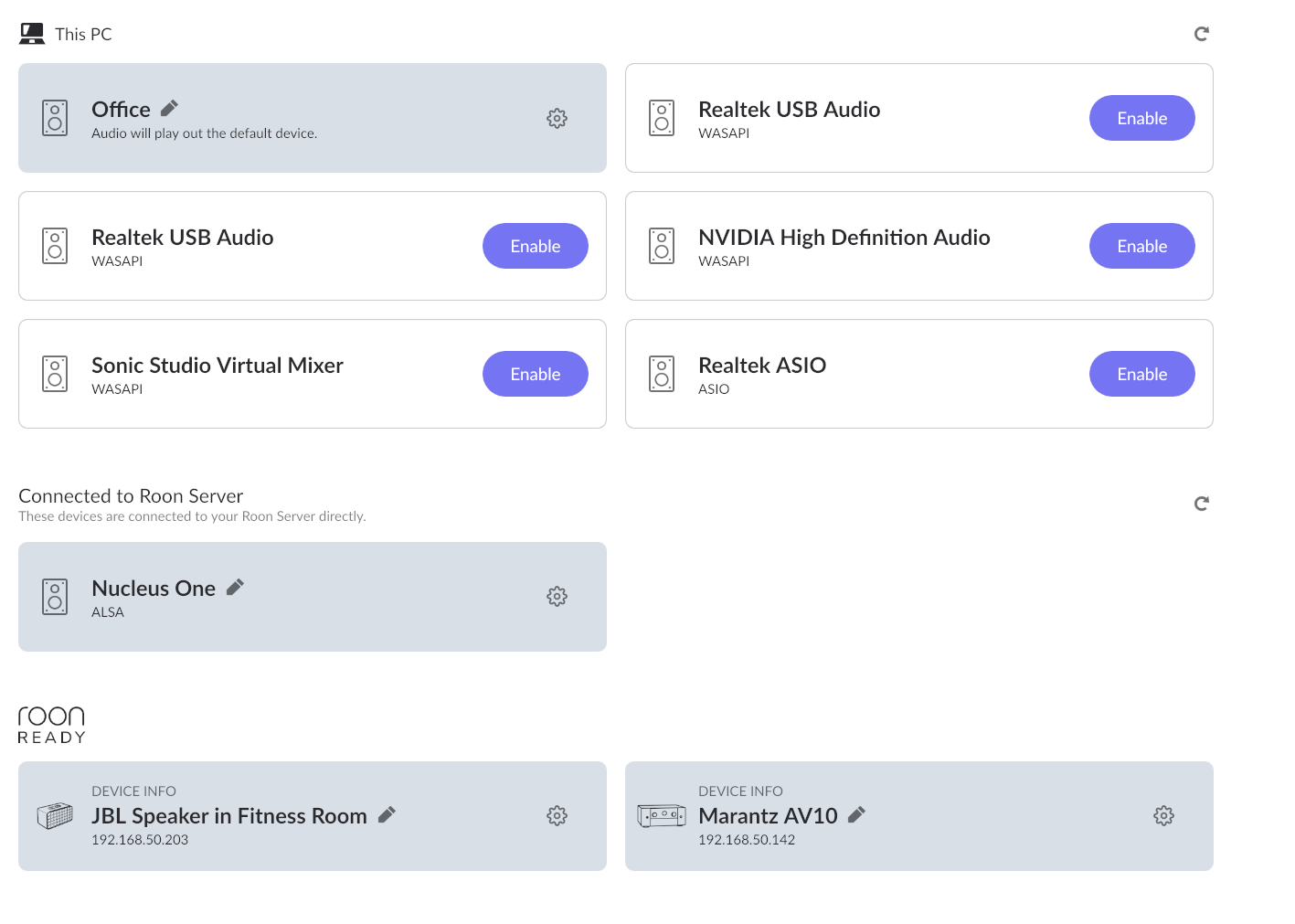

Could you share a screenshot of your Audio Settings page?
I assume you have already tried:
  • In Roon → Settings → Audio, enable and select the "Nucleus One HDMI Output" zone
  • On the Marantz AV10, manually switch the input to the HDMI port the Nucleus cable is connected to
Thank you!
@Gary_Cardinale shared it here:
And this is what shows when I click into the Nucleus One cog button on the right…

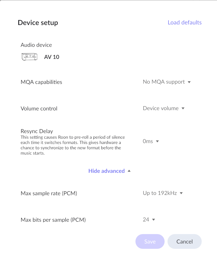

And here is the AV10 setup page

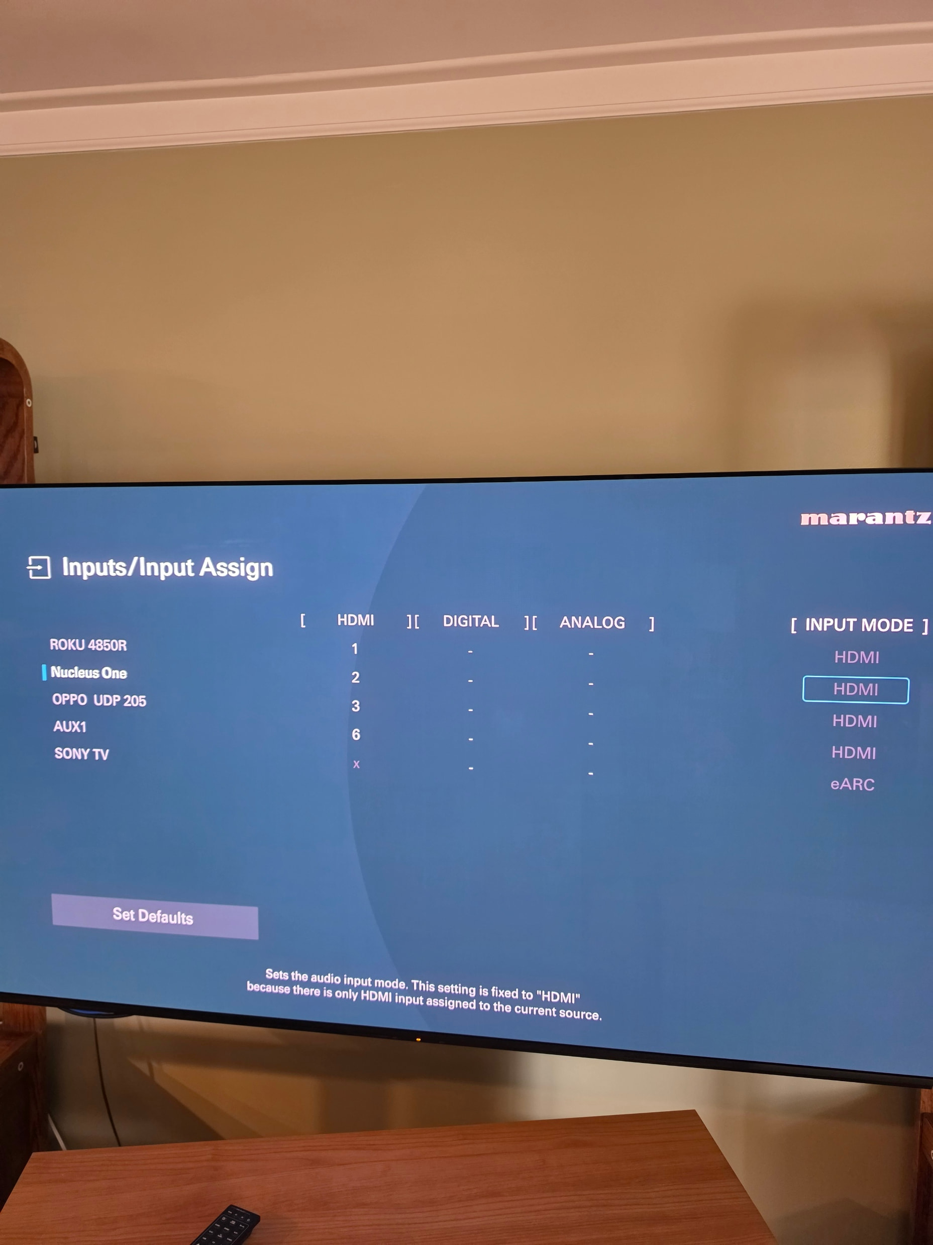

And here is the input list on my av10. Notice they all say hdmi…
Um, I suspect that the Nucleus One ALSA entry is in fact your HDMI output. Why don’t you try scrolling down to reveal your Advanced settings as I suggested earlier?
Not sure which advanced settings you mean? For what device? The screen above shows the av10 advanced settings.
And there are no advanced settings for the Nucleus device
When I use the Nucleus One ALSA entry to play, there is no sound. The only way I get sound is to use the AV10 entry and that is only 2 channel.
Look, as I said a week ago, you need to scroll down on the Nucleus One HDMI Output screen to reveal the Advanced settings - and there are no scrollbars on the screen to indicate that it is a scrollable window…

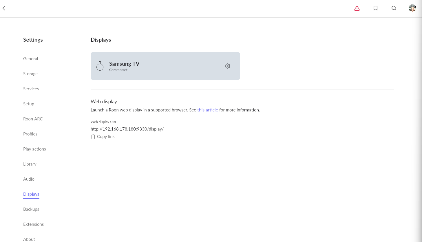

  1. Most modern “Smart” TVs have a web browser built-in - you can use that to display the information. Go to Roon’s :gear: > Displays screen to do that (you’ll find a link to a Help article on that screen).
  2. A Chromecast Ultra can be used, connected to your TV, to display “now playing” information from any Zone.
I use option 2 in my setup with my Denon AVR and Samsung TV…
This was VERY helpful! Thanks. I have used option one and connected to the TV, and it works fine. The problem is it makes things a little messy when I want to use the TV with another input. For some reason the sound does not work and I had to fiddle a bit to get the sound back on. Other than that this all is alot clearer. Thanks again.
