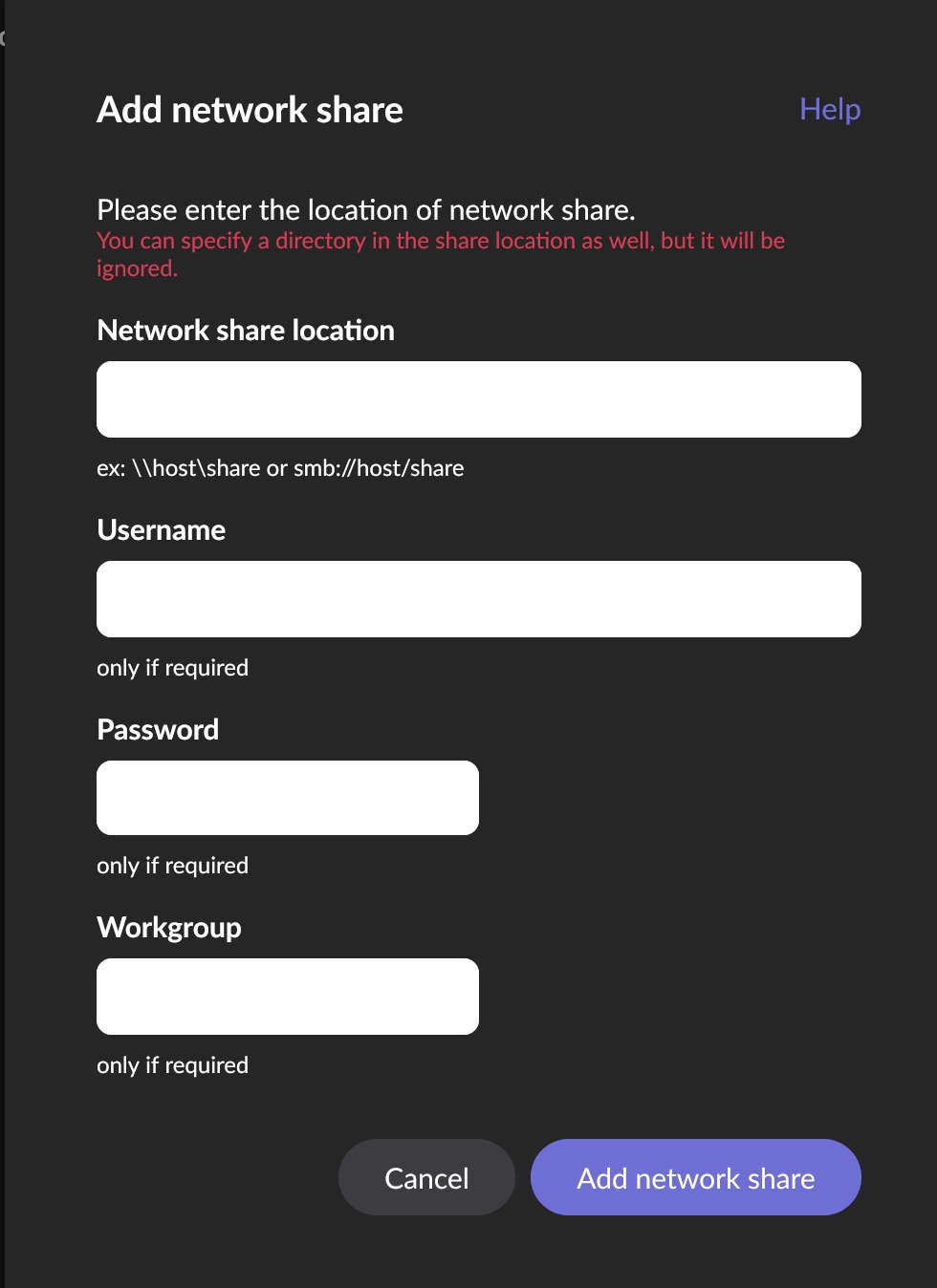

  • My main concern is that I am a numpty when it comes to mounting drives, and getting it to register in the following window in ROON

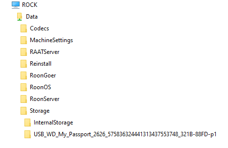

If I understand correctly, you’ll be attaching the drive directly to the ROCK/NUC, that means you will not need to do a network share for that drive. It will show up in the storage directory on the Nuc once you connect it.
Review these for best practices for storage. The USB sections in particular.
I have an internal SSD and an external USB HDD , they just show up in the ROCK folder
They just connect (mine is disabled as it’s a lo of duplication)

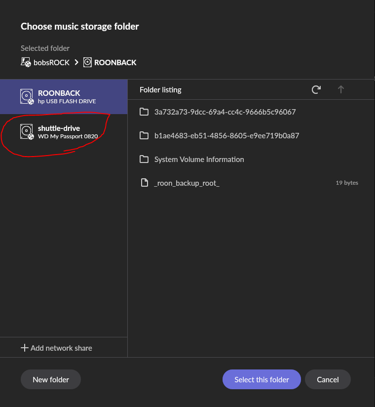

For your last step the usb drive will be seen by the NUC/ROCK but you will need to add it in Roon Settings/Storage (not through ROCK WebUI if I read your intent correctly). I would give roon a few cores to work with on the settings/Library page, too. It will at least make you think it’s moving faster…
Should look something like this:
Then you just select the folder where your music is and it should start analyzing it.
Also, if you just disable the old watched folder first like @mjw said and then add the new one it gives you backup plan if something goes wonky with the new drive. Once all is good with the new drive you can delete the old watched folded from settings/storage.

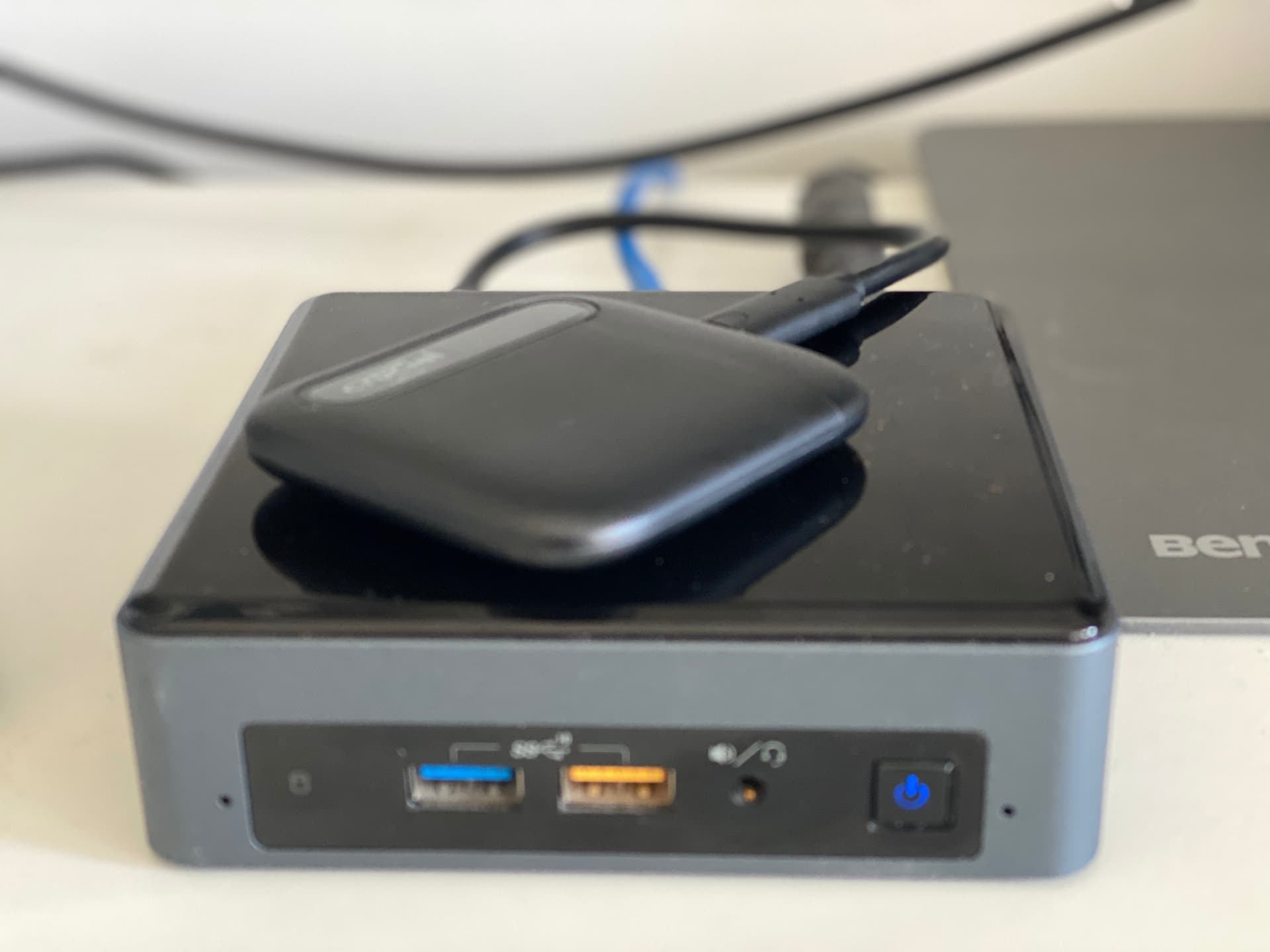

Thanks @Mike_O_Neill @mjw @Tyler_Rynberg and @Jim_F for your thoughts. I have a skinny NUC, so no can do an internal SATA. I will be using an external drive, and as per advice in this chain, I didn’t purchase a super duper fast one, I’ve gone for a Crucial X6 with 2TB. Given I can hook it up to my Mac, rip CDs to it, then reattach to the NUC, this is a win for me. I take note of powering down the NUC before discsonnecting, as some have advised.
I pick up the Crucial X6 tomorrow, and, it’ll take a while to move the data from the SAN to the SSD, but will be able to give feedback on how I go with decom and instlaling the SSD!

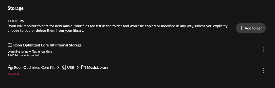

I’m Done! Thank you very much for your comments and suggestions over the last 5 days. Steps were:
  • Plugged into my Mac for an exFAT format of the Crucial X6
  • Copied all my music from the QNAP to the SSD, only took about an hour for the ~500GB.

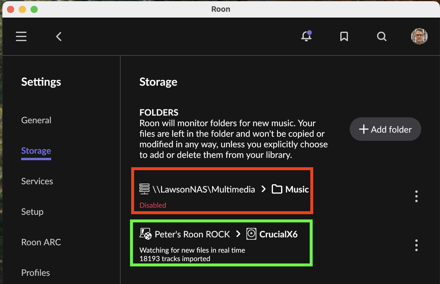

  • Disabled the storage in ROON
  • Demounted the Crucial from the Mac
  • Switched off the Intel NUC

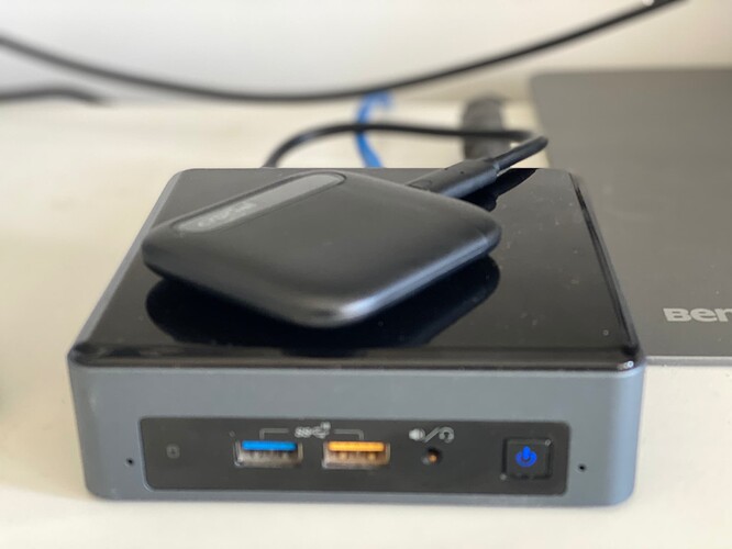

  • Plugged in the Crucial X6
  • Powered up the NUC
  • Only had my Tidal albums in ROON

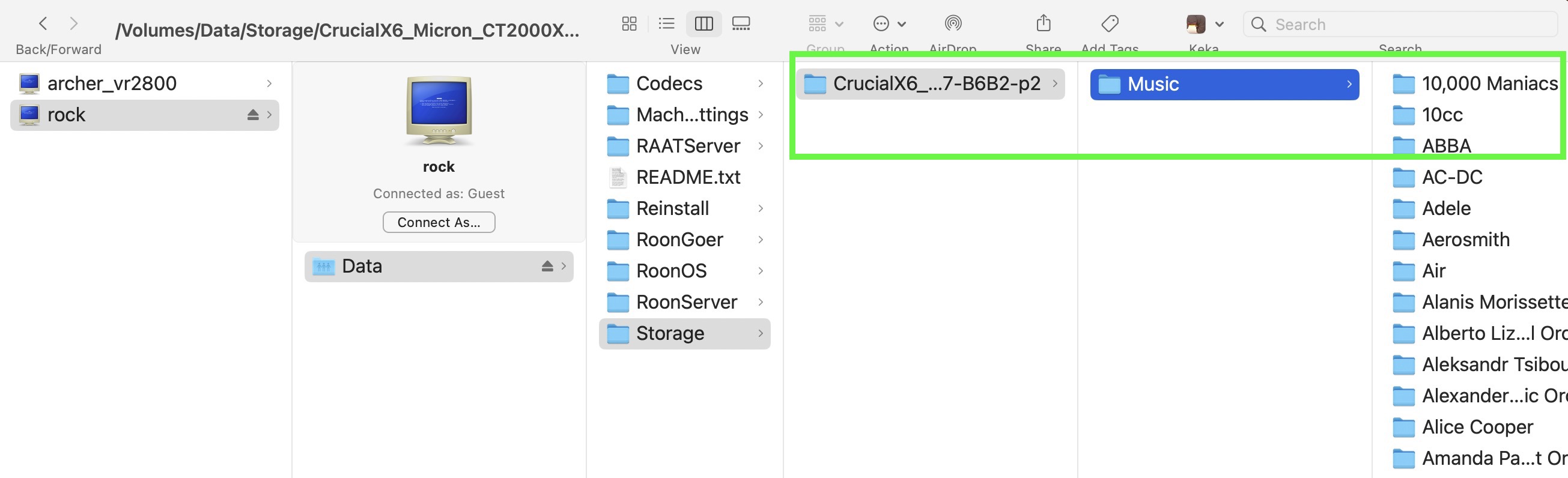

  • Went to Storage and added the Crucial X6 - it was highlighted as already plugged in

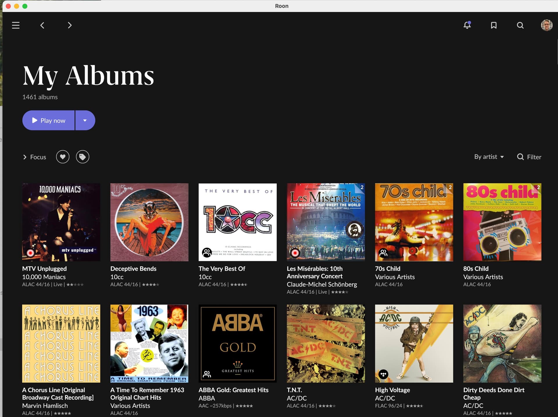

And back where I started in terms of music access
I’ll include a few pictures so you get the idea.
Cheers from Melbourne Australia
