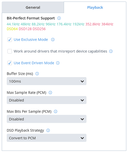

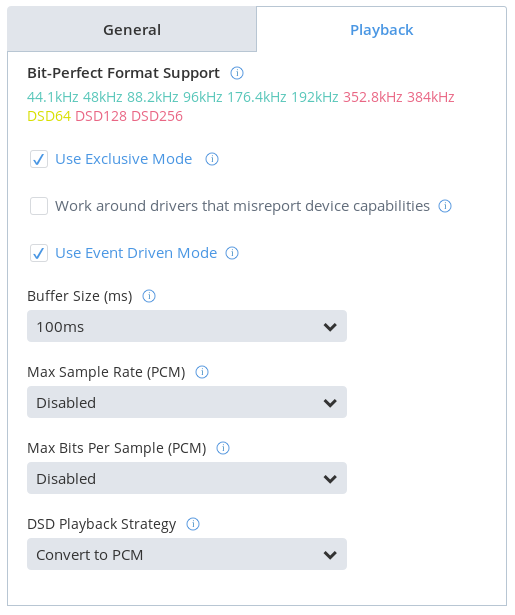

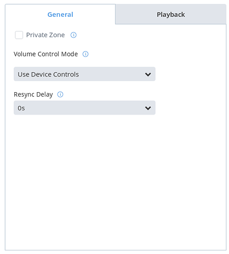

Hi @scott_powell ---- Thank you for the feedback and my apologies for the troubles. To help evaluate this problem, may I kindly ask you for the following:
  1. Screen shots of your audio settings, as seen in the examples below.
  2. Have you always had this issue while trying to user the McIntosh C47 with roon? If not can you think of anything that has changed in your setup (new cables, new networking hardware, software updates, etc)?
