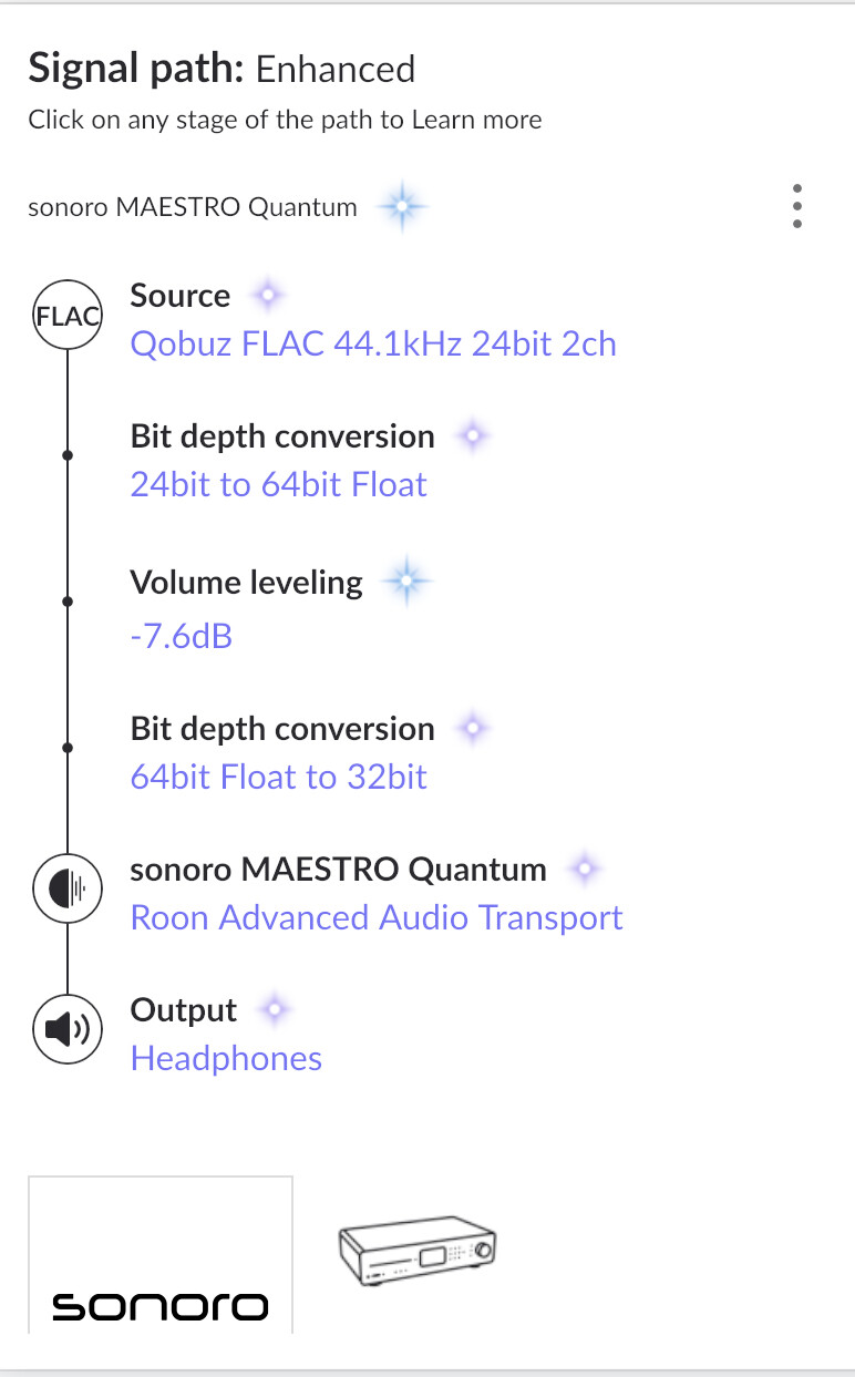

The answer, I suspect, is in your signal path. Could you post a screenshot of it?
Good guess, but so far as remember the leveling was never so high, probably not more than 3 dB.
Just playing something else, I get -9 dB…
Well, this depends on A) the leveling setting you have and B) the specific recording. What’s your LUFS value for A) in the Roon settings?
The minimum, -14 and levelling is set to Auto
Ok, probably not caused by the Roon leveling then? If it started with a firmware update, I’d reach out to Sonoro.

I have right done the following simple measurement:
My iPhone + dBMeter App in front of one the loudspeaker, play some rock music first with Roon and adjust the volume to measure about 50 dB. Than play the same over Qobuz connect.
I have measured between 8 and 10 dB more. The volume leveling by Roon was set to -7.7 dB.
Thus, in this case, it is not that much as I thought… I don’t quite understand why Roon apply such a (big) value for leveling. It should mean that next, another piece of music which is 7.7 db lower than that one will be played. I could sometime observe bigger leveling value. But If I hear only with Qobuz connect, I did not notice (until now) such variations.

Could you please share your current MUSE settings and a screenshot of the Audio Path?
By default, Headroom Management is set to -3 dB, but it only affects playback if it’s enabled.
To the best of our knowledge, there haven’t been any recent changes on our side related to this functionality. If something seems to have changed without any adjustments to the MUSE settings, it’s unlikely to be caused by Roon itself.
Hi Vadim,
Since my last post it is clear for me that Roon works as expected. I was just a bit irritated with levelling up to -10 dB. But I have done some other tries and it seems exceptional. To answer your request, for the time being, I have nothing switched on in Muse.
