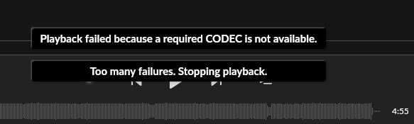

Hi Noris,
adding it as an Apple Home zone solved AirPlay problem with FLAC, but now appear this error for Mp3
Playback failed because a required CODEC is not available.
Too many failures. Stopping playback.
toomanyerror
Thanks a lot!
Hi All,
I solved the issue. Apologies – I hadn’t installed ffmpeg, but now that it’s installed, everything is working correctly.
Thanks a lot for the help!
