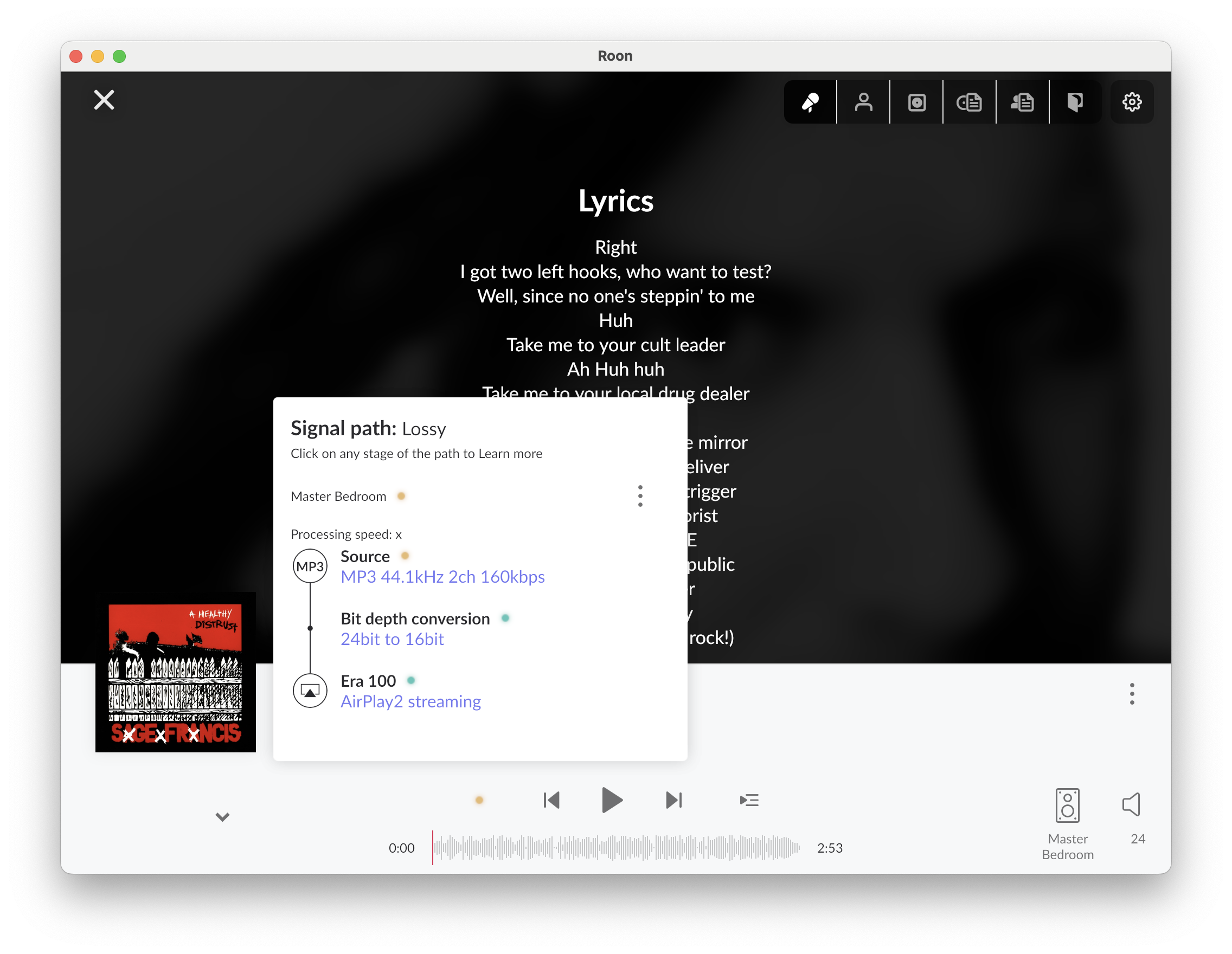

I Updated the roon firmware to the most recent build and the Airplay 2 continues to not work for Sonos Era 100s. Other sonos devices work over airplay after updating the roon software. The 100s can airplay from sources other than roon. This is a follow up post and I am hoping fix can be included for the next update.
Roon Core wired ethernet connection to router/modem. Sonos 100s are connected to the same network over wifi.
