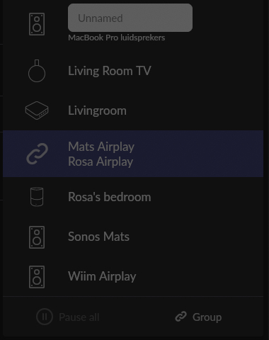

I have 2 Airplay devices (Sonos Move 2 and a Bluetooth Pulse M) and when I add them to a group I am unable to play any music on them.

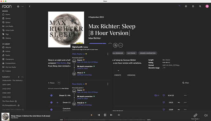

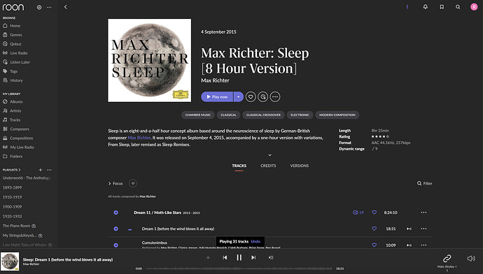

What I noticed past weeks was that playback on the Bluesound did start but not on the Sonos.
However, last couple of days even on the Bluesound the playback does not start.
This is shown in the screenshots it looks like playback started (showing the pause button) but it never actually starts.

I have 3 Airplay 2 devices
  1. Sonos Move 2
  2. Bluesound Pulse M
  3. Wiim Pro
I tried several combinations of groups and the Wiim Pro is the only one that starts playback. The Pulse and the Move don’t do any playback when placed in a group.
