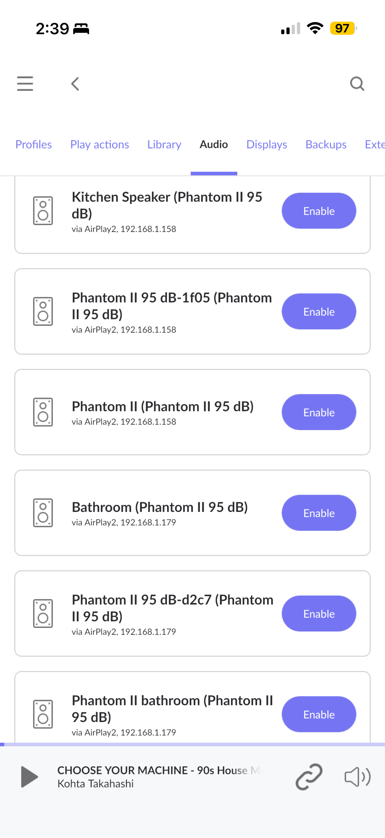

To add details: Roon Ready works great. I was hoping to setup AirPlay too so I can control via Apple Home and such.
Connection is unreliable. Cannot seem to detect my AirPlay speakers reliably. Also, the speakers seem to be detected multiple times.

Any idea why they show up so many times in the audio devices?
I (mostly) fixed it. Enabled IGMP proxy + snooping, and switched every speaker to 2.4GHz. Seems to be holding.
