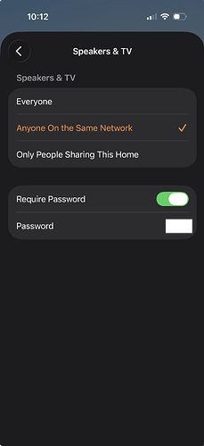

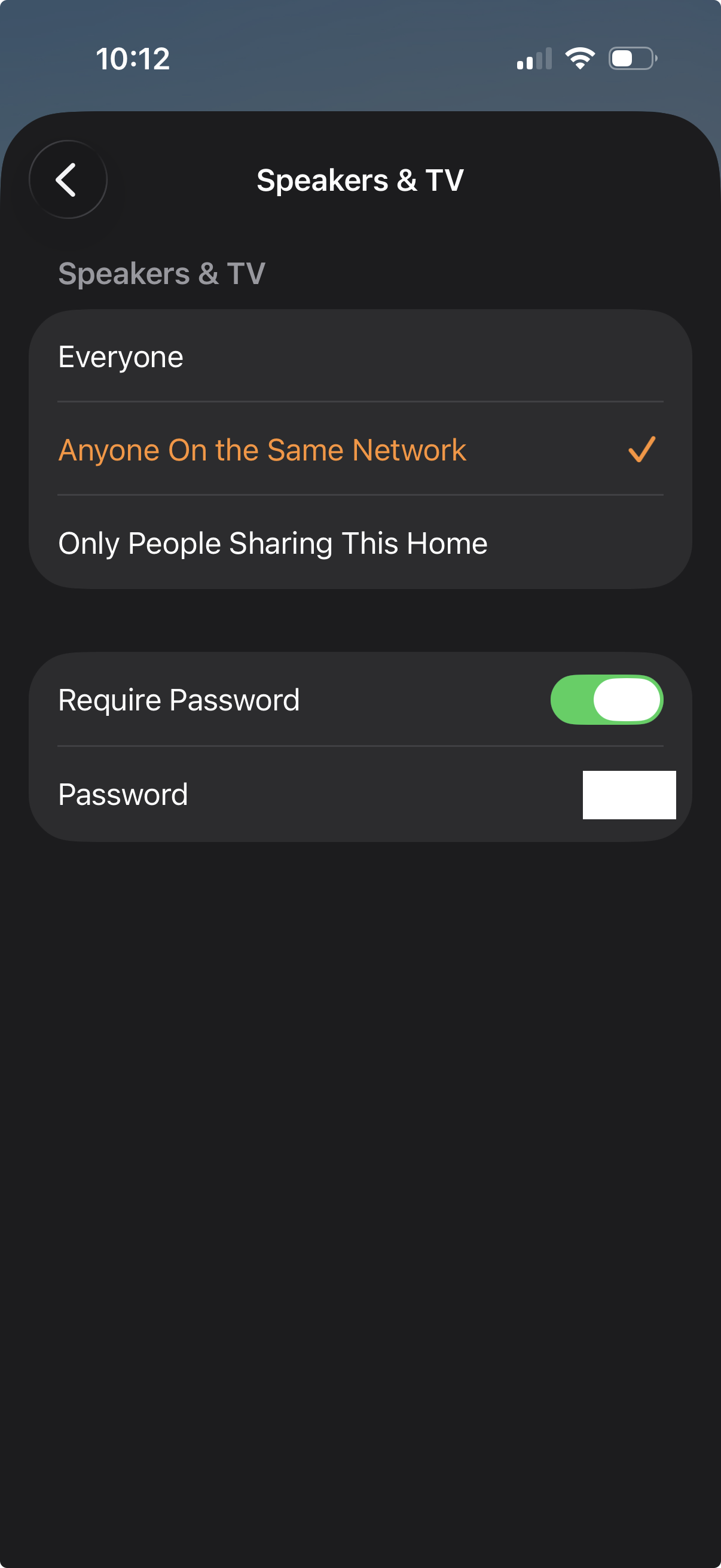

My Home settings are Anyone on the same network. I’ve tried with and without a code and the TV never shows the code given in the app.

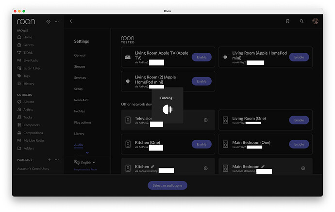

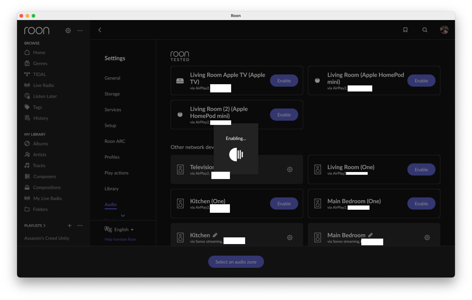

I built a Roon ROCK based system today - migrated my backup over and loaded. Tried adding the Airplay device, experiencing the same issue with a slight variation. After entering the Airplay pin Roon displays the Enabling popup indefinitely.
