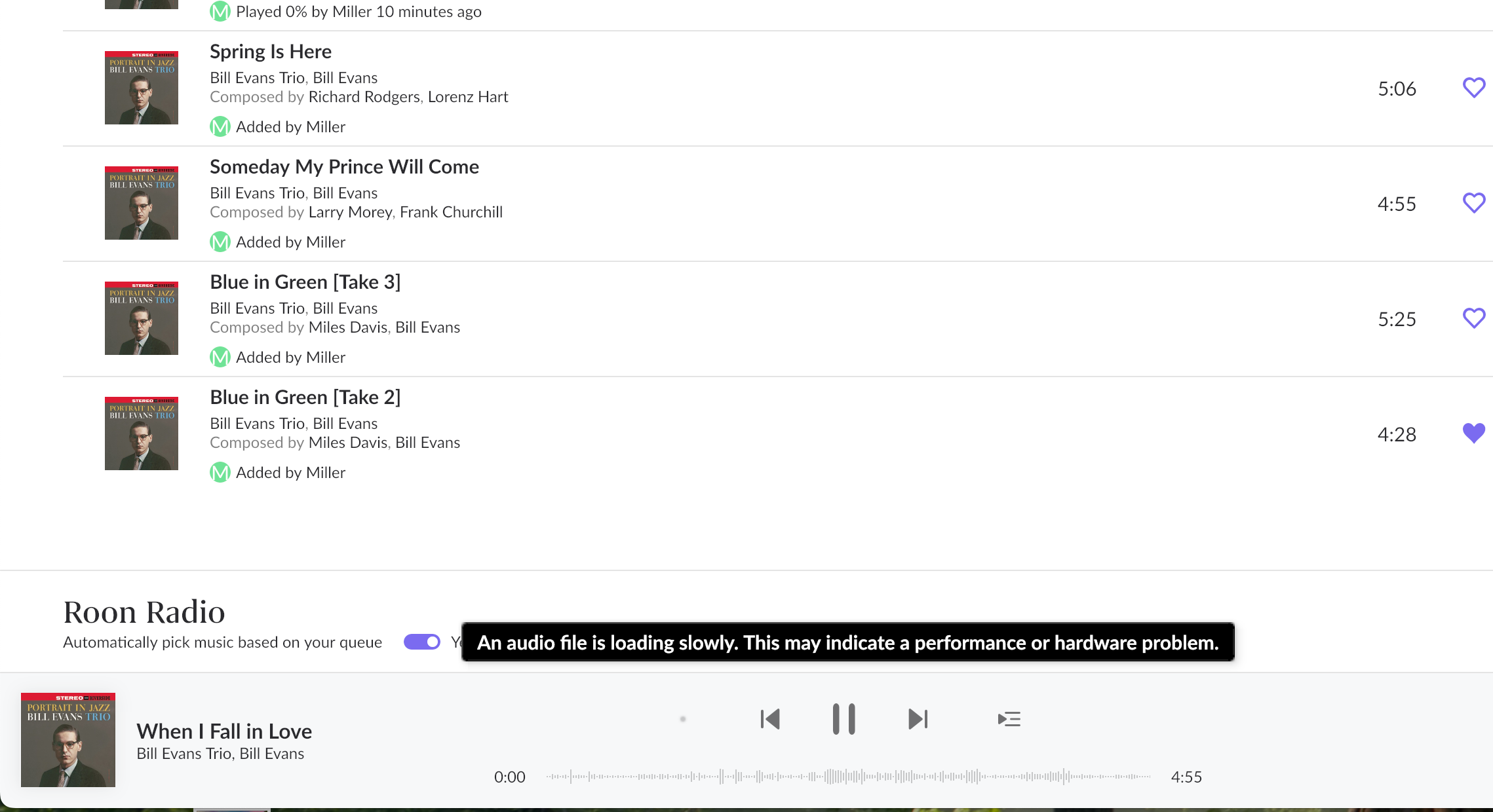

ALAC files skip after 3 seconds and produce "File loading slowly" error (ref#9R7FC8)

· Roon Server, running on MacOS Sequoia 15.7.2 (24G325). Playing locally via headphones. Playing over LAN makes no difference.
"File loading slowly" error message playing ALAC 44/16 from internal HD.
Stops after 3 seconds of playback, then skips to the next track. Nothing local plays successfully. Multiple albums tried. Roon is now unusable to me.

Hi Vadim, thanks for checking in.
However, your assessment is not correct. The iMac has no issue with its local hard drive. This is not a Mac hardware or software problem, it is an erroneous error message from Roon. Here’s what I did…
Restarting Roon Server, which runs on the iMac, made no difference.
There is no issue with the local disk drive and nothing in the system log suggests otherwise.
I was also able to demonstrate problems with Tidal Connect direct to the same Cambridge Audio EVO endpoint skipping tracks. That suggested the problem was with the CA.
The problems with Roon local files and with Tidal Connect were immediately abated by restarting the EVO 150, by power cycling it. The problems have not recurred.
So this was in fact an endpoint problem, misreported by Roon as a file loading slowly error, which was not the case.
I can’t reproduce the issue on demand, so I’ll just have to see if it happens again in the future.
