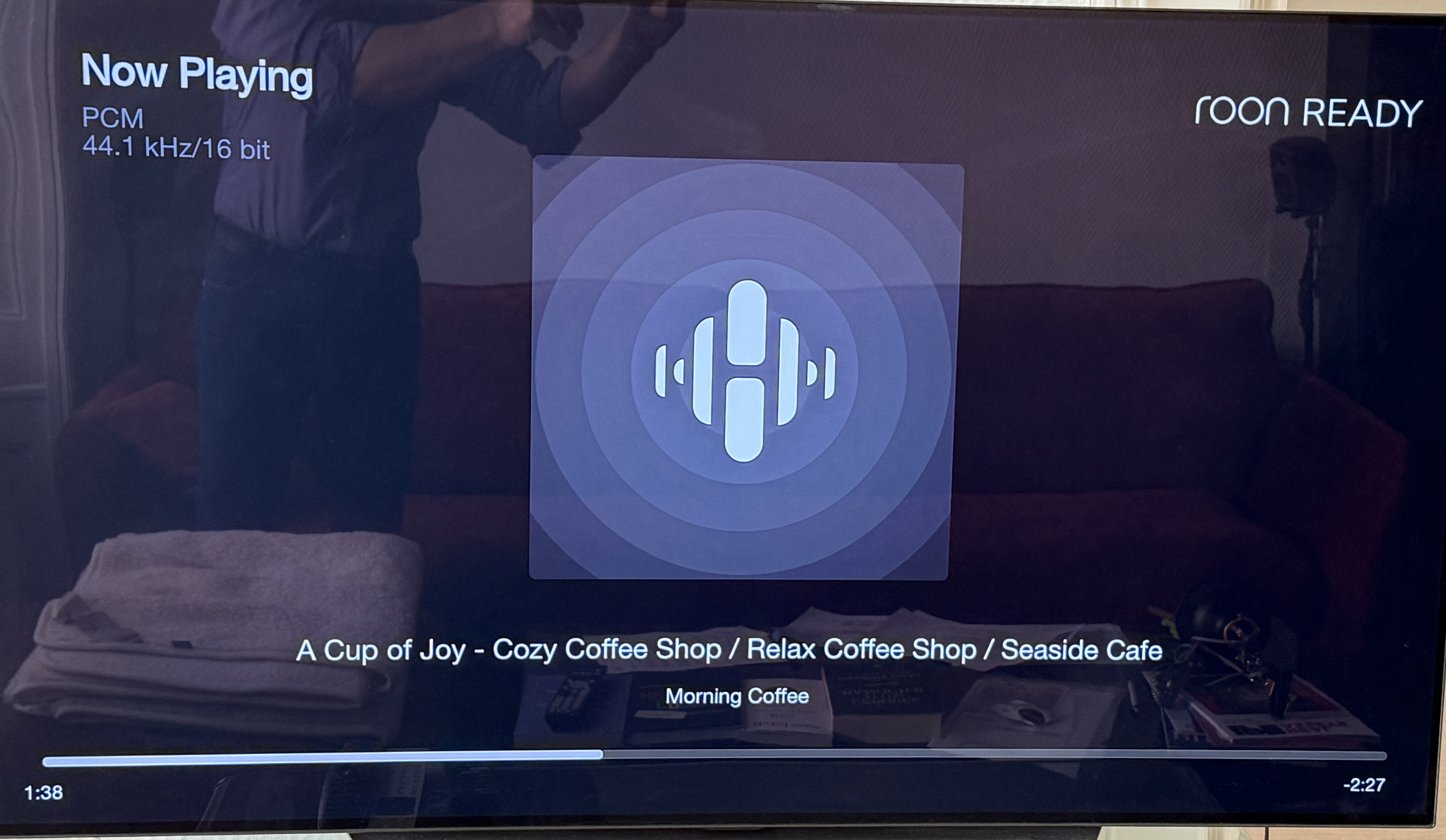

· The Album Art does not display on the TV screen.Everything else works (music playing, Album name, etc.). Is it a bug ?
Any help would be greatly appreciated!

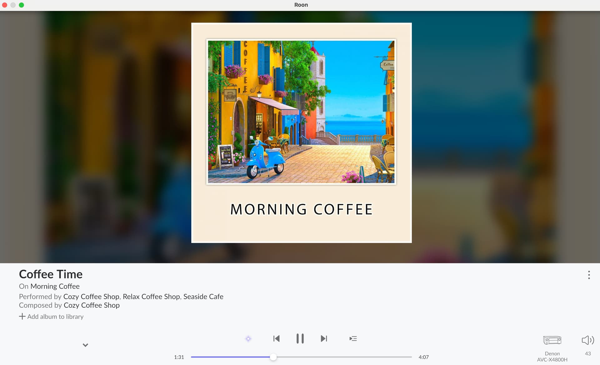

Thank you for looking at this! It is a standard album from Qobuz. Please note that the album’s cover art shows up fine on the Roon app on the Macbook I use as remote.
Let me add, for the sake of clarity, that this problem occurs for any album played on Roon. The one shown here is just an example to illustrate the problem.

Hi @benjamin! and THANK YOU for making the effort to look into this and reply. Indeed, I confirm that the Album art WAS accurately displayed UNTIL RECENTLY. Somehow it stopped a few weeks ago. This is just strange.
