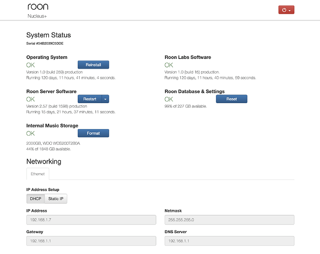

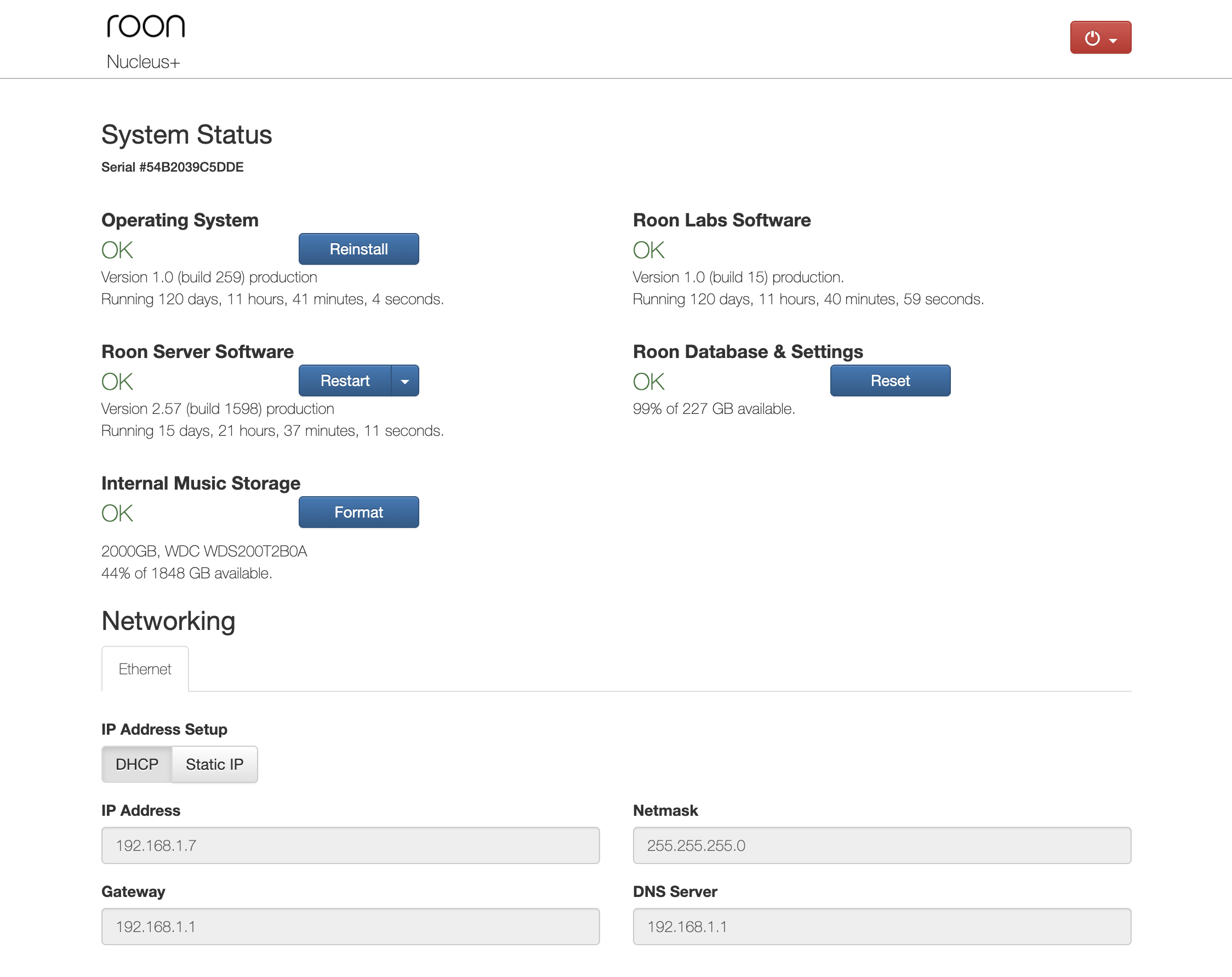

Can you please share a screenshot of the Nucleus Web admin page?

Here’s the main page of the server….

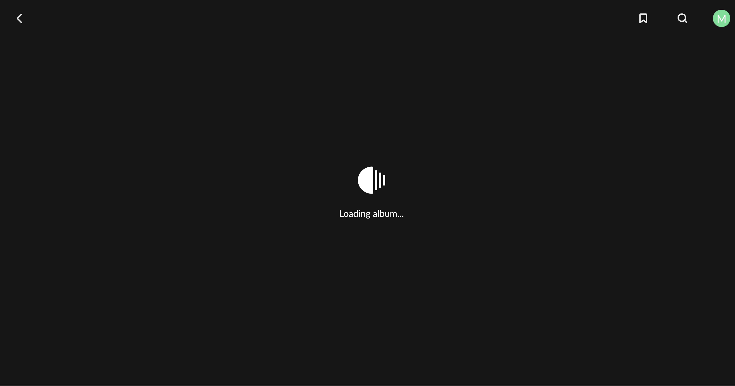

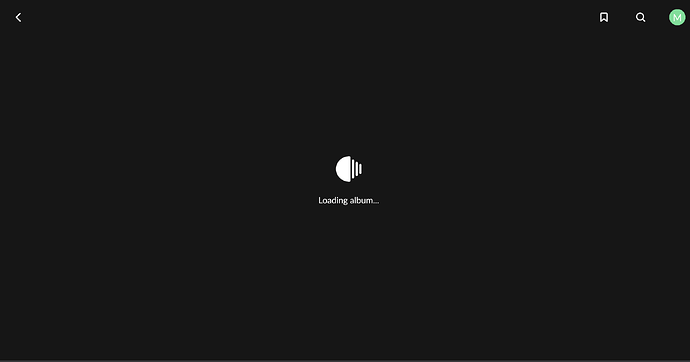

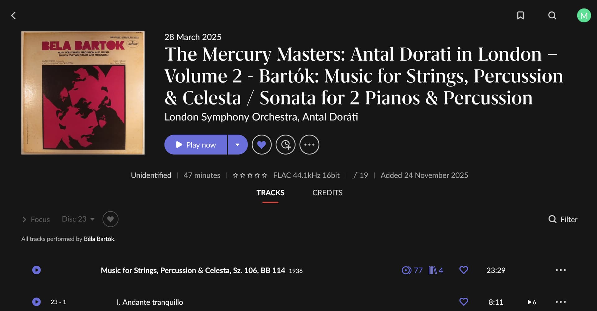

OK… rebooted Roon Server at 6:41 AM today (Dec 31 MST)
Loaded one album for a playlist with no issue. Second album hung at 6:42:30 and stalled for approx 30 seconds.
I’ve attached a screen shot of the stalled screen and the album info when it finally appeared.
Hope this is helpful. I get this behavior every day. It does not happen on Tidal, only local music.
