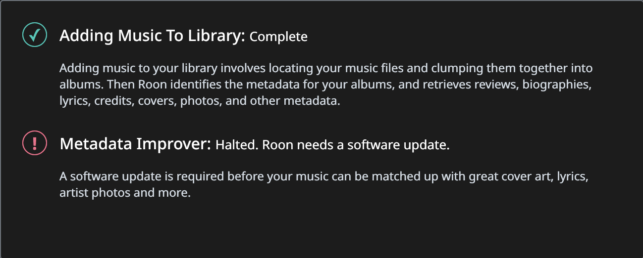

Hi ev’ryone! Got this constant problem: after working/playing for a while ROON hangs/stucks on task of identifying album. Only ROCK reboot helps, sometimes not from the first attempt. ROCK is on Intel NUC i5 10th gen. Connected by Ethernet to router and NAS. My internet account allows 200 Mb/s stable connection 24/7.
I’ve read here about some problems cured temporarily by reboot, but are there another more permanent cure?

Are you getting any error messages? Is there a spinner in the upper-right?

Hello @Mikhail_Shklyarenko, so if you reboot, the metadata improver message goes away. How long until it returns? Also, is that a managed switch? If you connect the core directly to the router?
Hi! Well, yes, after rebooting message goes away and ev’rything works properly for a while. Didn’t measured for how long. Maybe an album or two… Something between minutes and hours. Can’t say precisely.
