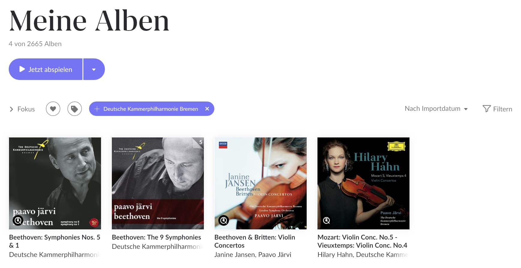

A filter using focus: artist/main performer “Deutsche Kammerphilharmonie Bremen”.
Bookmark created.

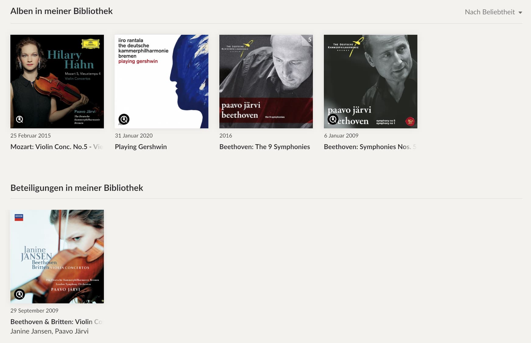

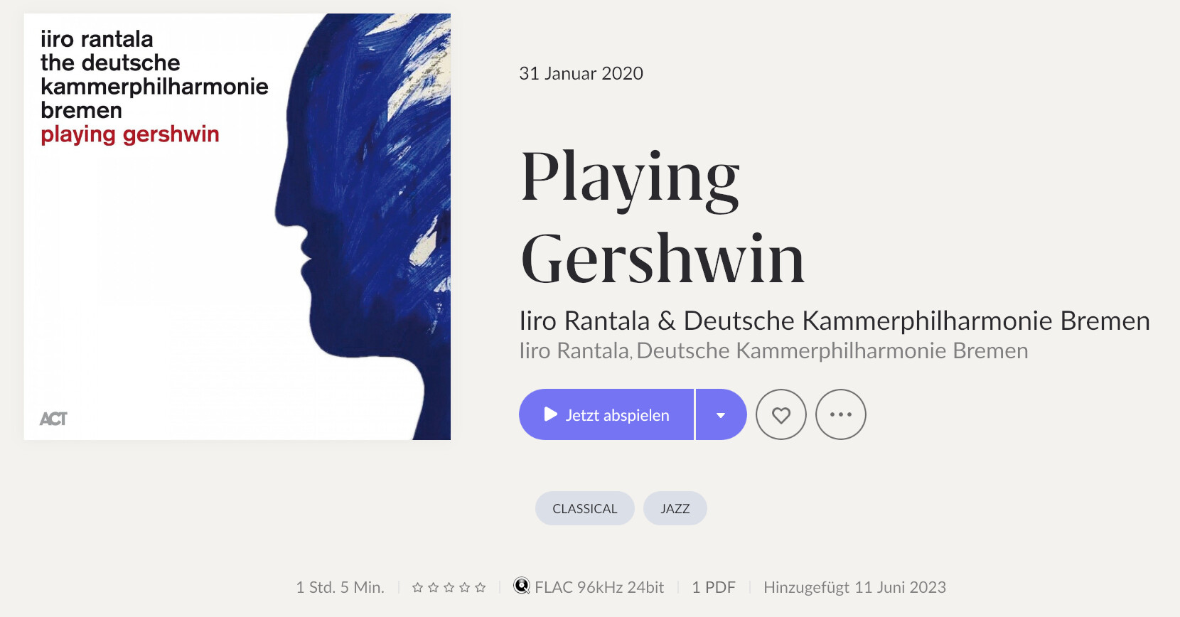

But in my library is also another album where the DKB is the main performer:

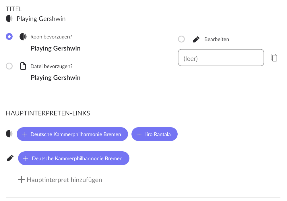

I checked why that album (Iiro Rantala & DKB) does not appear in the focus/bookmark.
The metadata seems to be OK, nevertheless I added DKB as a main artist a second time:
Now this all looks OK, but the album dioes not appear in the bookmark.
WHY? :slight_smile:

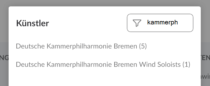

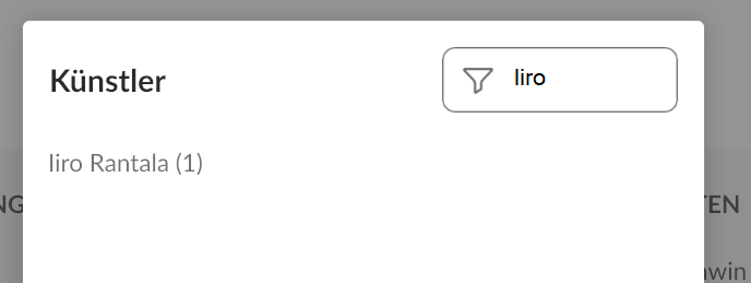

I can’t immediately see what’s wrong here. Maybe you have two different entries for Deutsche Kammerphilharmonie Bremen? This happened to me a few times.
You can check under your artists.
There’s just one artis entry in the database:
In the album, the DKB and the soloist Iiro Rantala are separate entries so everything should work…

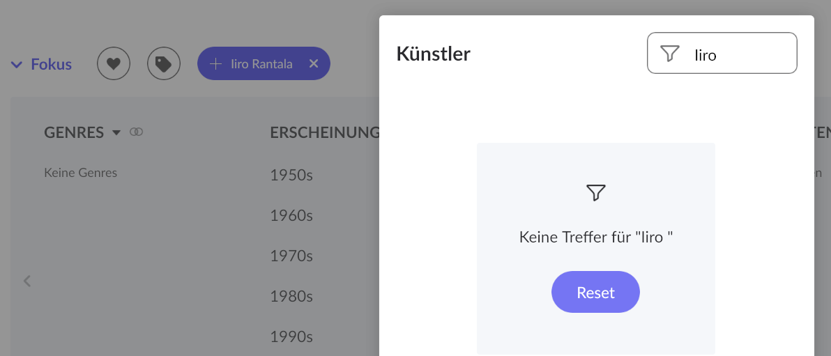

Quite interestingly, the soloist appears in the database (rightly so), …
BUT the filter does not work. It looks strange :frowning:

And: when I use the top/right search function (not focus) and type “deutsche kammer…” the in “my albums” all albums appear (correct), including the one that does not appear in focus. I’m confused :slight_smile:

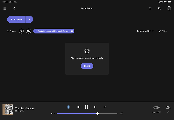

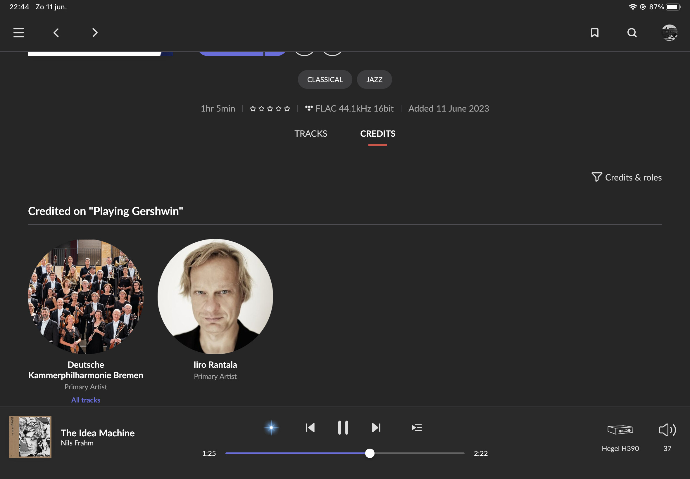

Is the Kammerphilharmonie credited as a performer in the metadata of the Gershwin album? Who are credited on this album?
A focus doesn’t look at album artists but at performers.

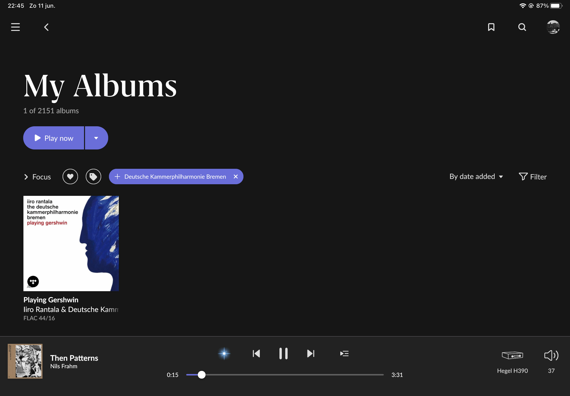

Addition:
I added the album to my library. First it only had the Kammerphilharmonie as a primary artist, which seems to be the same as album artist.
Focussing on the Kammerphilharmonie didn’t yield any results.
Then I edited the album credits, and added the role of performer to the Kammerphilharmonie. Then it did show up in the focus.
The conclusion here is: a focus on performers does not look at album artists, which is quite odd, I must say. You would expect otherwise.
