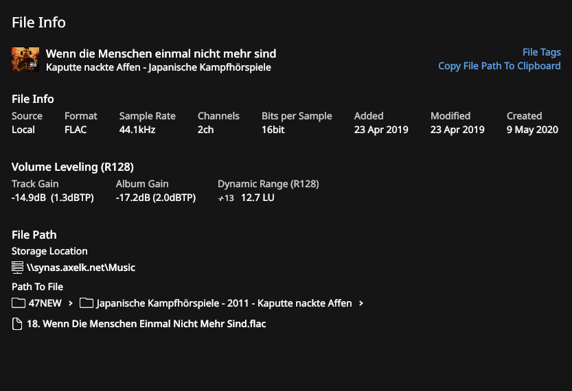

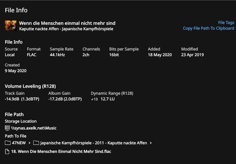

Now I see some (not all) albums two times. When I try to play the same song from each occurrence, one will be played. The other is skipped with the short notice “playback was interrupted because the track failed to load”. I checked for differences and can spot that there are different play counts and the ‘added’ date differs. And the ‘Like’ can only be seen on one of them. Looks like there are now two albums pointing to the same files. I wouldn’t care so much when both would be played. But I can never be sure if I choose the right tracks from the playable album.
To illustrate that these are in fact the same files which are accessed I add screen shots from the file info of one affected song.

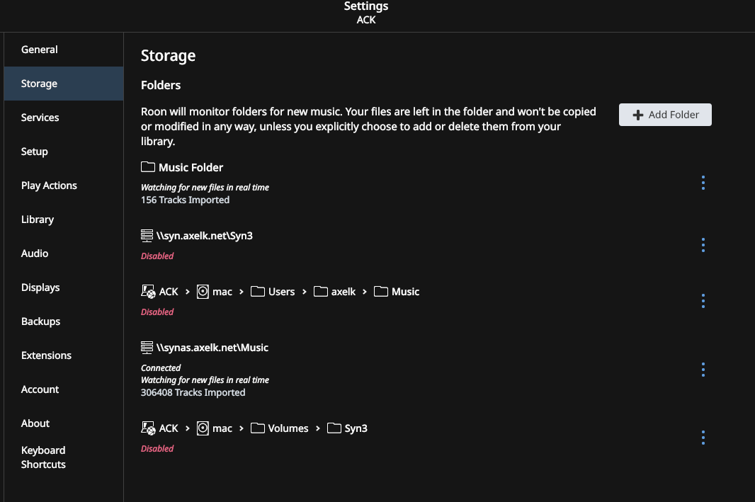

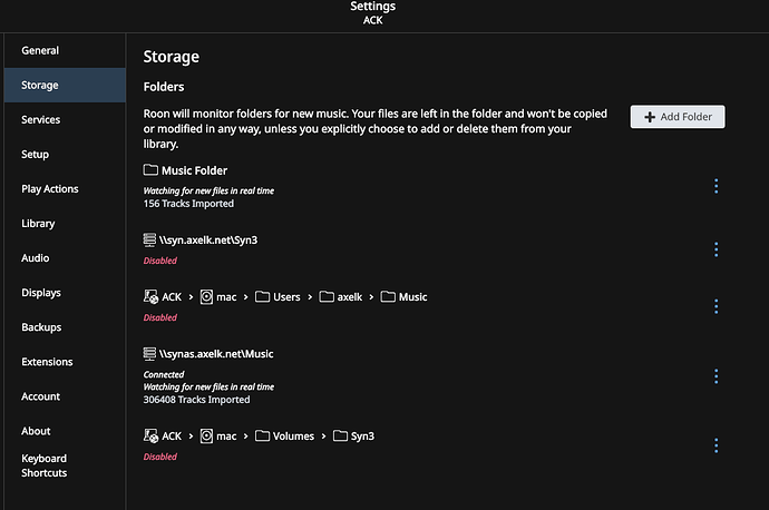

Can you share a screenshot of Settings > Storage?
of course :slight_smile:
the disabled connections are the old ones to the other NAS. And the one at the bottom is very old.

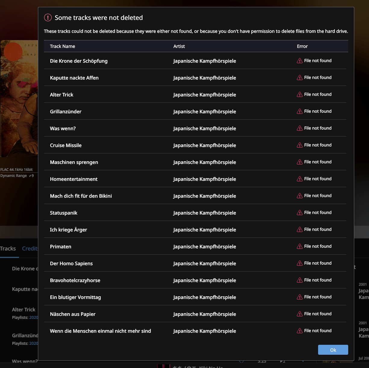

What happens if you try to delete the ghost album in Roon? Can you give this a try and, assuming it fails, let me know the time that you try to do this? I’ll have the team take a look at the diagnostics report during this time.
Before doing this, you might want to make an extra copy of the files outside of your watched folder, just to be safe.
Hi @dylan,
just done a minute ago around 16:02 German time (6 hours ahead of NY time).

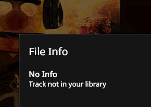

What I get is this (yes … the files do not exist):
At least I am not able to view the file info anymore.!
