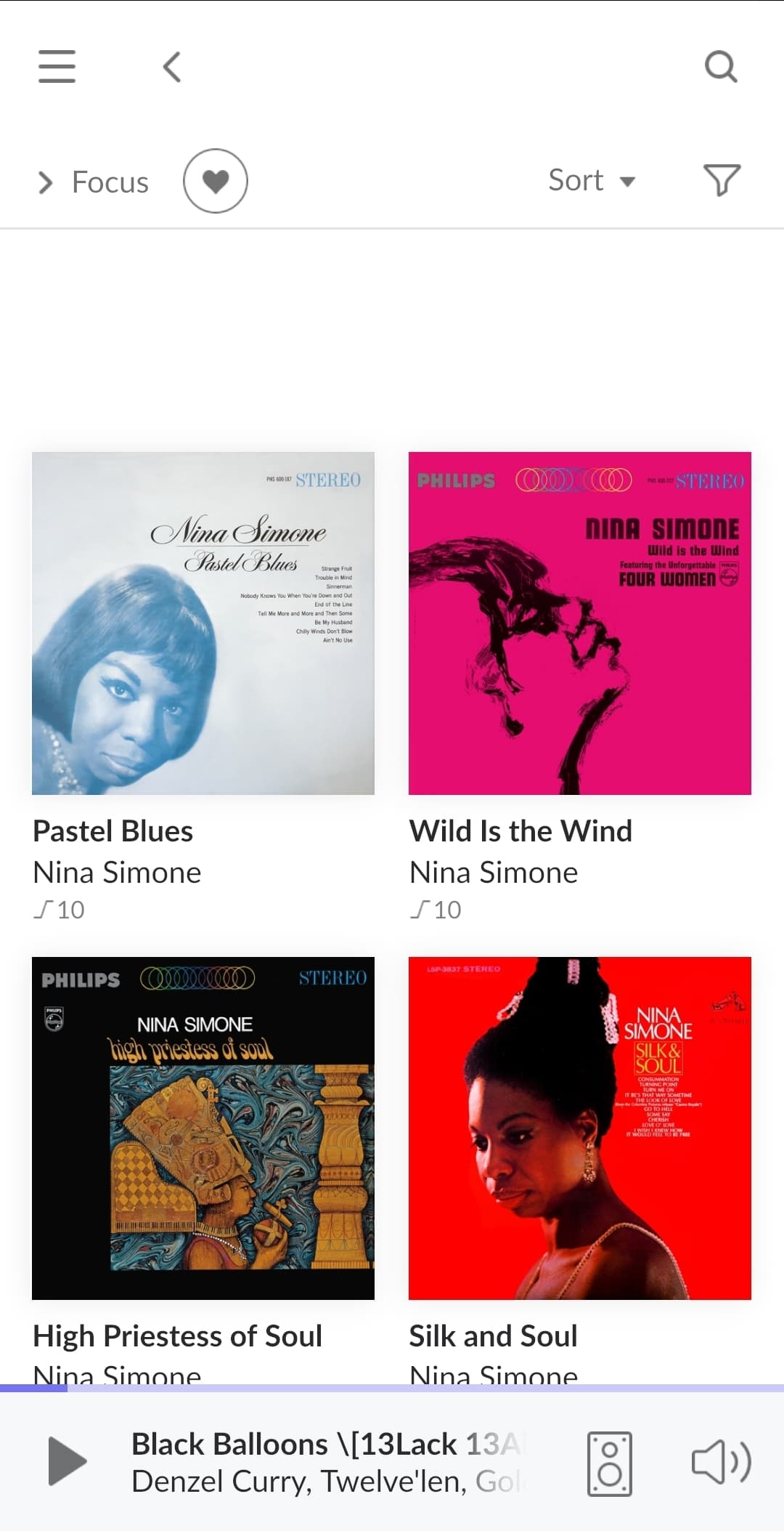

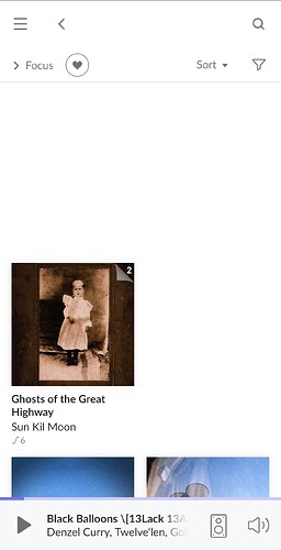

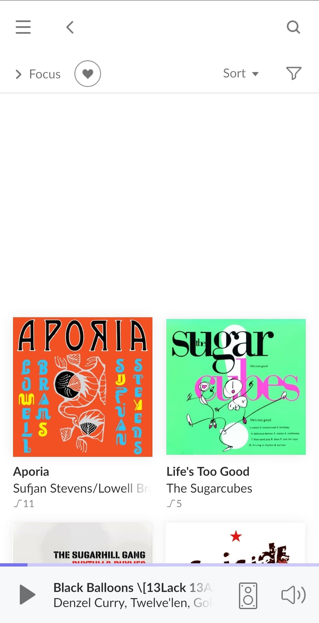

When scrolling through albums on my S23 Ultra, what I’m able to see reduces as I get further down the list. This starts at around the letter K or L, and keeps reducing the further down I go. By the time I’m three quarters down it becomes almost impossible to use. I have recently changed phones from a Samsung Note Ultra which had a similar issue, and subsequently upgraded from using my laptop with external storage to the Nucleus, but with each combination the issue persists. I’ve seen a similar issue raised last year but the topic was locked out after a 45 day stint with no updates. Can anyone help? (Images below showing what I see)

To me, it looks like some of the albums are just not rendering. That could indicate a lot of different issues, and @support can look at things behind the scenes. If I had to guess, it could be in this list, a network connectivity issue or a memory issue.
