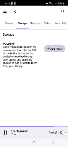

Also, please attach a screenshot of Settings → Storage so we can take a closer look.

This is a screen shot of ‘Settings → Storage’ on my Samsung A55

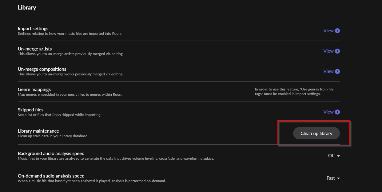

  2. Go to the Roon settings → Library page and click Clean Up Library
  3. Clean up the files shown

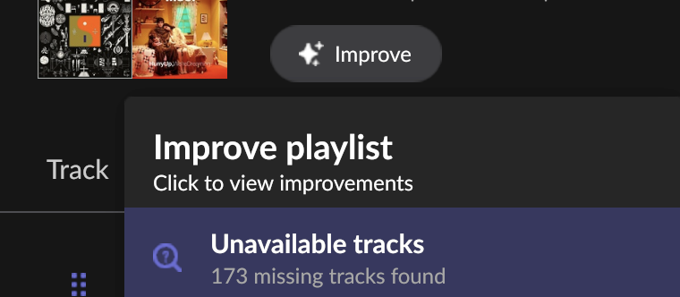

Some playlists are still not complete. If you also have a solution for that, that will be wonderfull.

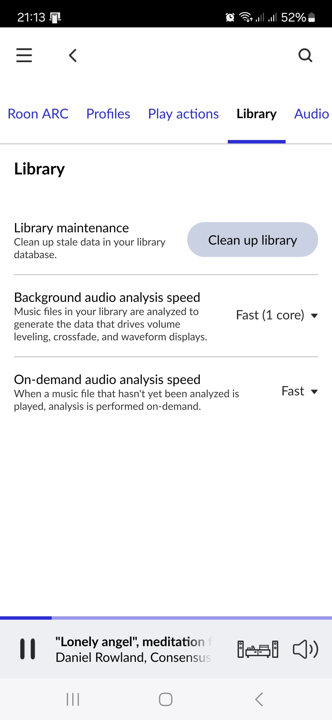

My Library page screen looks very different. See this screen shot

Are they playlists you’ve created in Qobuz, or in Roon directly? Can you be a bit more specific around the issues you’re having with them? If youre missing tracks, can you use the playlist improver button at the top of the playlist to find+replace the missing tracks?
This is because you’re using the Roon mobile app, and @daniel shared a screenshot from the Roon remote app on a Mac/Windows machine. :slightly_smiling_face:
