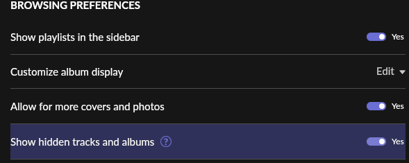

To confirm, do you have ‘Show hidden tracks and albums’ enabled?
If you navigate to Roon Settings>Library>Skipped files, do you see your missing files there?
Screenshot 2025-02-18 at 15.25.16
Hello
No, the files are not in the skipped files.
And show hidden tracks is enabled.

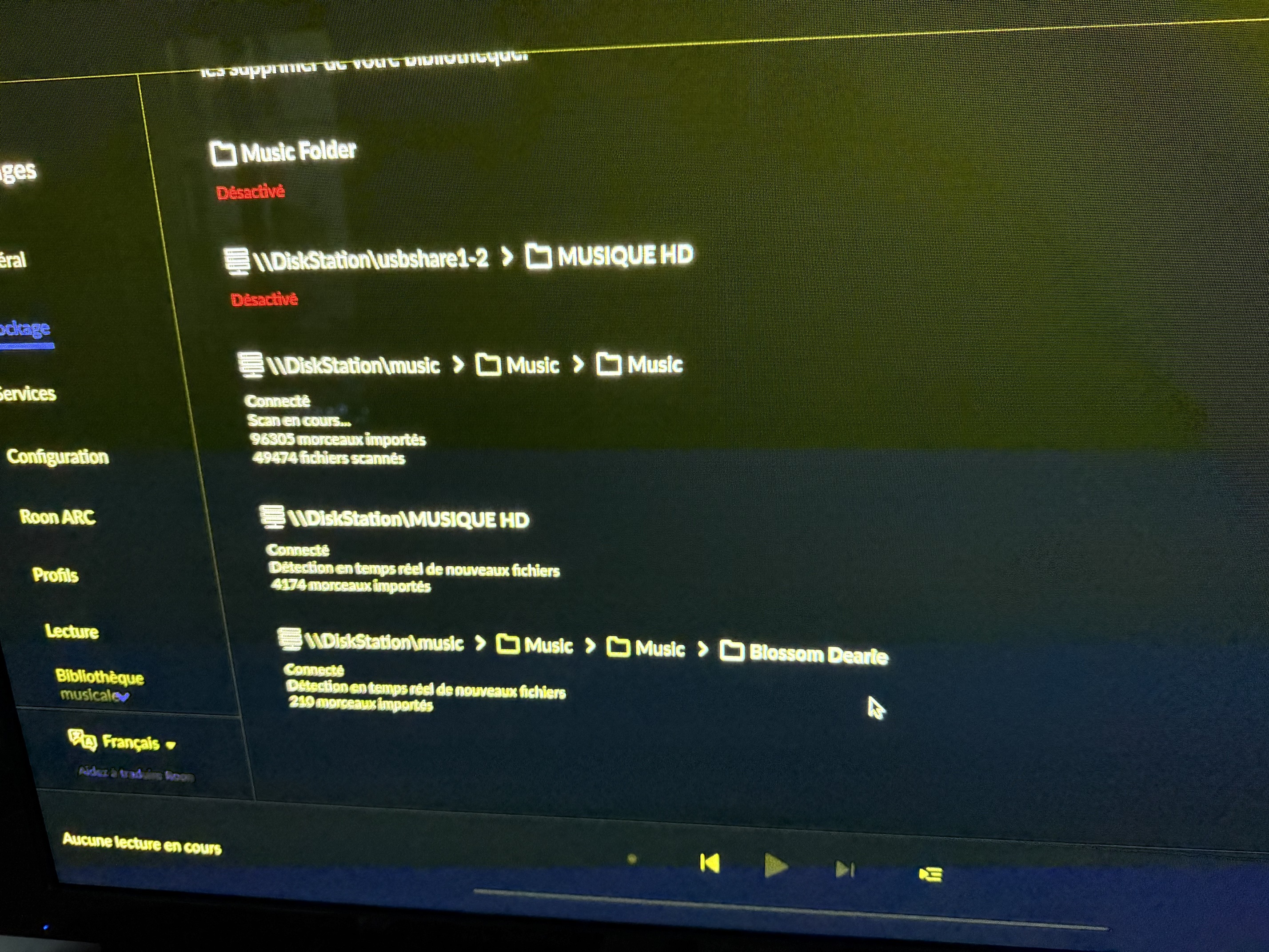

Thanks for giving that a review! Could you please share a screenshot of your Roon Settings>Storage?
Can you not bypass the hub with your Nas, and connect the Nas directly to your router? We’re seeing repeating network-related failures that could be pointing to a larger issue around network connection that may be leading to your tracks not properly importing.
Can you provide more information around this?
I’ve connected the NAS direct to my router and the issue is the same : the same albums appear for a few minutes, following a new scan, I’m able to play them, then they disappear again, the music stops and the message « this album has been erased « appears. I have sen see this message appear from time to time turning on my screen in the past months, though I never erase any album.
Regarding the Blossom Dearie albums, I created a path towards the directory of these albums in the storage menu (« Stockage » in French). See photo. All of them has not reappeared though.

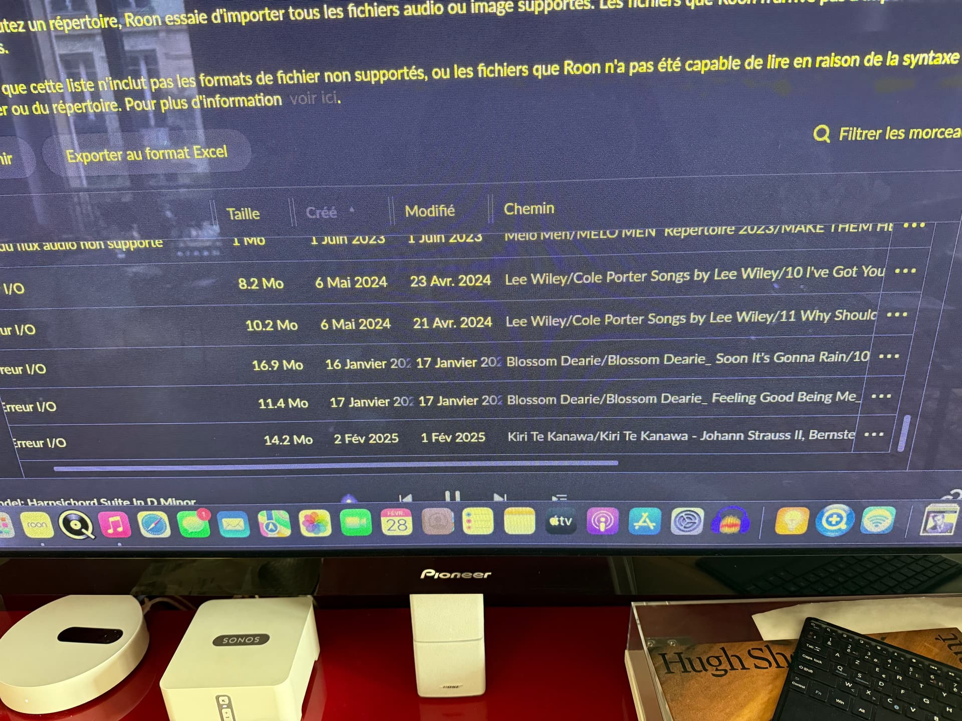

Processing: IMG_1326.jpeg…
Hello
In fact the firewall is already disablesB
The skipped file are very few (see photo), and only one from the several Te Kanawa albums who disappear.
