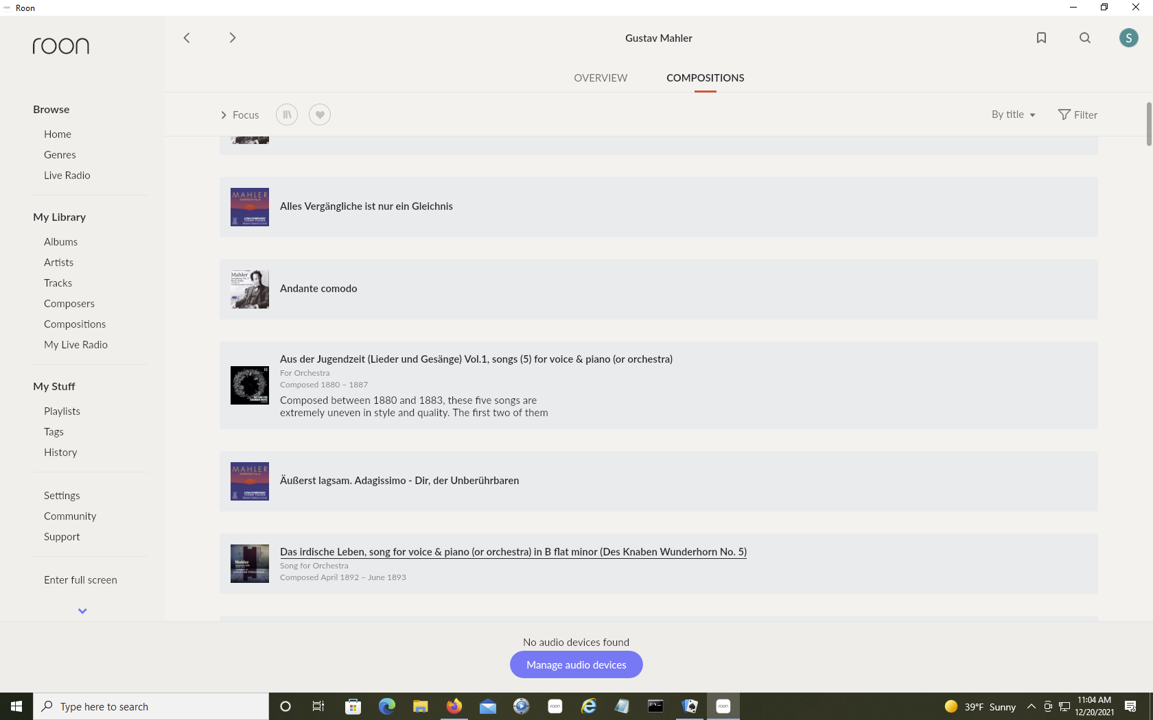

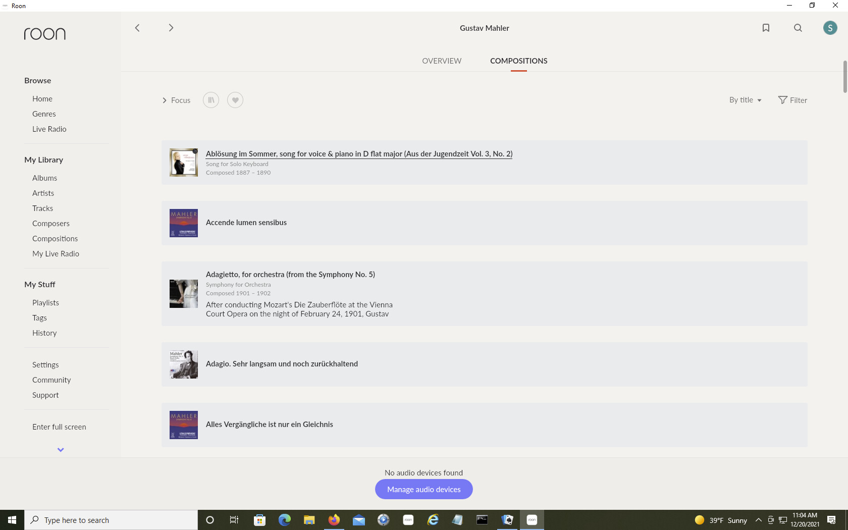

Hi Steven, I am a bit confused but I understand that the albums are there (good sign) but it looks like you are having metadata related issues. If you can see the albums some way, can you click on one of the albums.
For illustration, this is what I see when I select either the Das Lied von der Erde SACD (which I initially bought individually) or the Klemeprer SACD boxset (different art). You will not see the same details unless you have customised them so don’t worry if your albums screen is different.
Can youi also take a screenshot of what appears when you select the “Compositions” field rather than the “Overview” field under Gustav Mahler (as a general rule if you are looking for your recordings of a specific work, using that window under the composer will be much easier especially for a composer like Mahler who composer a more limied number of compositions), For example I get:
Compositions are listed alphabetically. If I then scroll down to Symphony No.1 and click on that composition, then the following creen appears (listed to show all appearance of the work whether complete or not (you can set that by clicking on the down arrow next to “Recordings by album” under the “All recordings” section in the lower part of the screen
and then of course when on the indivdual composition screen, check whether your album appears on the list identified by Roon as containing that work

I’d like to point out that movements are listed as individual works which add an immense amount of clutter. After finding this long ago I wrote off this search method as unworkable since there was so much irrelevant material listed.
