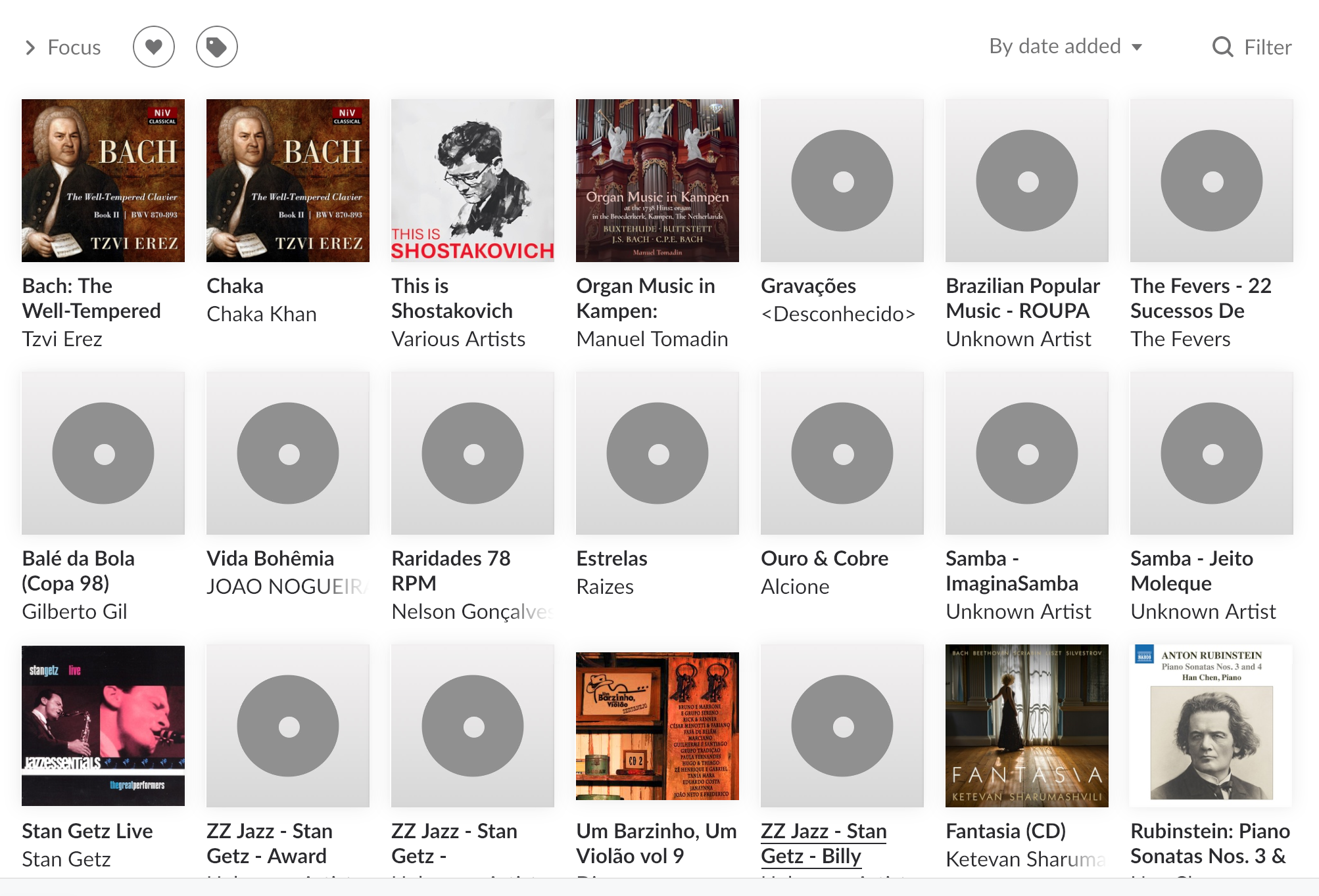

· In the last 2 or so days, I believe since your most recent update, my albums don't sort by the date they were loaded and the album covers seem to have been screwed up. I installed the backup before it began to happen and then the one before that, to no avail. Restarting the server software did not resolve the issue.
· Router is Vodafone supplied. Music is stored on a Synology server, RoonOS on a NUC. I have Linksys switch and an ASUS router configured as a swithc to povide better quality Wifi to my high end Auralic stack. The mixed up display occurs on both my Mac and my iPhone. Music is playing normally. It has been working for years.

As I scroll down, I see it is just a few albums that are showing at the top of the date sort that should not be there. Once I scroll past those, the files are as I would expect them to be.
I checked the folder for the Chaka Khan album that shows the wrong image, and the folder contains the correct image, not that of the Bach album next to it in the image I sent you.

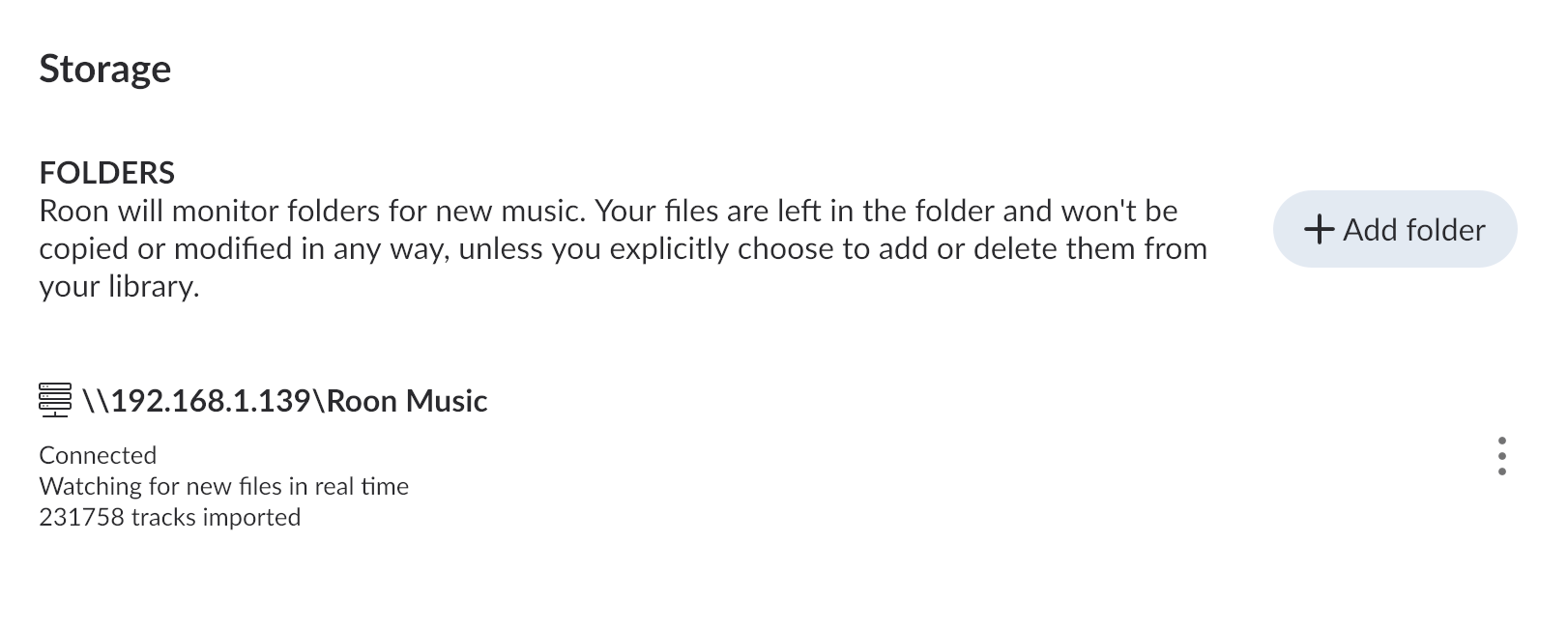

Hey @Richard_Presser,
My apologies, this setting is in Roon Settings > Setup.
With that, could you also share a screenshot of your Roon Settings > Storage?
Thank you!
Clearing the image cache resolved the incorrect cover issue. Below shows the Storage screen.
