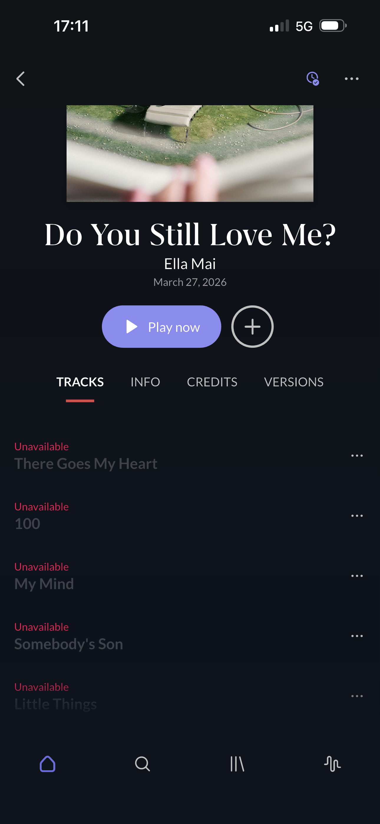

· After the latest update a lot of albums show but are unavailable to play

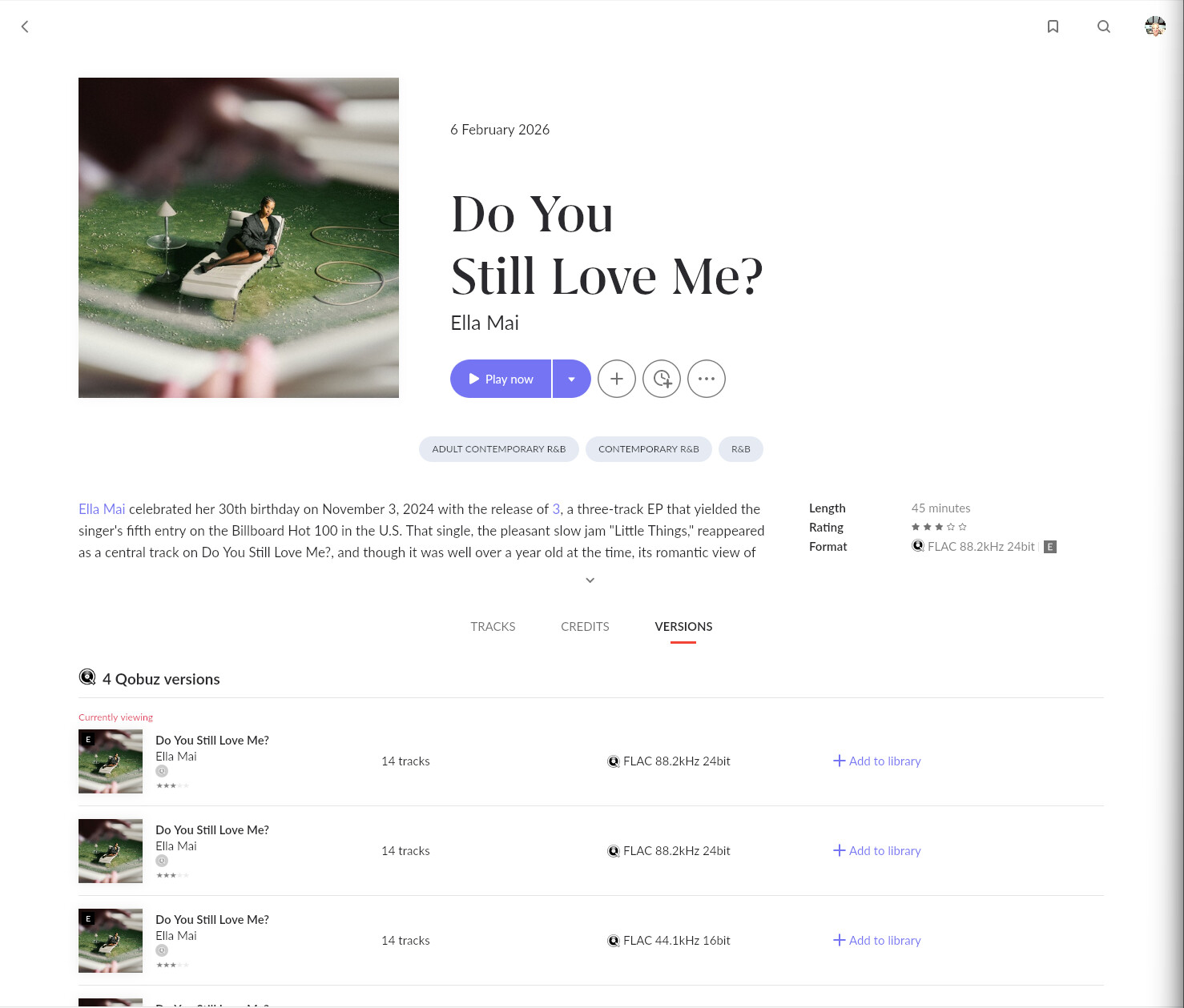

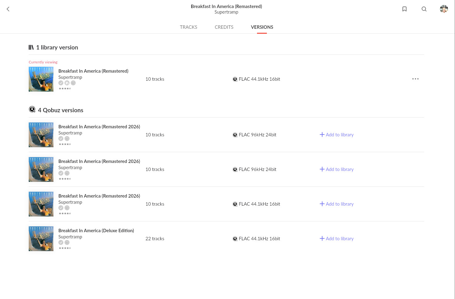

This may be being caused by Qobuz changing the versions of the album because of licensing changes from the record label. There is a version that is available in Qobuz:

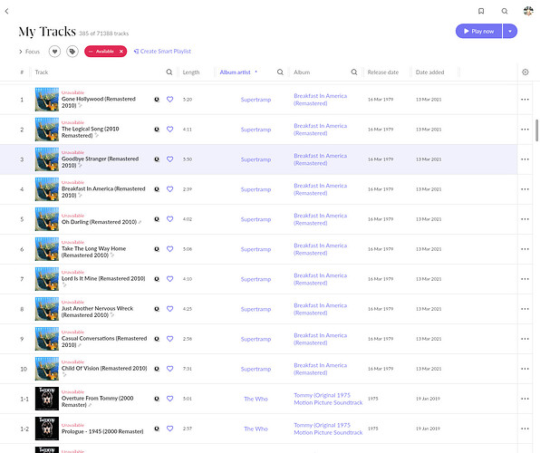

A tip: you can find these changes by using the Track browser and looking for Unavailable tracks, then go to the album and use the Versions tab to see if there is a replacement album…
Hey @Richard_van_Enteren,
Thanks for sharing your report! @Geoff_Coupe is spot on with the above reply, let us know if this is the case, or if you’re experiencing larger groups of now-unavailable albums.
We’ll be on monitoring for your reply, thank you! :folded_hands:

Distribution changes with the streaming service catalog itself cause the vast majority of sudden “unavailable” messages on a library streaming service album. This means Qobuz has either lost the rights to the album entirely or replaced it with a new object from a different distributor (this might also entail format changes). In either case, this means the original album is unavailable in Roon. If no other versions are available, then Qobuz lost the rights entirely.
The most immediate test would be to see if the Qobuz web player itself still has the same album. Let us know if that is the case. Please note this thread will auto-close after another day of inactivity.
