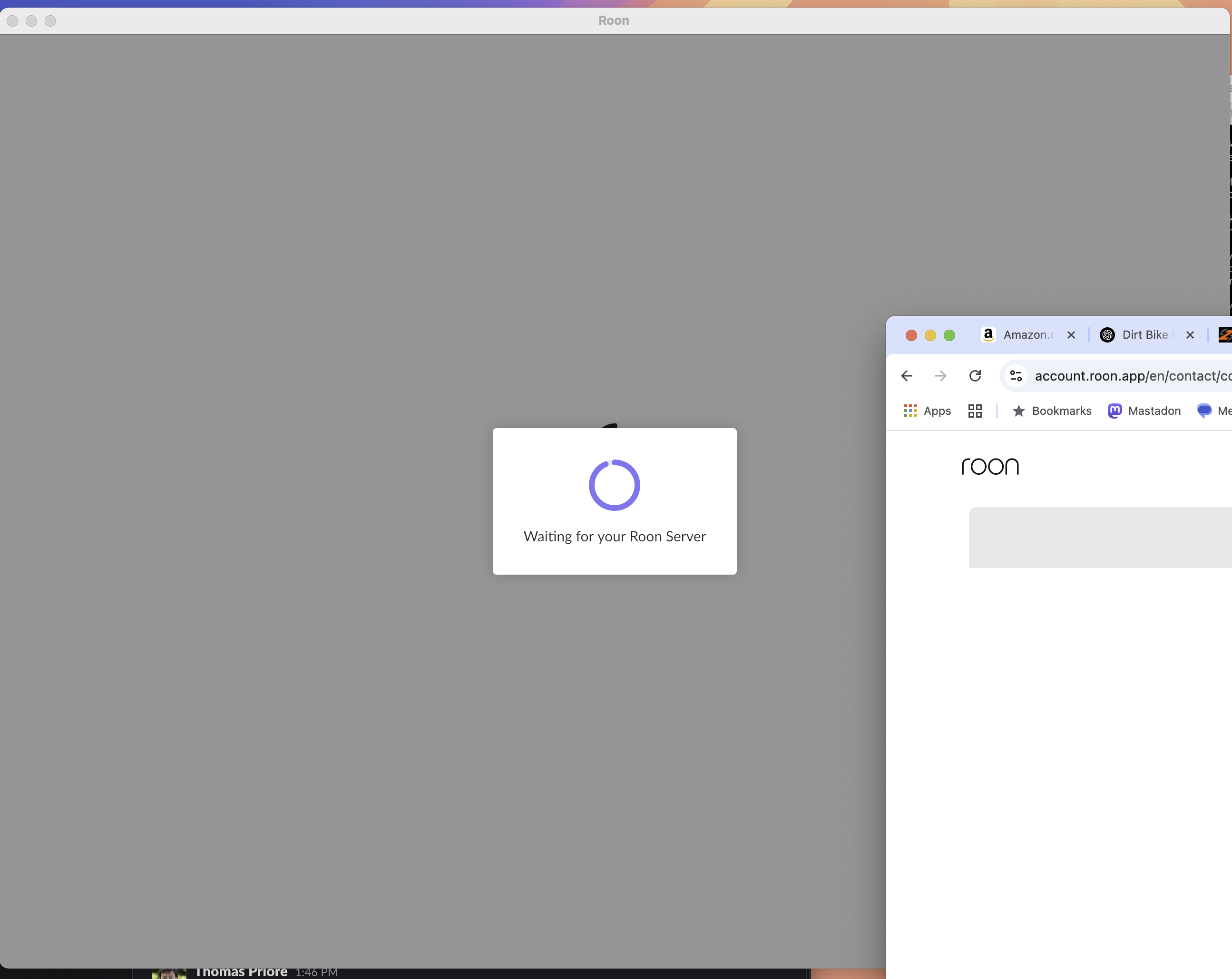

All Clients "Waiting for your Roon Server" Error (ref#48W11O)

Sorry the roon support site didnt let me enter enough info. I’m running roon server on ubuntu. I have clients on windows, osx, and andiod they all cycle through the roon logo and “Waiting for your Roon Server”
I’ve reinstalled the server. I’ve reinstalled the clients. On the android client it asked me to log in, then it found the server on my network but it still cycles.
I turned the firewall off on ubuntu. I can SSH to that server fine.
The Roon server logs don’t show anything about a connection attempt:
