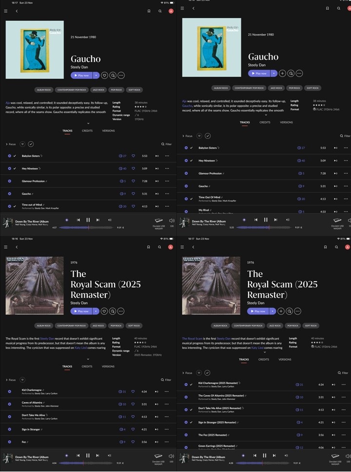

Allmusic track picks missing for some library albums. The image shows 2 albums purchased from Qobuz. The left side shows the library version of the albums and the right side the Qobuz version. The library versions are both indentified and the Qobuz versions are listed under versions. The library version of 'Gaucho' does have the allmusic track picks but 'The Royal Scam' does not. Why? I have other instances in my library where this occurs.

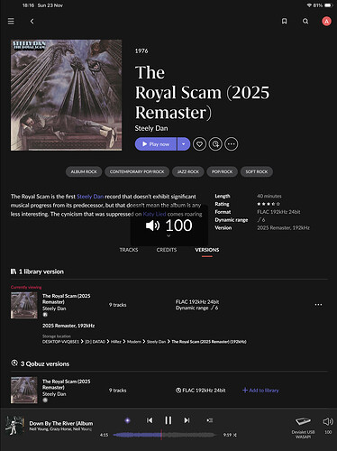

Hello Vadim, The library version that was downloaded from Qobuz has the Qobuz version (that has track picks) listed as an alternative version so doesn’t that mean the library version matches with that Qobuz version and hence should have the track picks too? Otherwise why would it be in listed with the versions of this album (see attached photo). There is no other version of this album to identify with.

I changed it to the second match in the manual identification process and now it shows track picks. That should not happen, really. The track lengths are all the same in each, and it is definitely showing the same TiVo capsule review in each case.

I have done that. It is the first thing I try when an album doesn’t identify properly. The Steely Dan album ‘The Royal Scam (2025 Remaster)’ is identified and the equivalent Qobuz version is listed as an alternative version to my library version, purchased from Qobuz, but no track picks for mine though the Qobuz version does have them. I tried re-identifying the album but the Qobuz version doesn’t appear in the 7 possible versions available to select. How’s that possible? Roon has identified my library version with the Qobuz version but the Qobuz version is not in the list of possible versions! I have been slowly going through my unidentified albums, some I have managed to fix but others refuse to be. I understand that Roon relies on external sources for this task MusicBrainz being one of them. I have found that some of my Qobuz purchases are not in these databases so they are not identified and hence not identifed with the Qobuz version. Surely as a subscriber to Qobuz an album not in the external music databases should at least identify with the Qobuz version. As I said some more detailed insight into the identification algorithm would help people resolve unidentified albums.
