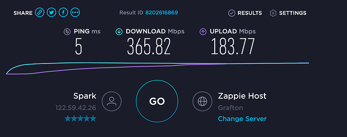

A typical speedtest shows very good internet speeds, this is over wifi:
Our network hardware is Ubiquity Edgerouter-X using hardware offloading, wifi is Unifi AC lite access points.
The Allo USBridge is connected via ethernet cable to the router.
The Roon Appliance is running on a Windows 10 box which is also running a Plex Server. CPU loads never seem to be an issue. The Windows 10 box has two connections to the router, one is AC wifi which has similar speeds to the screenshot above, and the other is powerline networking which is slower but still maintains the same iPerf transfer rates. It doesn’t seem to matter which of the two are connected, the dropouts occur.
