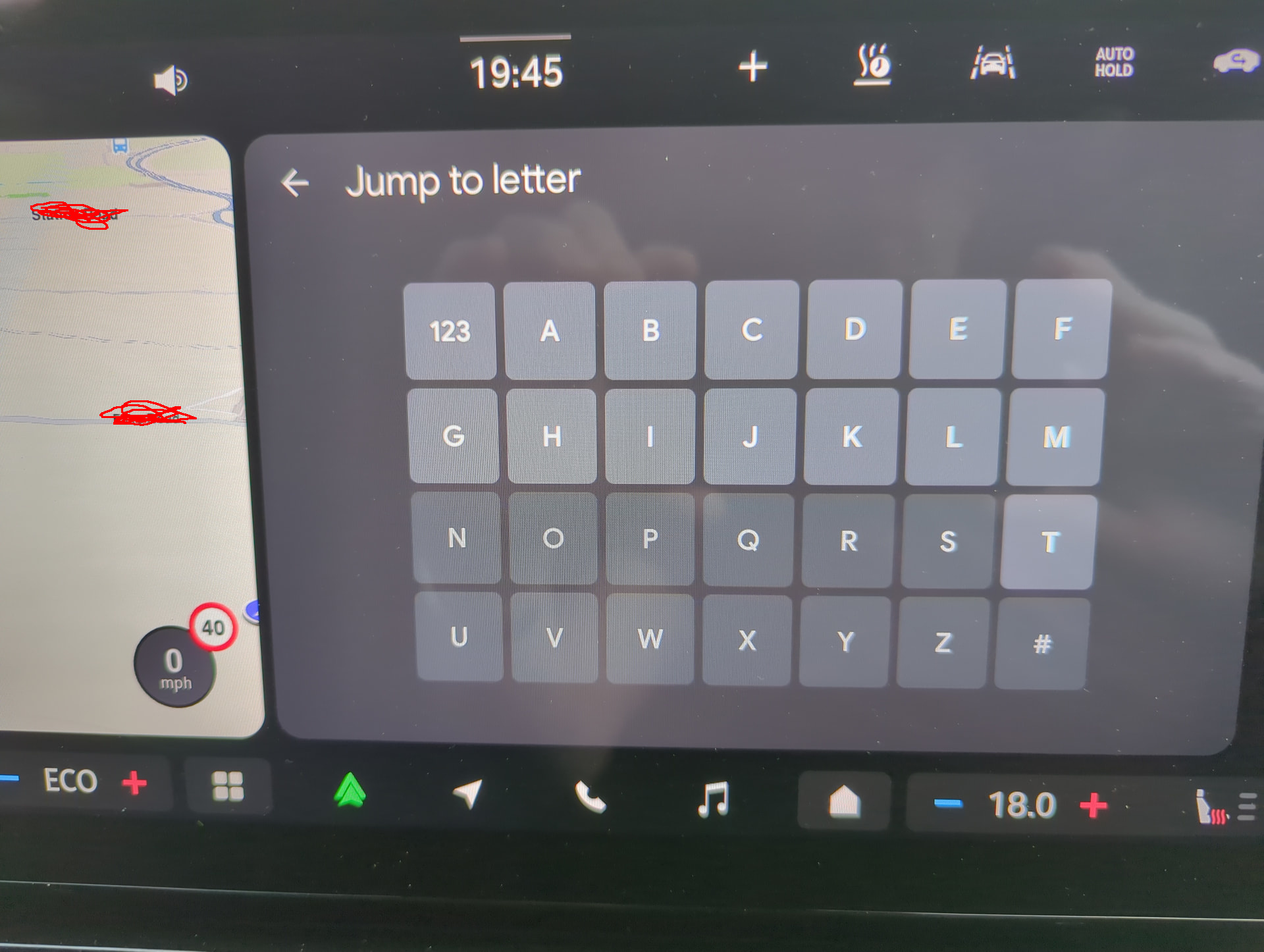

Android Auto (and possibly CarPlay) library search skips letters N to S and U to # (ref#CBYJKX)
· When I go into my library from within android auto and click the letter button to search by letter, I only get a-m and then everything is greyed out until t. Same if I scroll through the artists it skips from M artists to T. Seems fine on my phone and I even cleared data and re-synced library with same results.

This occurs with the A-Z feature, not only scrolling. Since a letter is already displayed this makes no sense because the action is to avoid scrolling and jump directly to a specific letter.

As the other person in the thread said, it’s not just the scroll function. It’s the search/jump to letter function. Those letters are greyed out. Other apps like plexamp or symphonium don’t have this issue.

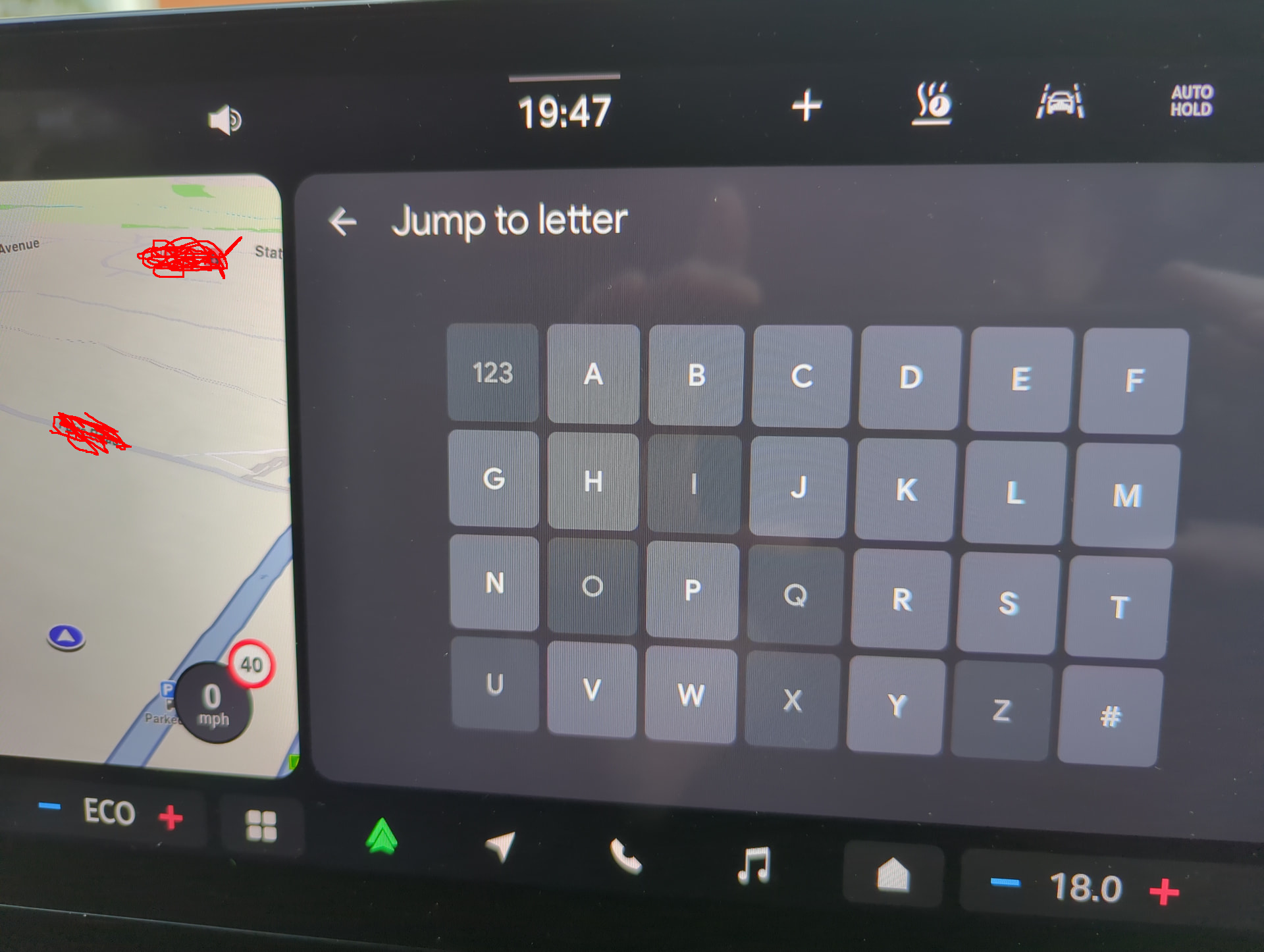

It would seem that ARC is truncating the object list since the jump index is complete in other apps I use, i.e., nugs, Plex, Symphonium.
Using a Pixel 7 with Android 16.
I have a galaxy s25 and a pixel 10a and it does the same thing on both devices. I’ve seen other people on reddit complain about the same issue as well.

Odd thing this morning though, in the car, using ARC through carplay, I select Artists, and select the alphabetical search on the left, tap “P” looking for “Photek” and it’s not there (there’s also a lot of missing artists apparent in the list that I know are in my library). go to Albums, again use the alphabetical search, and tap"N" and there’s Natural Born Killa EP, attributed to Photek…
What gives? Why are these lists so incomplete?
