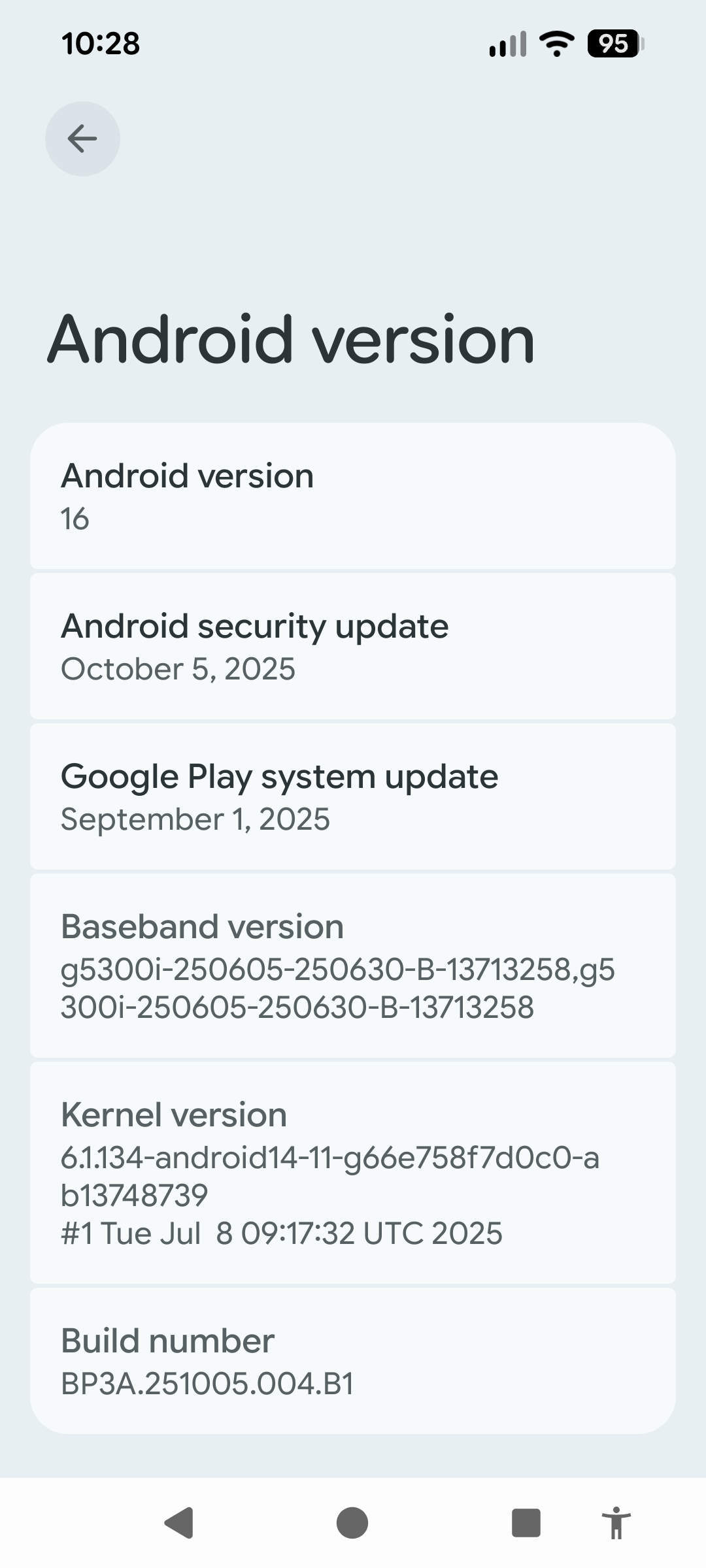

I only have the one Android device.
I’ve attached a screenshot showing Android version and Build info.
I am new to Roon so have only seen the connection problems on Android 16.

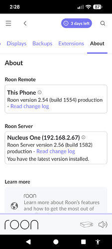

Based on what I’m seeing in the Settings - About area on the Android app, v.1554 is the latest I have access to.
I will try the APK version later and let you know how that went.
