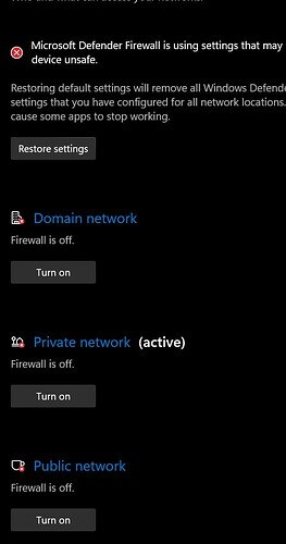

Yeah sure, that makes sens. Turned off firewall for public, private, domain and still remote doesn’t work :frowning:

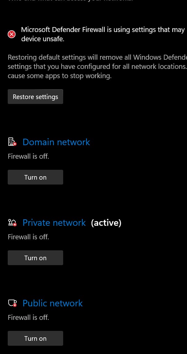

So i’ve unistalled Roon and re installed. Also I’ve restored to the RAATServer_old as it was known to work just a day ago. Also I’ve disabled firewall again.
Still getting “Waiting for your Roon Server” on the Core app, in windows
