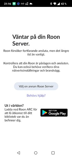

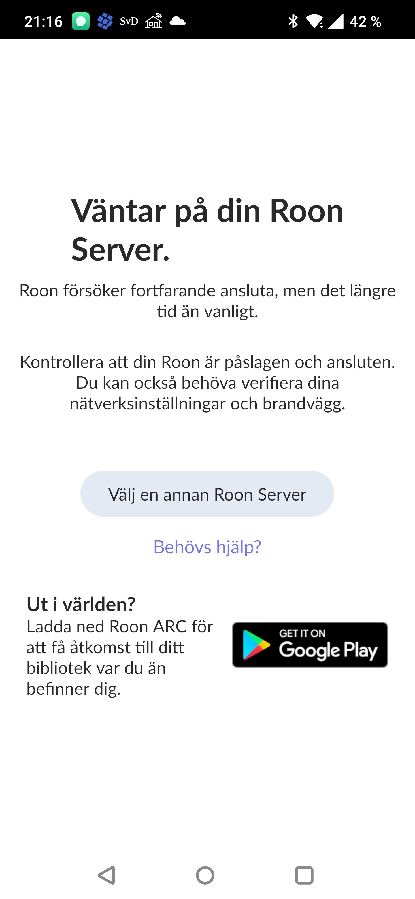

Is Roon Server running?
· "Waiting for your Roon Server"
What happens if you press the "Select a different Roon Server" button?
· I don't see Roon Server.
· *Roon Optimized Core Kit* (ROCK)
My Android Roon app does not connect most of the time. Windows Roon client app connects OK.
