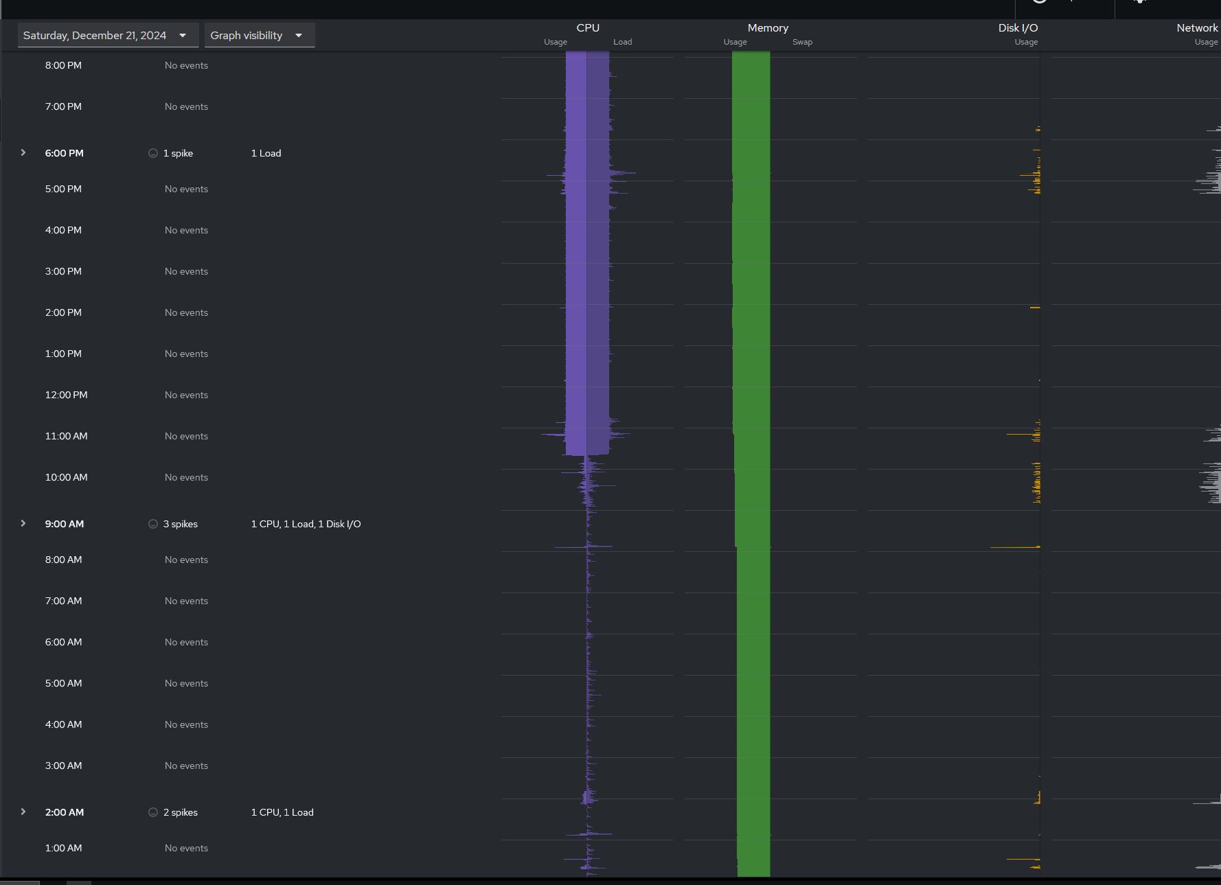

Thank you! I don’t know if this is relevant, but CPU and Memory usage seem weird on the Roon core system (Ubuntu on mac mini hardware). On Dec 21st, after about 36 days of uptime, CPU shot up to around 100% or higher and stayed there until I rebooted today. Memory usage had been creeping up steadily over time to about 5GB used out of 8GB total today. I just rebooted the machine and CPU and memory are both lower. Are there issues with memory leakage?
These are screenshots from cockpit, showing the moment when CPU jumped to above 100% on 12/21 and a screenshot corresponding to when I rebooted and CPU went back down to normal values (today).

Thanks for the additional data point. We got the logs for the timestamp you shared with us and added to the ticket we have with the Development team. They are currently looking into this. While I cannot give you a specific timeline I want to assure that this case has not been forgotten. We greatly appreciate the patience you’ve shown while we work through this issue!
