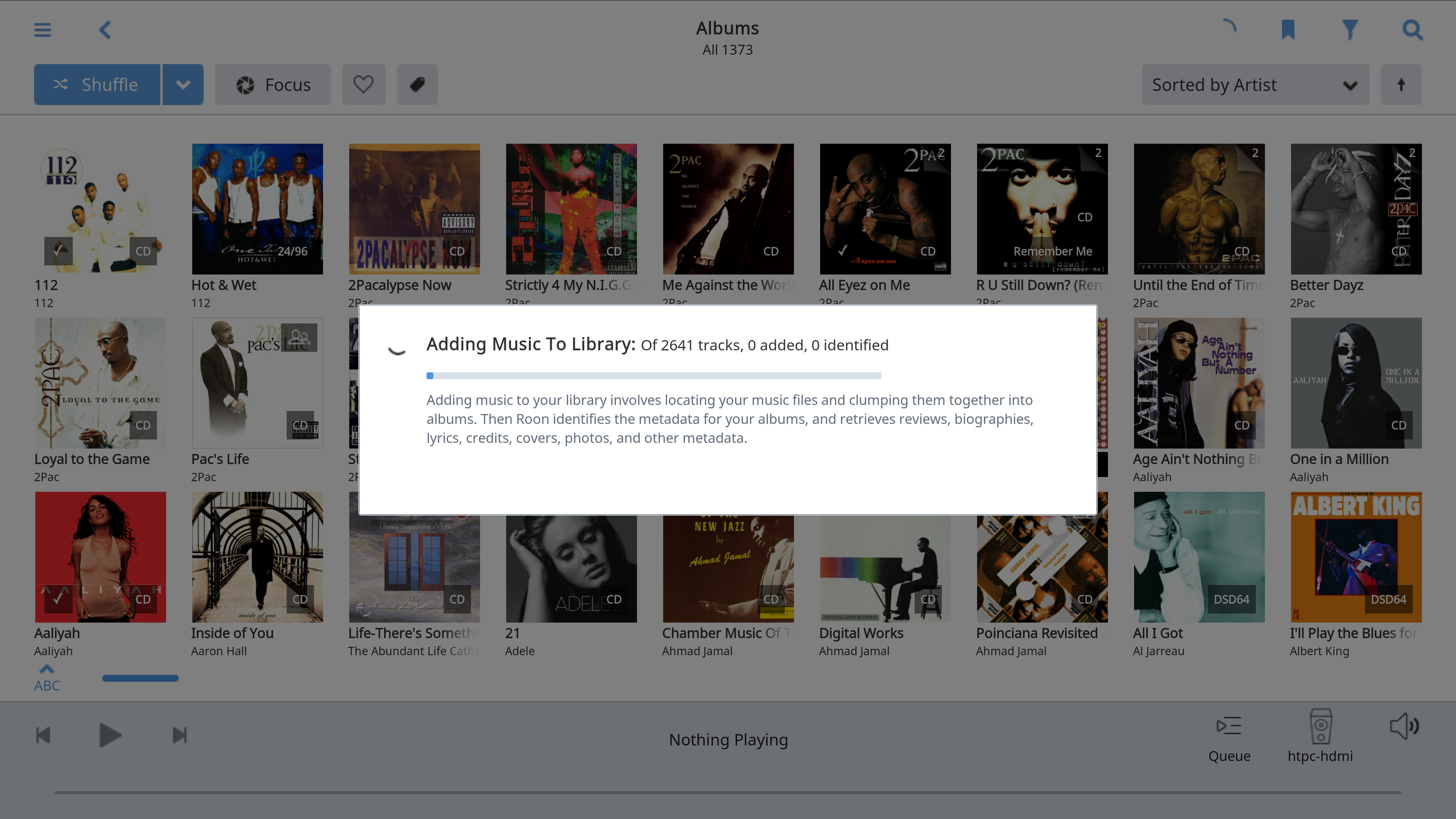

Another stuck on adding music to database
Custom server running freenas 11.2 128gb memory, 48tb hard raidz2 (8x6tb) 2 intel e5 2650v2. Roonerver 1.6 build 416 installed on ubuntu running on a vm.
Gigabit network with NETGEAR PROSAFE JGS524.
using multiple custom built pcs running windows server 2019, and windows 10 running roon bridge
adding music stalls and blue circle keeps spinning
I know many have had issues like this and I have done and extensive searches on the support forum. It seems many have had the same issue for different reasons. I’ve been trying to troubleshoot this on my own for months and I’m finally ready to give up on solving this myself. This started after upgrading to 1.6 many months ago. At that time I had roonserver running flawlessly for installed in a docker container running on rancher installed in a vm on freenas. So these are the things I have tried.
I installed roonserver on two different windows computers pointing them to the same storage location on my nas.
After that I put together a small fanless server and installed rock onto that.(same result).
After that I started moving my music folders over to another folder about 10 at a time since I have over a terabyte of music and even down to the last few folders it was still doing the same thing.
The last thing I’ve tried was to completely destroy my database and start over, and even that didn’t work.
All of this was done months ago. Since then I created new shares, fiddled with permissions countless of times and yet nothing has fixed this. Currently I have the latest build running on ubuntu installed on a vm inside freenas 11.2.

Starting out, can you share a screenshot of Settings > Storage as well as a screenshot of the import screen when you click on the blue spinner?
Yes.
Just to add, it’s the same whether I use my storage as a network folder or when I had roonserver installed directly on my windows 10 computer and had the nas mounted in windows 10 added as local storage to roonserver. It’s also the same having rock installed on a dedicated computer. In the past, I’ve had roonserver installed inside of a docker container and used rock server with the same nas drive and it ran flawlessly before the update to 1.6.

So I remembered that I had plug in external enclosure. So that made it easy to copy my music folder over after plugging in the drive. So I installed roonserver on another machine with the drive connected locally and the same thing is still happening. No matter the drive or where I install roonserver, the adding music is stuck on 2641 with 0 added. This is out of over 17000 tracks. So around 15000 are added and it freezes at 2641.

Hi @orlando1,
Apologies for the delay here. I requested an update from the team and confirmed that they were able to analyze the diagnostics report.
In the report, they found some problems with files in a certain path in your storage location. Moving the files in the following directory out of your watched folder and see if there is any change here?
E:\Music\Sonny Stitt\Sits in with the Oscar Peterson Trio (1959) (Bonus Track Version)
That was it!! Thank you so much for you assistance in this. I really appreciate it!
