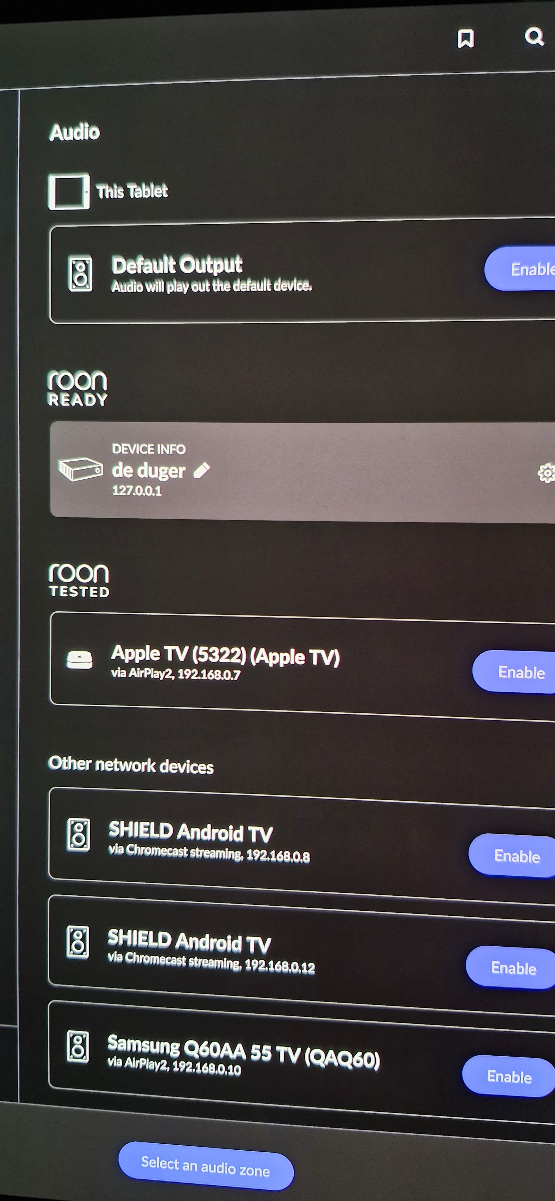

Hi.I have some strange problem,i'm using a antipodes Dx3 roon finding it but in a bridged mode with a D2 how can that be?Can't play anything because i'm getting ip 127.0.0.1so i guess that's why i don't get any sound.How can i delete the bridged mode?I did a reset of everything in my chain but still the same.Really need to sort this out!!!Kindly/Ingemar
Sagem c2 "modem/router"to an asus extender and finally ether regen to my antipodes
Sorry i forgot to mention the nuc 9 pro with the roon server and a lampizator GG .

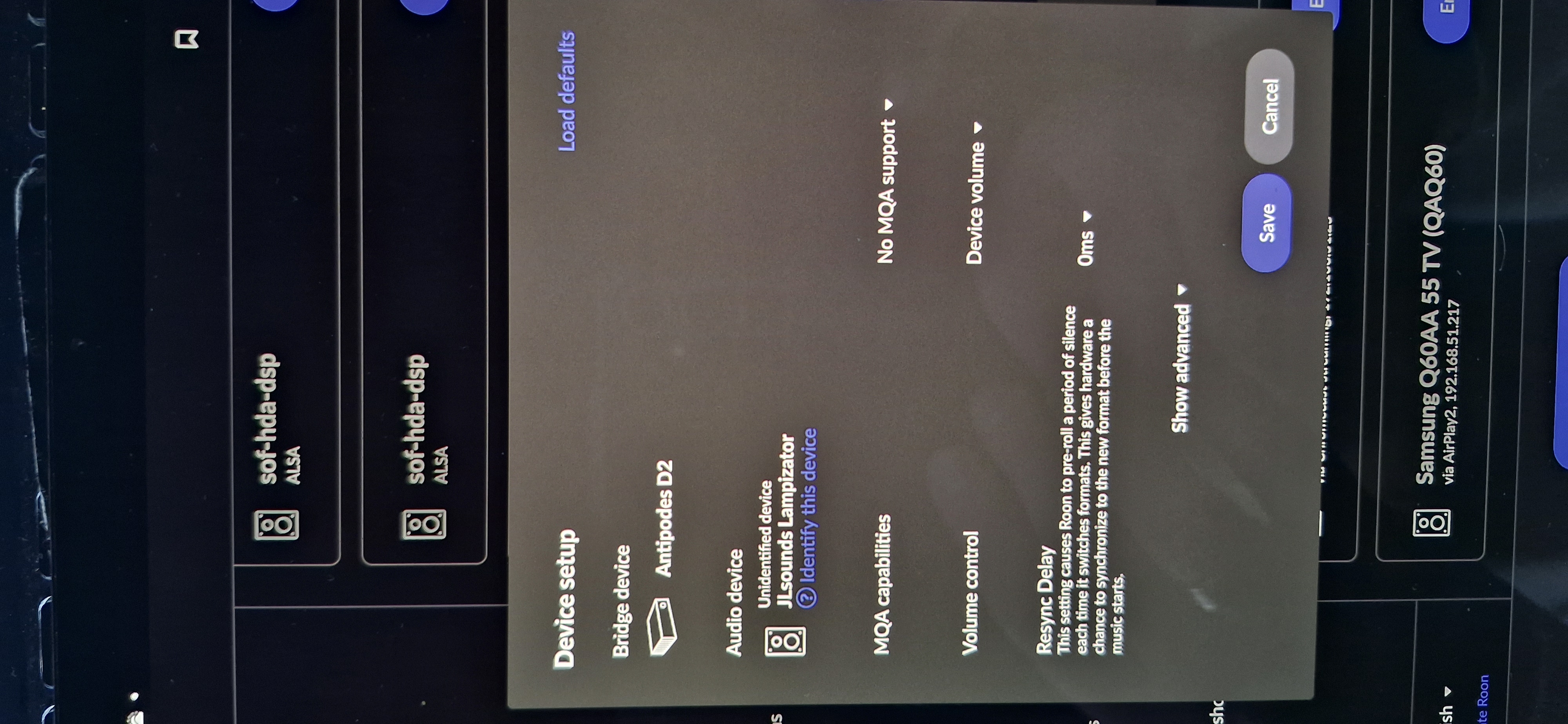

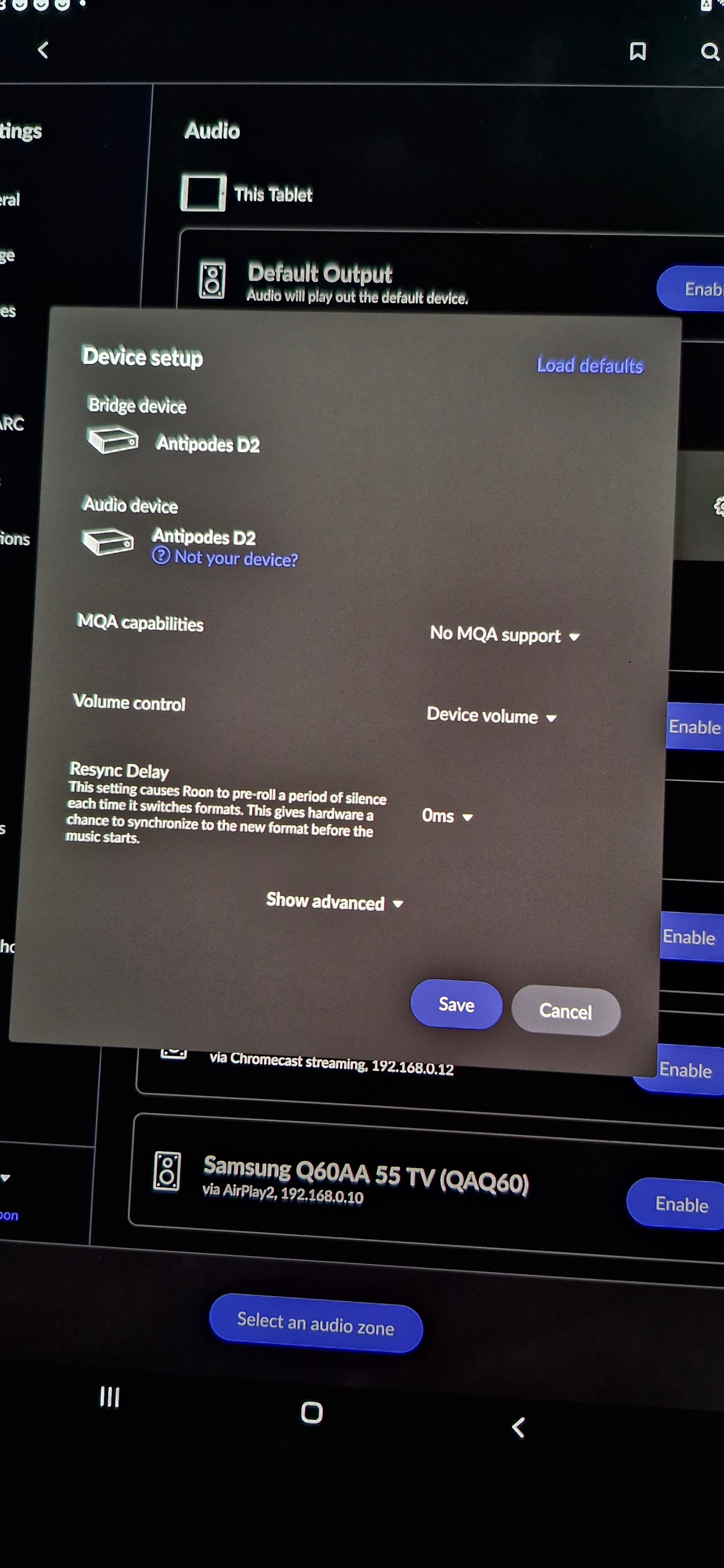

I am looking over your account diagnostics and it looks like you have two Roon Servers associated with your account, both with D2s. Do you have the option to enable the D2 via Roon Ready mode? You can confirm the server that you are connected to via Roon Settings → General.

Yes the D2 is roon ready,but when i’m connecting with d2 then i get the bridged mode with the dx.
Now i have simplified everything.Cables straight from the asus Rt ax58u-44f8 to the ether regen to the antipodes d2 with the same result,sorry to say :frowning:

I just have the D2 connectded nothing else,thats qhy i’m confused.

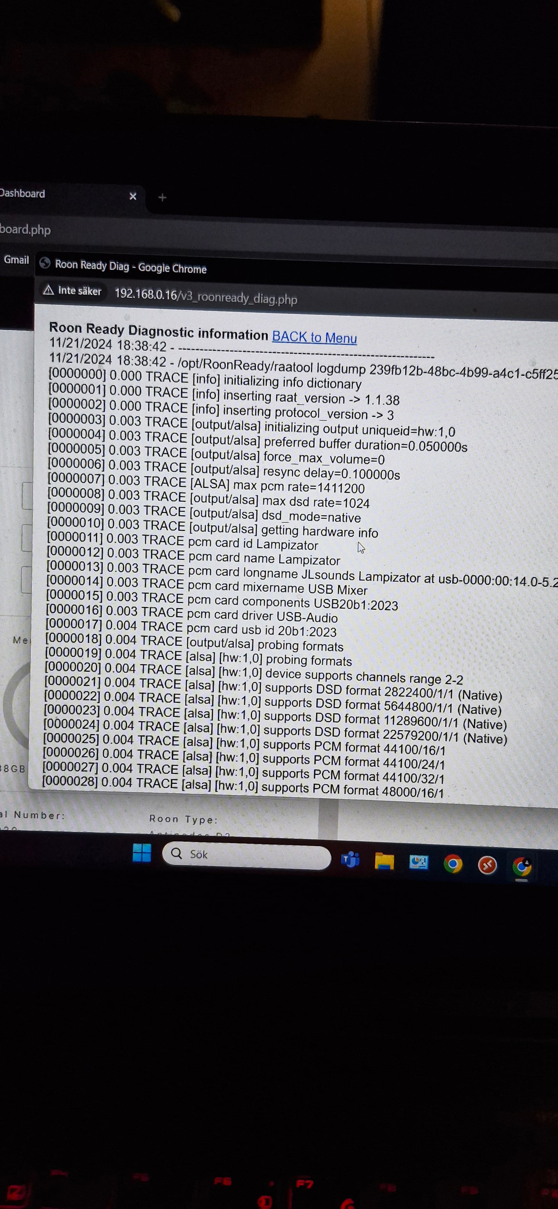

Diagnostics from your Linux RoonServer instance show socket exceptions with nearly all background services. RoonServer doesn’t have a reliable connection to the internet on this machine.

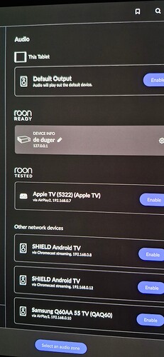

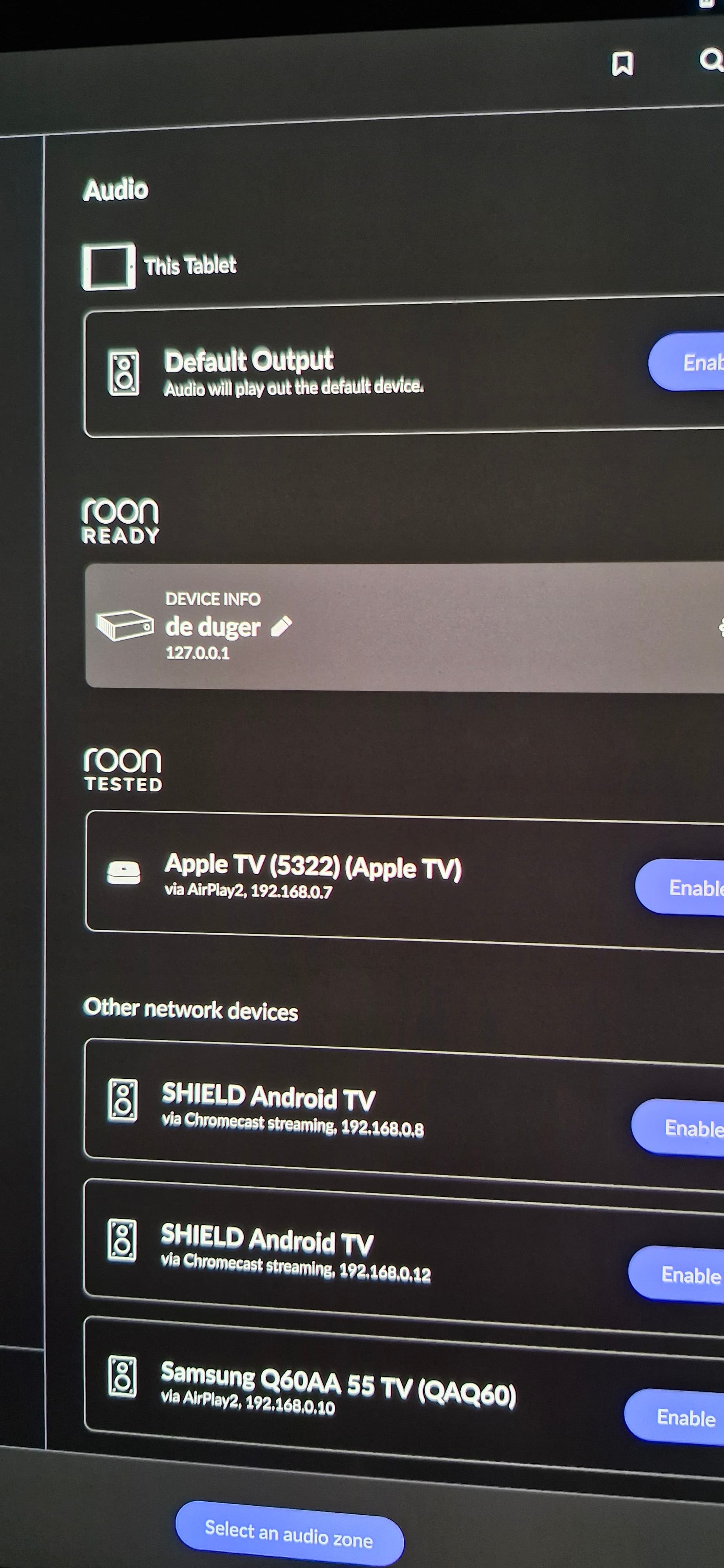

More than one local networked Zone is attempted to connect via the loopback interface. This is a network interface issue on the NAS itself - you’ll need to check any custom DNS settings you’ve configured on this NAS. Check the service configuration files and make sure any bind-address or similar options match the LAN IP address, not the loopback.

I have a simple system that starts with a Modem/router to a asus router in access mode to a ether regen switch in to an Antipodes dx 3,from the antipodes to an lampizator dac with usb connection.Thats it.Been trying everything i can think of but still this 127.0.0.1 No vpn and security that i know of.And what is this,that my antipode is in bridge mode i only have one device.Roon have been working with more complicated systems without any problems before,so why when i have simplified everything,hmm
Hope you can guide me to solve this.
Kindly/Ingemar
