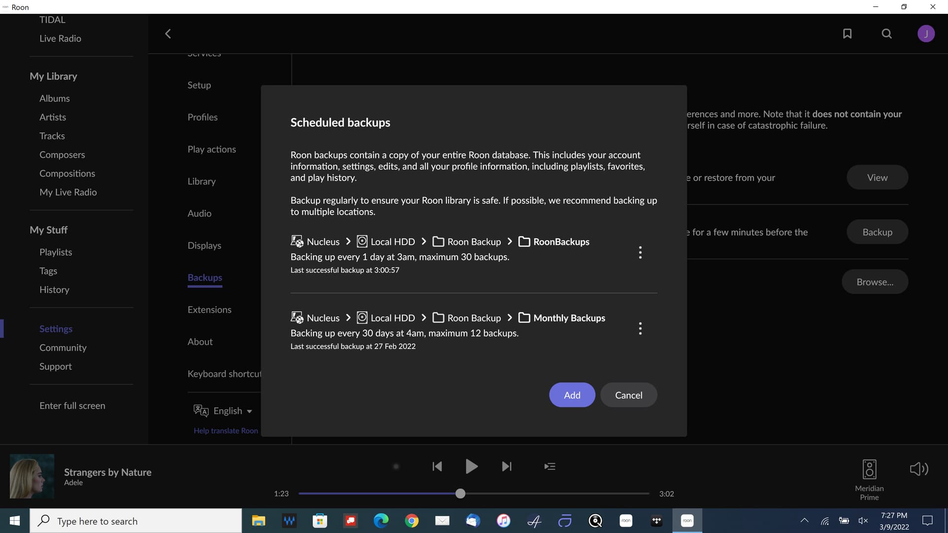

I’m not familiar with the Antipodes music server. Does it have a USB port that will allow you to plug your backup drive directly into it? That would be best if so. Go into the Roon Settings - Backups and set up automated backups to that drive. I have mine backup every night and save 30. I also have it backup once a month and keep 12. I think backup’s are a little over 1 GB each, but not certain on that.

If I understand correctly, whatever USB HD I attach to the USB port on the Antipodes should show up as a “separate” drive, i.e. district & different than the two user replaceable SSD HD’s I use in the Antipodes?
Yes. Here’s what mine looks like with a USB HDD plugged into my Roon Nucleus…
