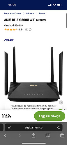

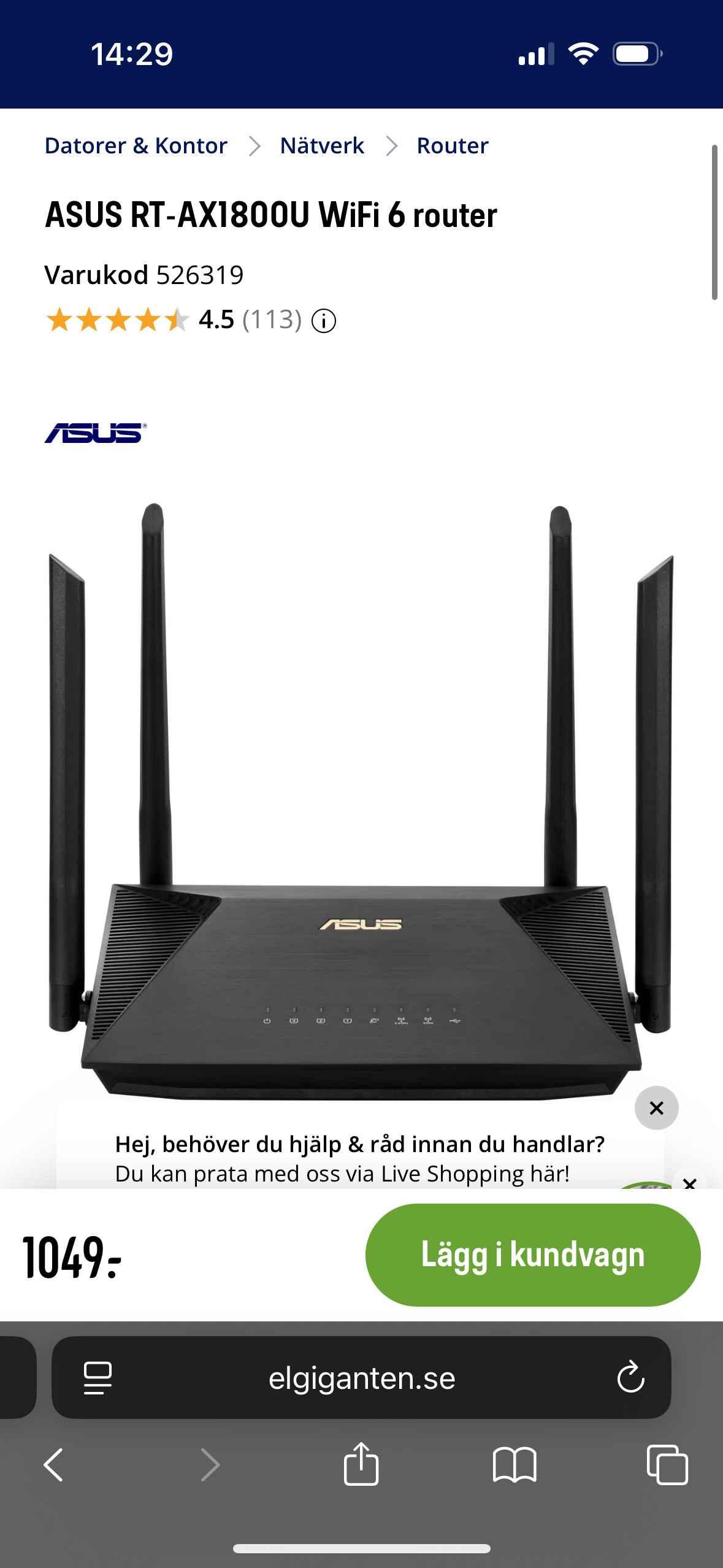

The router is as shown below and the fiber is 1000/1000
Hello @Robert_Lidstrom,
Thank you for the update.
Based on the router description, it doesn’t appear to have a direct fiber input, so there should be an additional device in front of it. Could you please confirm whether it’s a standard media converter or a smart device that might have its own DHCP, port forwarding, or other network-related functions?
This information will help us better understand the network setup and assist you more effectively.

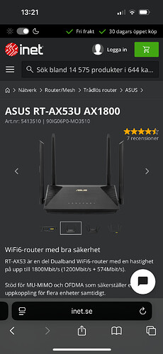

Actually this is the router being used. Not sure there is a difference?
It is connected to a fiber socket and to the computer. No devices in between.
Thank you for the update. Based on the photo and description on the Asus page, the following router does not have a Fiber socket, only Ethernet ports.
A misunderstanding on my behalf.
We use a Ethernet cable to the fiber socket in the wall and also between the router and the computer.
I didn’t know about the fiber sockets in a router.
