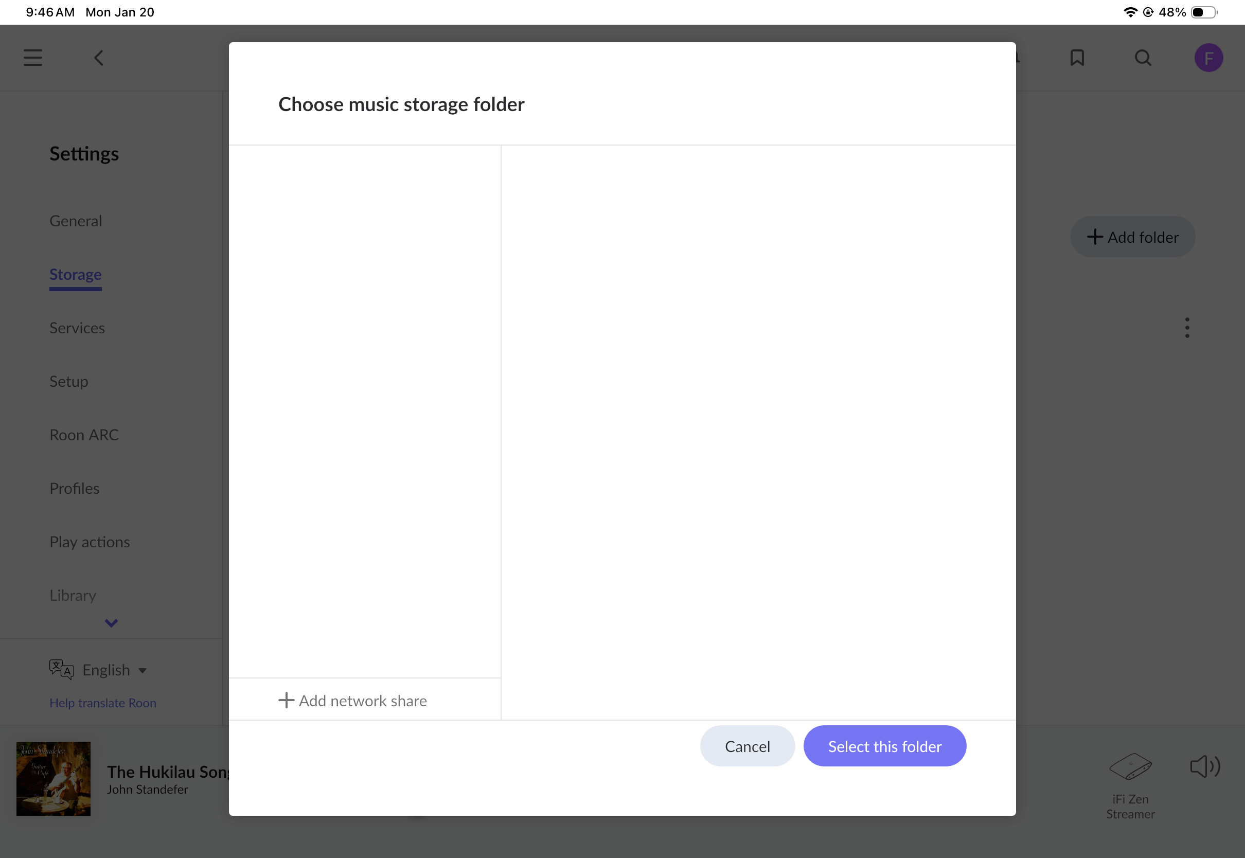

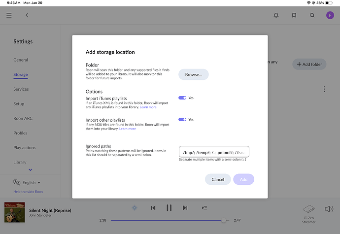

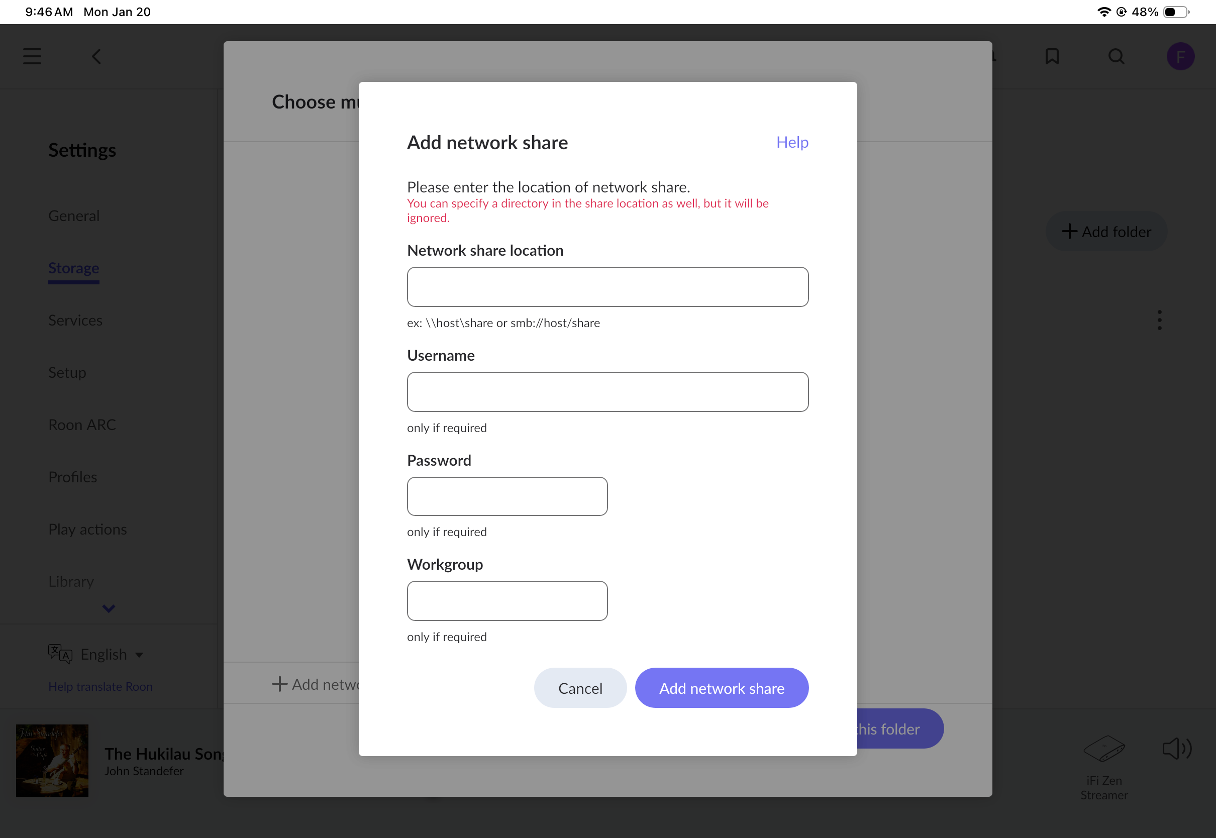

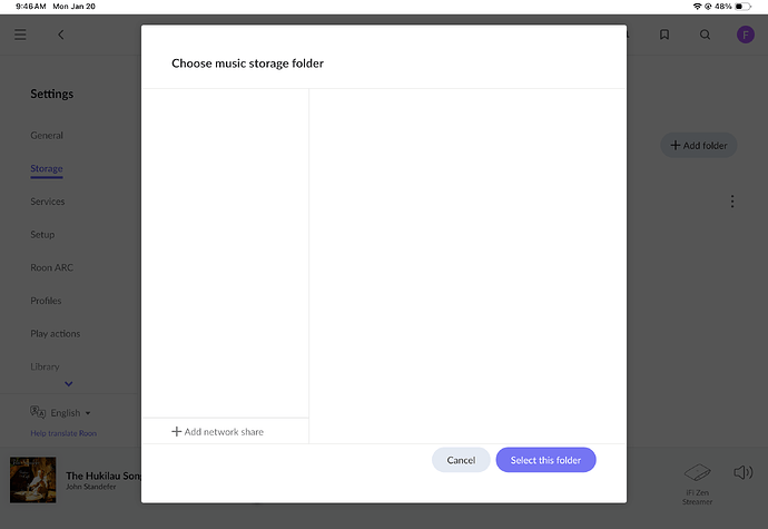

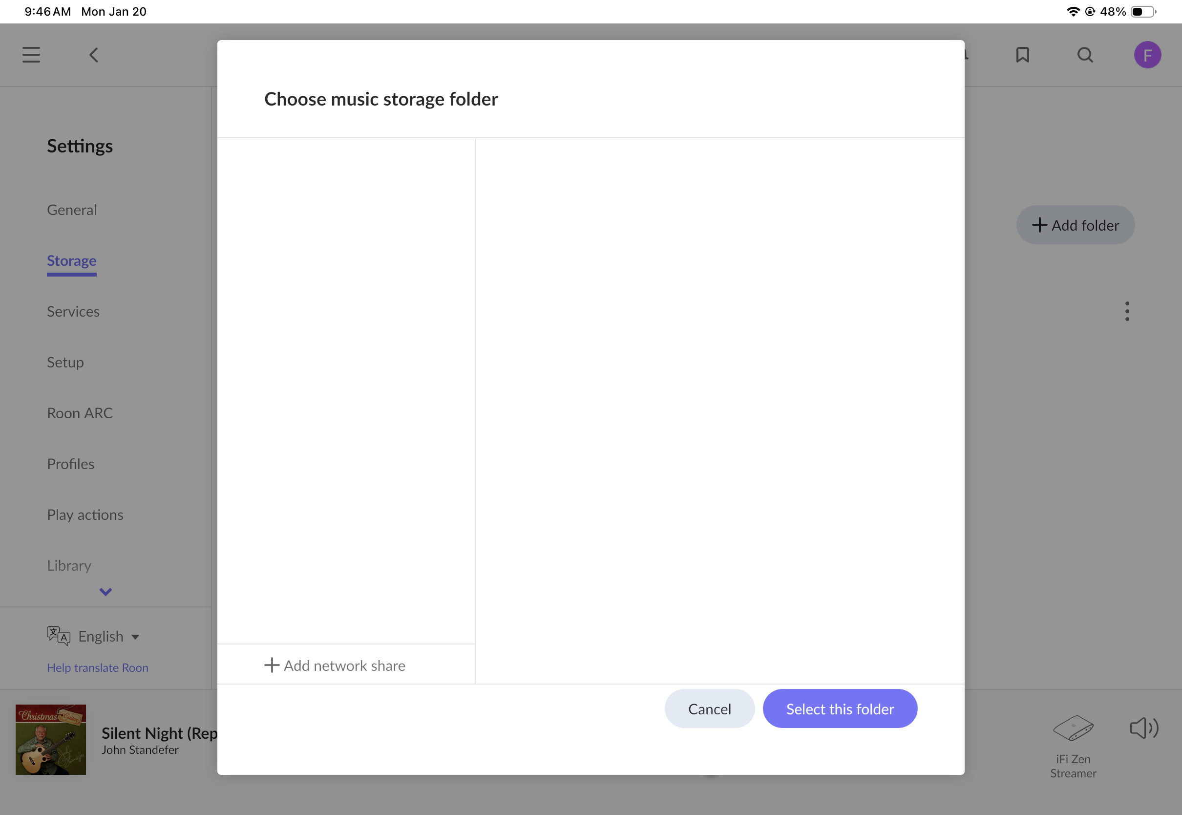

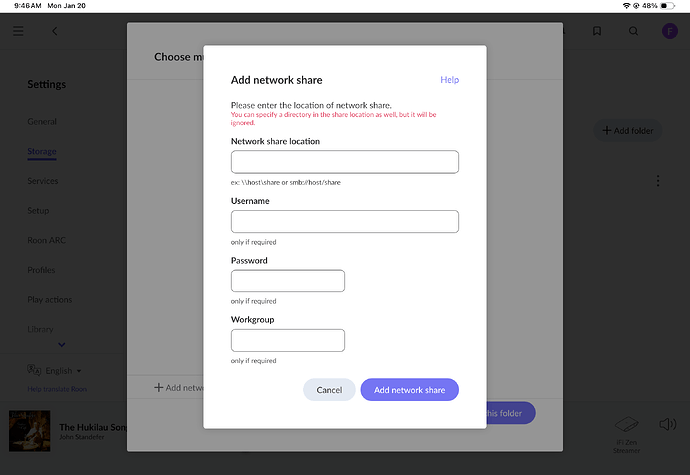

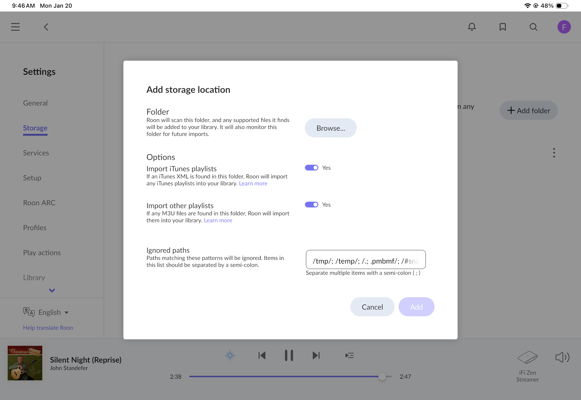

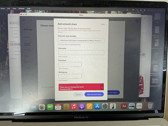

I am having difficulty adding the ripped tracks from my Apple Music Library into the internal SSD installed inside my new Nucleus One. The SSD has been formatted. The Apple Music Library is on a M1 iMac connected via Ethernet on the same network. Below are several screenshots in terms of what I have tried so far.

I think that you’re going back to front in the process. You seem to be trying to add the music library on your Mac as a Watched Folder on your Nucleus, whereas you should be using your Mac’s Finder to access the internal SSD used for music storage.
See the section on using an SMB Connection here:

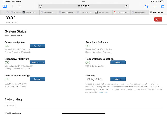

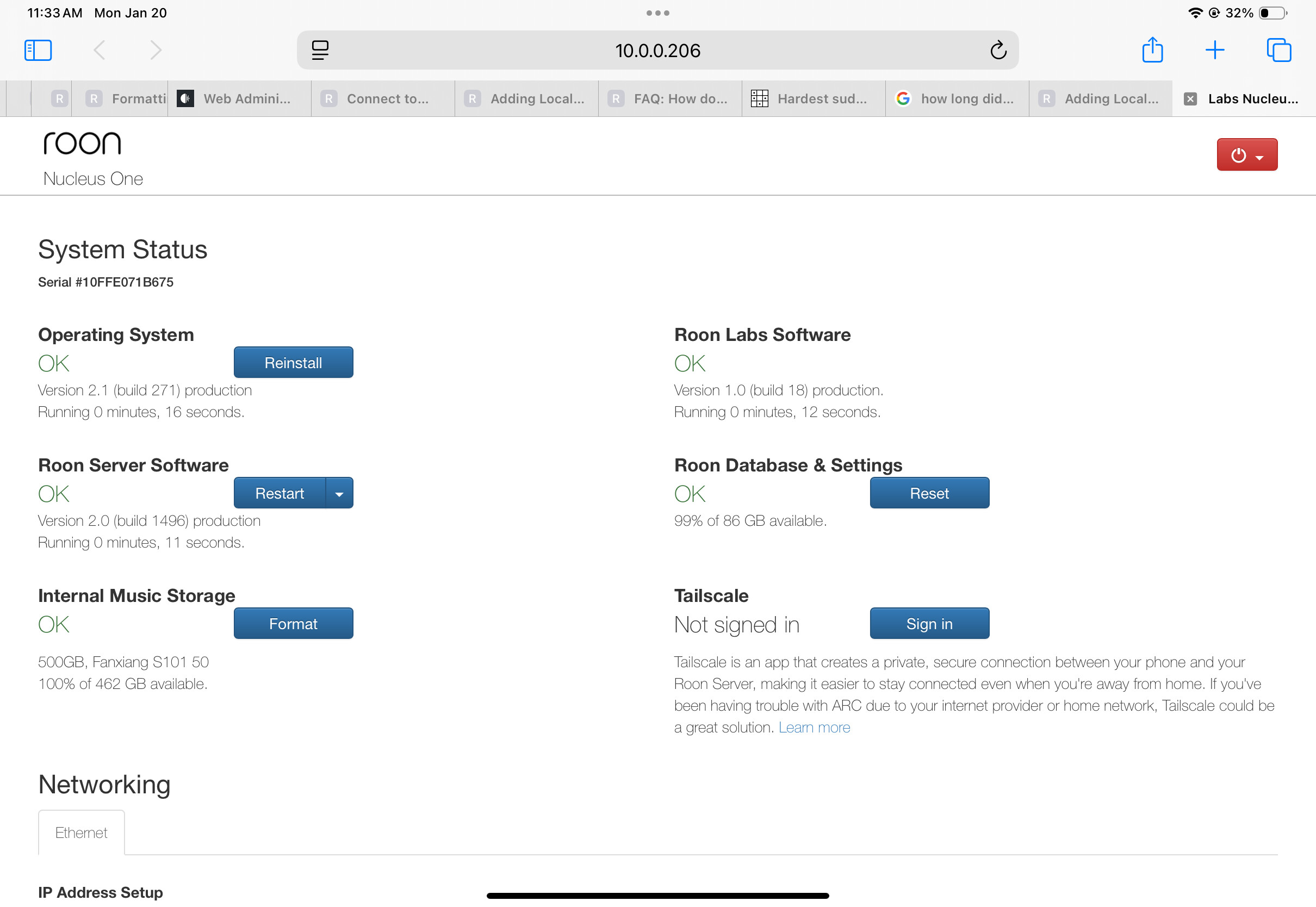

From the screenshot of the Web Administration Interface you posted it appears as though the internal SSD for storage has been formatted and available. Can you confirm this by posting a screenshot of Roon’s :gear:> Storage screen? It should have an entry for the Nucleus One’s Internal Storage showing…

Thanks for writing in and sharing your report! On top of what @Geoff_Coupe has mentioned above, I’m curious if you’ve also included your mac login credentials when attempting to connect your network share? It’s difficult to tell based on your screenshot.
