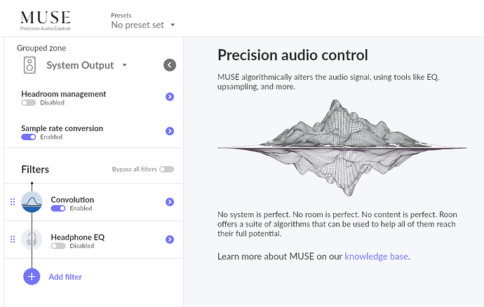

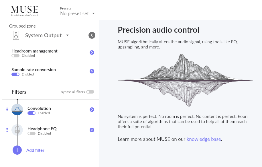

When I click on the ‘System Output’ icon, down the bottom right corner of the main Roon screen, I get a 4-choice option. When I select ‘MUSE’ - I get a completely different screen to yours:

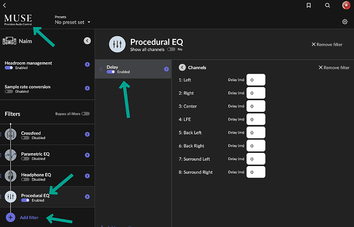

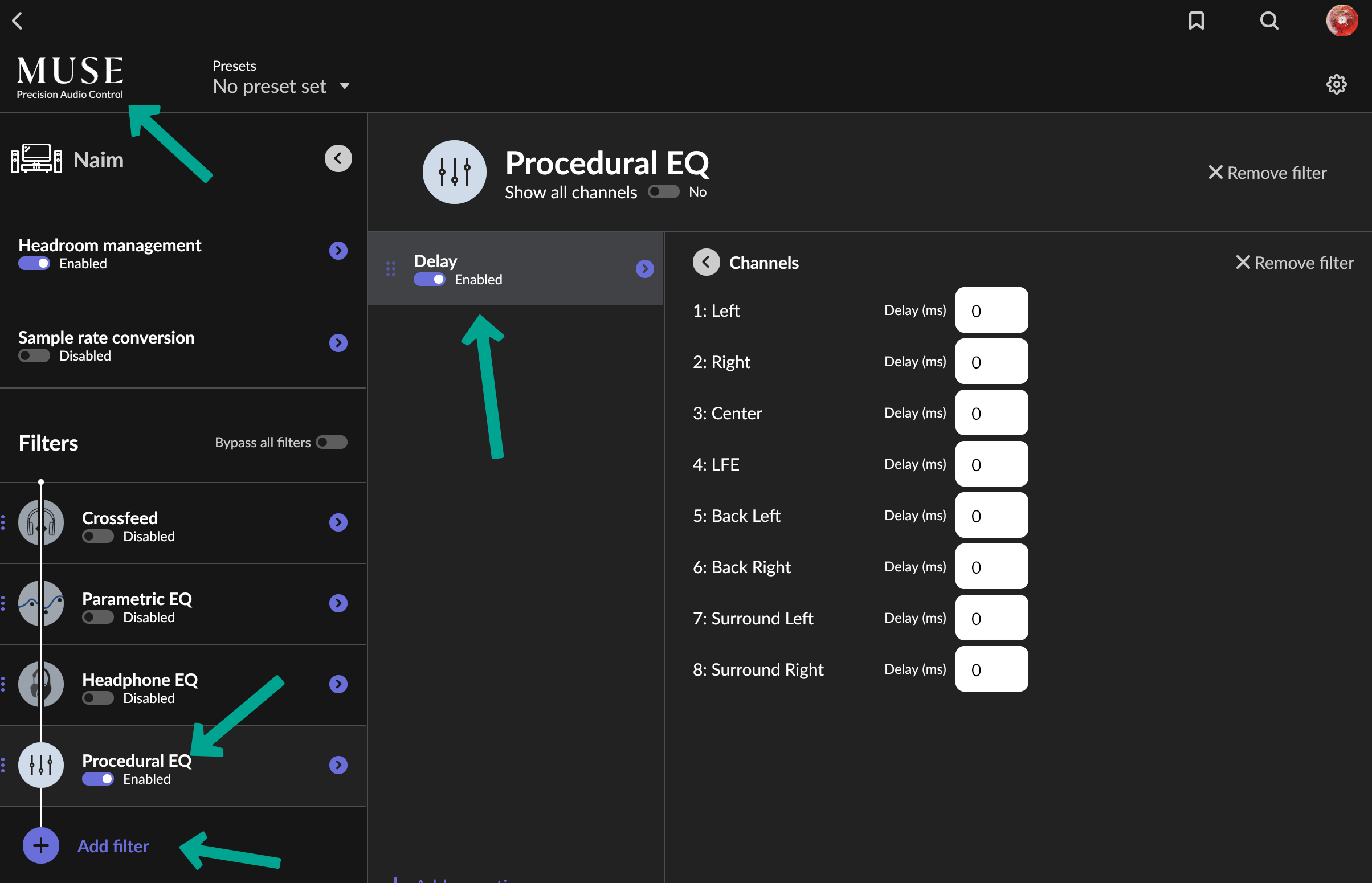

You need to click the Add Filter button, bottom left

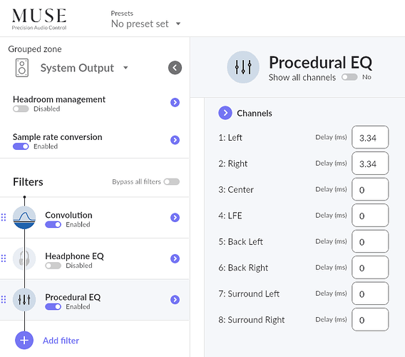

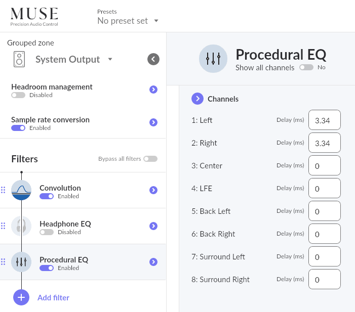

All done!
Not sure that I can actually hear any difference … but at least I know the mains are now time-aligned with the subs!
