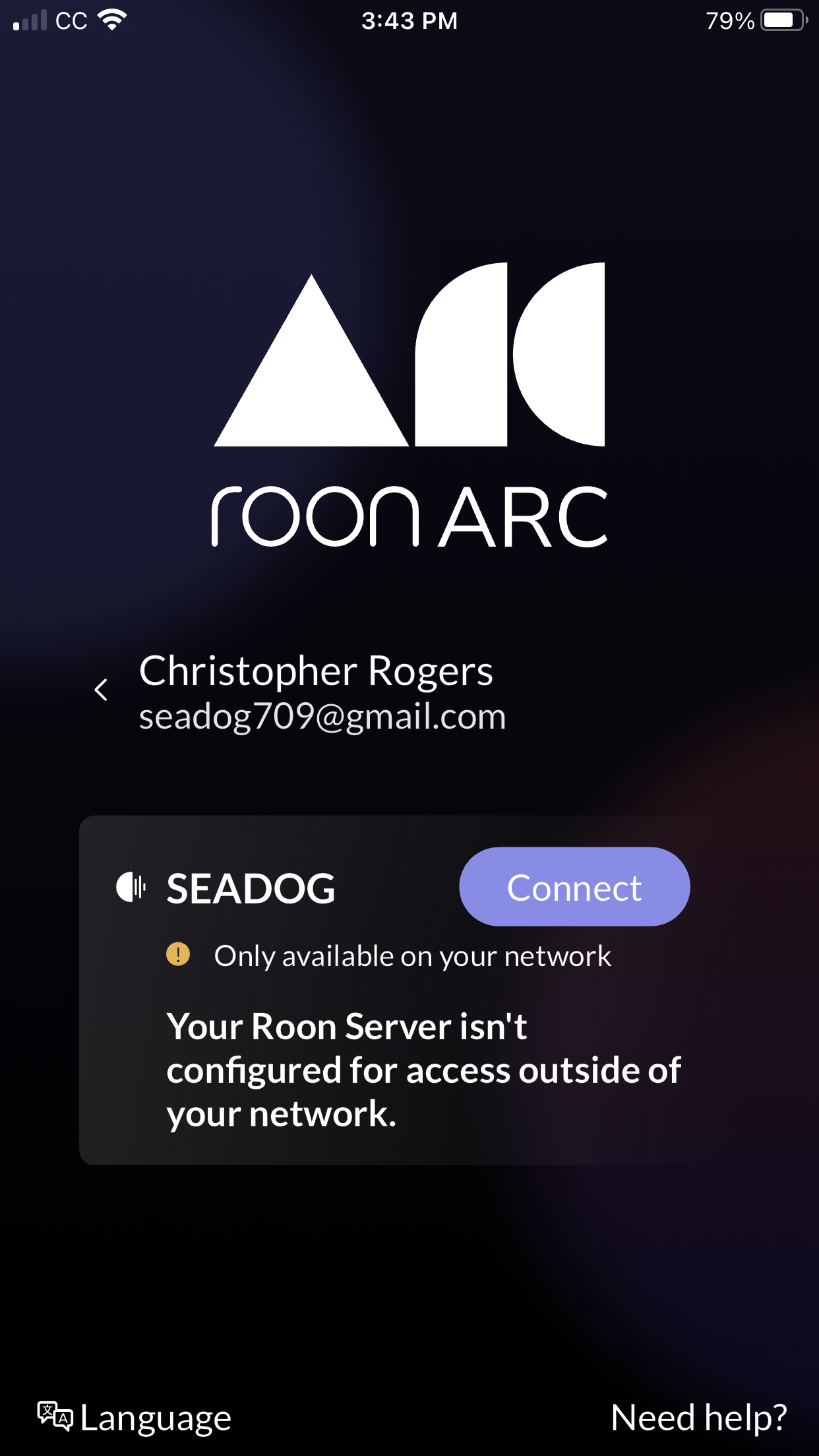

· I can't log into ARC but I can log into Roon
ARC message is “Your ROON server isn’t configured for access outside your network”
I have gone into the Spectrum router and activated the UpnP (sp?) protocol. I rebooted both modem & router.
ACR “sees” the router and identifies it by name.
Spectrum Router SAX1V1K
